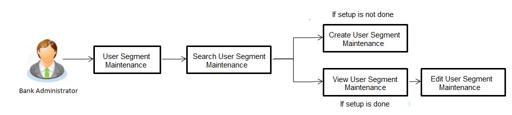

Workflow
Features Supported In Application

User Segment Maintenance - Create
Using this option, System Administrator can create new user segment for a user type ‘Retail’.
To create the user segment:
- In the User Segment Maintenance screen, click . The User Segment Maintenance - Create screen appears.
