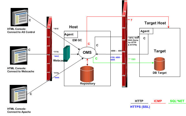

Figure 20–1 provides a topology of an Enterprise Manager grid environment that is using a firewall, and also illustrates the default ports that can be used.
Figure 20-1 Firewall Port Requirements (Default)
The conventions used in the preceding illustration are as follows:
Table 20-1 Conventions Used
| Convention | Description |
C |
Is the entity that is making the call. |
Enterprise Manager will default to the first available port within an Enterprise Manager set range. |
Enterprise Manager will default to the first available port. |
Are the Database listener ports. |

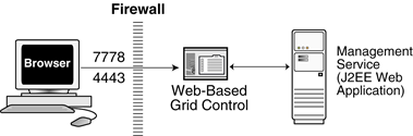

Connections from your browser to the Oracle Enterprise Manager 10g Grid Control Console are performed over the default port used for your Oracle HTTP Server.
For example, the default, non-secure port for the Oracle HTTP Server is usually port 7778. If you are accessing the Grid Control Console using the following URL and port, then you must configure the firewall to allow the Grid Control Console to receive HTTP traffic over port 7778:
http://mgmthost.acme.com:7778/em
On the other hand, if you have enabled security for your Oracle HTTP Server, you are likely using the default secure port for the server, which is usually port 4443. If you are accessing the Grid Control Console using the following URL and port, then you must configure the firewall to allow the Grid Control Console to receive HTTP traffic over port 4443:
https://mgmthost.acme.com:4443/em
Figure 20-2 shows the typical configuration of a firewall between your browser and the Grid Control Console Web-based console that is rendered by the Management Service.
Figure 20-2 Firewall Between Your Browser and the Grid Control Console

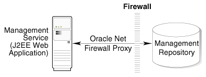

Secure connections between the Management Service and the Management Repository are performed using features of Oracle Advanced Security. As a result, if the Management Service and the Management Repository are separated by a firewall, you must configure the firewall to allow Oracle Net firewall proxy access.
See Also: "Configuring Secure Sockets Layer Authentication" in the Oracle Database Advanced Security Administrator's Guide |
Figure 20-8 shows a typical configuration of a firewall between the Management Service and the Management Repository.
Figure 20-8 Firewall Between the Management Service and the Management Repository

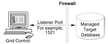

When you are using the Grid Control Console to manage a database, you must log in to the database from the Grid Control Console in order to perform certain monitoring and administration tasks. If you are logging in to a database on the other side of a firewall, you will need to configure the firewall to allow Oracle Net firewall proxy access.
Specifically, to perform any administrative activities on the managed database, you must be sure that the firewall is configured to allow the Oracle Management Service to communicate with the database through the Oracle Listener port.
You can obtain the Listener port by reviewing the Listener home page in the Grid Control Console.
Figure 20-9 shows a typical configuration of a firewall between the Management Service and the Management Repository.
Figure 20-9 Firewall Between the Grid Control and a Managed Database Target
Figure 20-10 Firewall Between Grid Control and Managed Database Target
