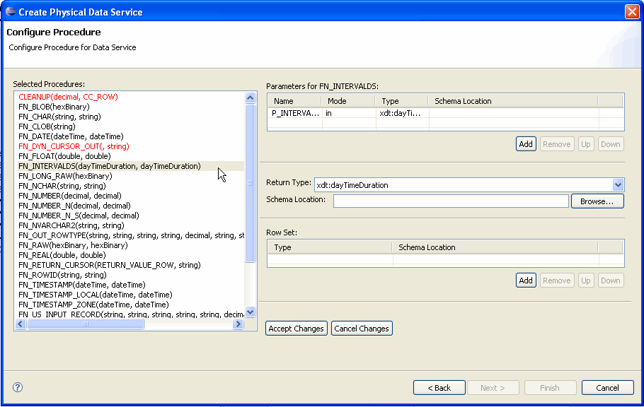

When ALDSP introspects a stored procedure, the process may not be complete. For example, a required item of information such as a schema file or type cannot be determined. When such introspection problems occur, the stored procedure in question is highlighted in red. This setting means that additional information about the procedure must be provided by the user before the data service can be created.
Your goal in correcting an "<unknown>" condition associated with a stored procedure is to bring the metadata obtained by the import wizard into conformance with the actual metadata of the stored procedure. In some cases this will be by correcting the location of the return type. In others you will need to adjust the type associated with an element of the procedure or add elements that were not found during the initial introspection of the stored procedure.
When several stored procedures are selected at the same time for physical data service creation, all the selected procedures must be adequately configured before any data services based on the procedures can be created.
![]() | An alternative to configuring a incomplete stored procedure before proceeding is to use the wizard Back button to de-select the procedure in question. |
Here are the steps involved in editing a set of stored procedures that will be imported as data services:
![]() | If a stored procedure has only one return value and the value is either simple type or a RowSet which is mapping to an existing schema, no schema file is created. This stored procedure by definition become a library data service. |
Stored procedure configuration can be complicated. An understanding of the characteristics of the stored procedure in your database is an essential prerequisite. This section describes stored procedure options in detail.
Once in stored procedure configuration edit mode, options are available in three general areas:
