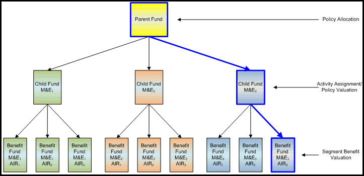

Certain events are expected when starting a Payout Annuity/Annuitization. Best Practices recommend that the following occur. The final calculation of the benefit split records is triggered by an activity so that Price Correction logic can initiate an activity that will cause the calculated benefit to be recalculated using the corrected price. Calculate General will not be used after the final benefit split is calculated so activities using other attached rules will be used to adjust the benefit split records. Fixed funds during the deferral period (may) accumulate interest but once annuitized, interest ceases to accrue. Upon annuitization, all assets in the deferred fixed funds are transferred to the fixed benefit fund. The Annuity Payment activity calculates the amount of the active current benefit split record on the segment. The activity then splits that benefit amount and passes those into a number of disbursement activities depending on the number of benefit recipients.
Fund Movement During Annuitization
