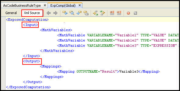

  8. Click the XML Source tab at the top of the Configuration window.
  9. Enter the XML code for the exposed computation. The code can have the following sections.
    • Input: This section contains the math variables that will calculate the specific information being requested. This is a required element.
<Input>
<MathVariables>
<MathVariable VARIABLENAME="Variable1" TYPE="VALUE" DATATYPE="TEXT">TestValue</MathVariable>
</MathVariables>
</Input>
    • Output: This section contains the mapping information that tells how the requested data should be returned. This is a required element. The data returned in the response XML is built from the <Output> mappings configured in the exposed computation rule. The root element from the response is the ComputationID from the initial request. Each child element of the root is the Mapping from the output configuration with its math value as the element text. A sample Output section is shown below along with the resulting response.
<Output>
<Mappings>
<Mapping OUTPUTNAME="Result1">Variable1</Mapping>
<Mapping OUTPUTNAME="Result2">Variable2</Mapping>
</Mappings>
</Output>

<ExposedComputation>
<Input>
<MathVariables>
</MathVariables>
</Input>
<Output>
<Mappings>
</Mappings>
</Output>
</ExposedComputation>
