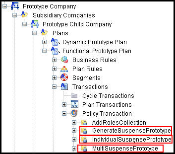

There are three transactions configured to demonstrate this functionality. Navigate in the Main Explorer to Companies | Prototype Company | Subsidiary Companies | Prototype Child Company | Plans | Functional Prototype Plan | Transactions | Policy Transactions.
  • MultiSuspensePrototype transaction: allows users to enter multiple suspense numbers and amounts on the ActivityDetail screen that corresponds to the records, which have been saved on the AsSuspense table. The currency configured in the transaction must match the currency of the suspense record used.
  • IndividualSuspensePrototype transaction: allow users to enter a single suspense number and amount on the ActivityDetail screen that corresponds to a record saved on the AsSuspense table. The user can select the currency associated with the suspense item being used in the transaction. The currency that is selected in the transaction needs to match the currency of the suspense record being used. The MaintainSuspense business rule is attached to demonstrate the ability to update a suspense field during transaction processing.
  • GenerateSuspensePrototype transaction: allow users to create a single suspense record saved to the AsSuspense table. The suspense record that is created is demoninated in the plan default currency.
suspense transactions in Main Explorer
Suspense Transactions in Main Explorer
