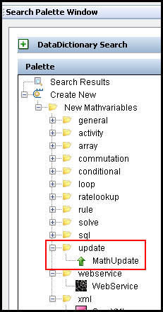

The Math pane of a transaction is used to configure projection processing. The Palette window contains a category named Update. The MathUpdate element can be dragged and dropped into the Math pane. This element is used to hold the math variable (or literal numeric value) that is copied into the specific Table field in memory. The FIELDNAMEattribute holds the name of the Table field to update in memory. The TYPE attribute identifies the source table of the record type to update. SegmentFieldCollection will update the named Segment field records with the collection values. Both of these attributes are required. An optional SEGMENTGUID attibute is required only if TYPE equals SegmentField. It identifies the segment record to update.
MathUpdate option in Palette window
MathUpdate Element in Palette Window
