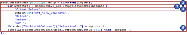

The following figure illustrates the code you use to customize the setup logic of the presentation model. Each number in this figure identifies the corresponding step number in the numbered task list that this book includes immediately after this figure.

Specify the method that the presentation model runs as part of the Setup life cycle:
RecycleBinPModel.prototype.Setup = function(propSet){
In this example, you configure Siebel Open UI to create a control that it displays only in the client, and then insert it into the GetListOfColumns property of the applet. You add this code in the Setup life cycle method of the presentation model because this logic is related to the work that Siebel Open UI does to create the applet. Siebel Open UI must create the applet first, and then insert the control. For more information, see Summary of Presentation Model Methods.
Create a new instance of the AppletControl object:
var mycontrol = SiebelApp.S_App.GetAppletControlInstance
This example requires Siebel Open UI to create a new listOfColumns and to add it to the GetListOfColumns array. You can use the GetAppletControlInstance method to create a new instance of the AppletControl object. For more information, see GetAppletControlInstance Method.
Name the instance:
"Client_Select",
You must specify a unique name for the instance. This example uses Client_Select, which is a unique value that Siebel Open UI can use to determine the operation that it must perform.
Specify the control type:
consts.get("SWE_CTRL_CHECKBOX"), "Select", "Select", "50"); this.Get("GetListOfColumns")["SelectionBox"] = mycontrol; SiebelAppFacade.RecycleBinPModel.superclass.Setup.call(this, propSet); };
where:
specifies the control as a check box. -
Select
specifies the display name. You can specify any display name. -
50
specifies the width of the column.
For more information about control types, see Applet Control Class.
Save the recyclebinpmodel.js file.
