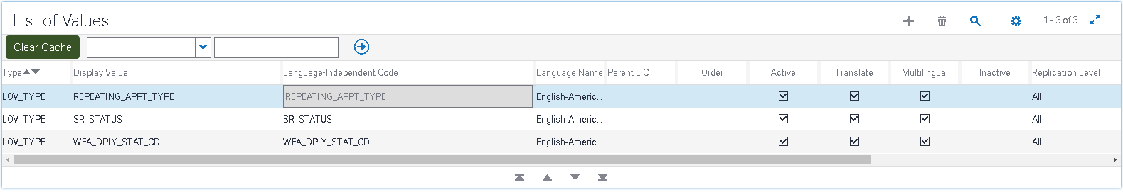

A LOV is simply a huge list of all the drop-down values throughout the Siebel CRM application that are broken out by a type, that is stored in the LOV known as LOV_TYPE. The LOV_TYPE filters each individual picklist. Using the previous examples of Service Request Status, Calendar Recurrence, or Workflow Process Status, you will see that there are three different LOV_TYPEs as follows and shown in the following image:
REPEATING_APPT_TYPE: The Calendar Recurrence LOV_TYPE.
SR_STATUS: The Service Request LOV_TYPE.
WFA_DPLY_STAT_CD: The Workflow Process Status LOV_TYPE

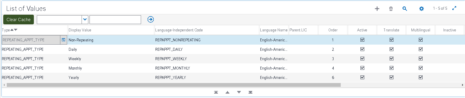

Each LOV_TYPE has specific records/values relevant to the picklists where they are used. For example REPEATING_APPT_TYPE has the following records/values, as shown in the following image: REPAPPT_NONREPEATING, REAPPT_DAILY, REPAPPT_WEEKLY, REPAPPT_MONTHLY, and REPAPPT_YEARLY.

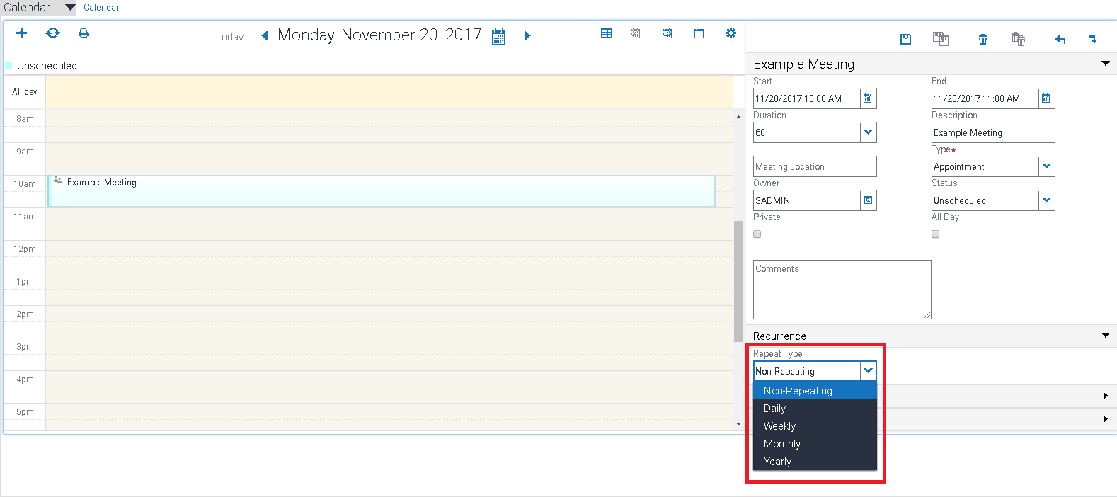

These values appear in the application when selecting the repeating pattern for a meeting. The following REPEATING_APPT_TYPE values appear in the Repeat Type picklist, as shown in the following image: Non-Repeating, Daily, Weekly, Monthly, Yearly.
The LOV_TYPE value in this example, REPEATING_APPT_TYPE, determines which items show up in which picklist based on settings in the Siebel Runtime Repository.
