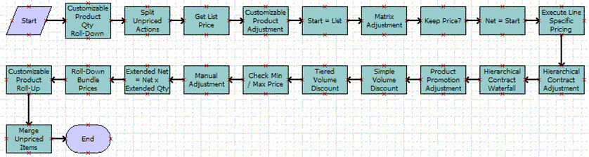

The following figure shows an example of a PSP procedure used in pricing. The steps in this procedure are: Start, Customizable Product Qty Roll-Down, Split Unpriced Actions, Get List Price, Customizable Product Adjustment, Start = List, Matrix Adjustment, Keep Price?, Net = Start, Execute Line Specific Pricing, Hierarchical Contract Adjustment, Hierarchical Contract Waterfall, Product Promotion Adjustment, Simple Volume Discount, Tiered Volume Discount, Check Min/Max Price, Manual Adjustment, Extended Net = Net * Extended Qty, Roll-Down Bundle Prices, Customizable Product Roll-Up, Merge Unpriced Items, End.
Each step in this procedure is a parameterized call to a method in the Row Set Transformation Toolkit.
Notice that one of the steps splits the input row set into multiple temporary subsets. Later steps perform logic on these subsets. The last step merges these subsets, so they form a single row set again.
