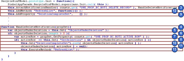

The following figure illustrates the code you use to customize the presentation model to handle notifications. Each number in this figure identifies the corresponding step number in the numbered task list that this book includes immediately after this figure.

In the recyclebinpmodel.js file, add the AttachNotificationHandler to the Init method of the presentation model:
this.AttachNotificationHandler(consts.get("SWE_PROP_BC_NOTI_DELETE_RECORD"), HandleDeleteNotification); -
Add the custom method that Siebel Open UI uses to handle replies from NotifyDeleteRecord and to populate the recycle bin:
function HandleDeleteNotification(propSet){ -
Get the property that you use to identify the objects that Siebel Open UI has flagged for deletion:
var objectsUnderDeletion = this.Get("ObjectsUnderDeletion");You configured this property in Step 10 in the topic Customizing the Presentation Model to Delete Records to back up the records that Siebel Open UI is in the process of deleting.
Determine whether or not any records exist in the In Progress list:
if(objectsUnderDeletion.length > 0){Siebel Open UI must process these records, and then move them to the recycle bin. In this step and in several subsequent steps, you do more than one examination to make sure the notification instance that Siebel Open UI is handling is the instance that it requires for the notification handler. Some repeating notifications might exist that you must process to avoid duplication.
Identify the row that is involved with the NotifyDeleteRecord notification:
var activeRow = propSet.GetProperty(consts.get("SWE_PROP_BC_NOTI_ACTIVE_ROW"));In this example, you use the SWE_PROP_BC_NOTI_ACTIVE_ROW property. For more information about this property, see Summary of Notifications That Siebel Open UI Supports.
Make sure that this notification confirms the deletion, and make sure that this notification is not a duplicate:
if(activeRow == this.Get("GetSelection") && objectsUnderDeletion[activeRow]){where:
The following code determines whether or not the record that the NotifyDeleteRecord method references is the currently selected record:
activeRow == this.Get("GetSelection")This example uses a synchronous request, so Siebel Open UI selects the record that the DeleteRecord method references in the context of PreInvokeMethod. It selects no other record after it makes this initial selection while the Siebel Server sends the delete confirmation notification to the client. For more information, see About Synchronous Requests.
The following code makes sure that this notification is not a duplicate:
objectsUnderDeletion[ activeRow ]It determines whether or not Siebel Open UI has already removed the record that it is examining in a previous instance of handling the same notification for the same record.
Add a property that Siebel Open UI can use to store the list of records that the user deletes but might retrieve from the recycle bin:
this.AddProperty("DeletionCompleteSet", []); -
Store the deleted record:
this.Get("DeletionCompleteSet").push(objectsUnderDeletion[activeRow]);The conditional block where this code resides determines that this notification is not a duplicate NotifyDeleteRecord notification for the record that the DeleteRecord method requests deletion. So, this push statement pushes the deleted record into the DeletionCompletedSet property that you defined in Step 9.
Remove the record from the Deletion in Progress list:
objectsUnderDeletion[ activeRow ] = null; -
Add the RefreshList method:
this.AddMethod("RefreshList", function(){});Siebel Open UI must refresh the recycle bin after Step 11 adds a record to this recycle bin. You can use dependency injection through the AttachPMBinding method to inform the physical renderer that the recycle bin requires a refresh. For more information, see About Dependency Injection. For more information, see How Siebel Open UI Uses Nondetailed Data to Indicate Modifications That Occur in Detailed Data.
Run the RefreshList method:
this.ExecuteMethod("RefreshList"); -
