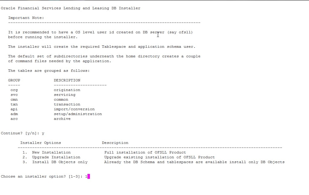

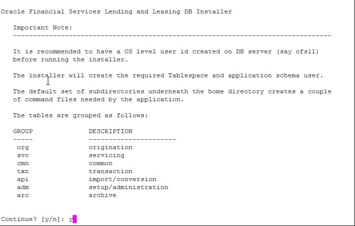

Download and unzip the Application Database file (ofslldb.zip) to a staging folder.
The application database software consists of tables, indexes, types, directories, libraries, views, and packages. A script program creates the application home directory structure, database user, the required tablespaces, database objects and loads the seed data. Snap shots of the script are provided after each step, to enable easy understanding. The steps involved in installing the application database are:
From the unzipped ‘Application Database file’ folder, run the install script from a UNIX shell prompt and follow the on screen prompts to install the Oracle Financial Services Lending and Leasing infrastructure database objects.
On Unix:
$ ./installofslldb.sh
When the script prompts for confirmation, enter ‘y’ to continue.
The script displays install option..
The script prompts to ‘Choose an installer option? [1-3]’.

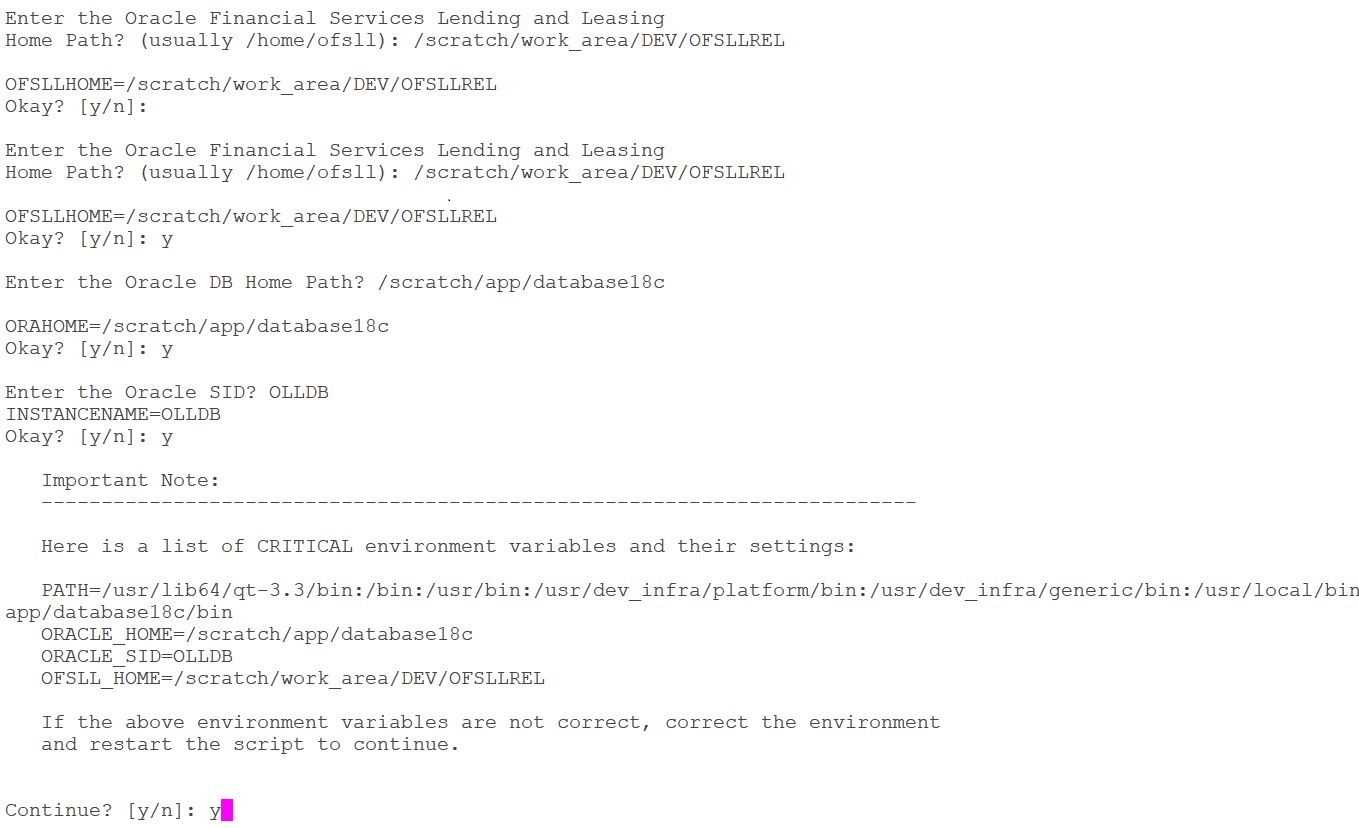

The installation script requires a properly set up environment in order to run. The script requests for few details. Enter the values as listed below. The script requests confirmation after each entry, enter ‘y’ to confirm.
Script Prompts |
Description and Action Required |
Oracle Financial Services Lending and Leasing Home Path |
Enter the path to the application home directory. This is referred to as $OFSLL_HOME. |
Oracle DB Home Path |
Enter the path to the Oracle DB home directory. This is referred to as $ORACLE_HOME |
Oracle SID |
Enter the Name of Oracle Instance. In case of multitenant environment, enter the PDB name' |
Path |
Sets the path that includes $ORACLE_HOME/bin as the installation script requires SQL*Plus utility |
When the script prompts for the confirmation, enter ‘y’ to continue.

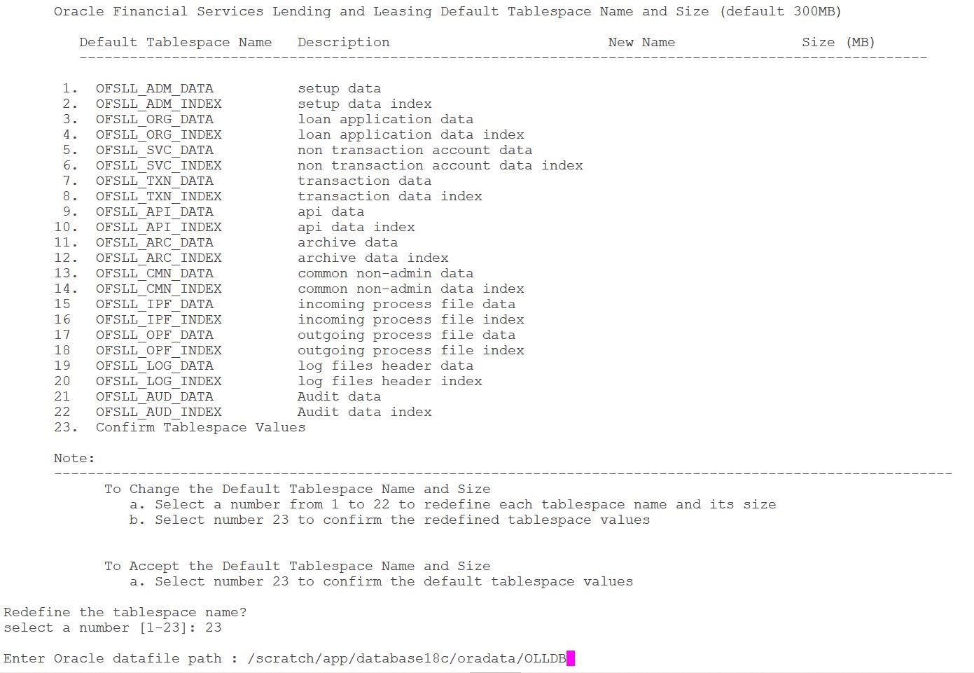

The install script will create a proper directory structure for the application below the user’s home directory and will set the proper permissions on the directories.

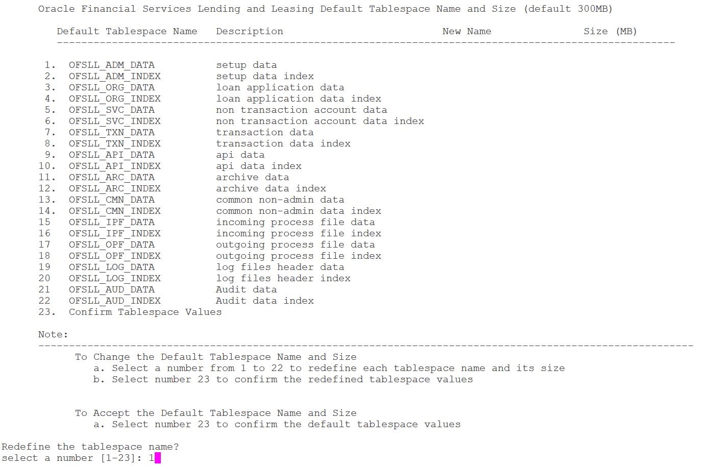

The Oracle Financial Services Lending and Leasing table and index creation DDL allow for the use of up to 22 different tablespaces --11 for tables and 11 for indexes. The DDL commands reference a set of files that contain storage parameter information. These files allow mapping of logical tablespace names to physical tablespaces. Create as many of these tablespaces as necessary depending on the storage resources. Use locally managed tablespaces with a uniform extent policy. The following table describes different tablespaces, their content, and their expected growth pattern.

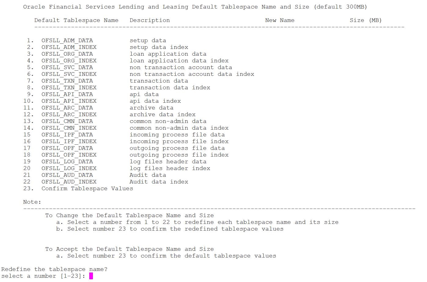

When prompted to ‘Select a number’ to redefine the tablespace name, you have 2 options:
Accept default Tablespace Name and Size: Select # 21
Modify the default Tablespace Name and Size: Select the number of the tablespace, between 1–20, you need to modify
Script Prompts |
Enter new tablespace name |
Enter tablespace name you need to assign to the default tablespace you have selected. |
Enter tablespace size (in MB) |
Enter the size (in MB) you need to assign to the new tablespace name you have entered |
Repeat this process for all the tablespace names you need to modify
Enter # 21 to redefine and to apply changes for the tablespaces you modified.

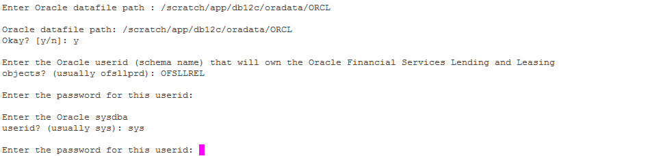

Script Prompts |
Oracle tablespace path |
Installed Database path that stores DBF files. Once entered the script prompts for confirmation. Enter ‘y’, if it is ok |
Oracle User ID that will own the Oracle Financial Services Lending and Leasing objects |
Valid User ID |
Password for this User ID |
Valid Password |
Oracle sysdba User ID |
Valid User ID |
Password for sysdba User ID |
Valid Password |
Oracle Financial Services Lending and Leasing application requires a single Oracle user (or schema) and this user is the application owner. The application owner user owns all of the tables, indexes, views, sequences, packages, etc. that make up the application.
The user is then granted access to the application tablespaces.

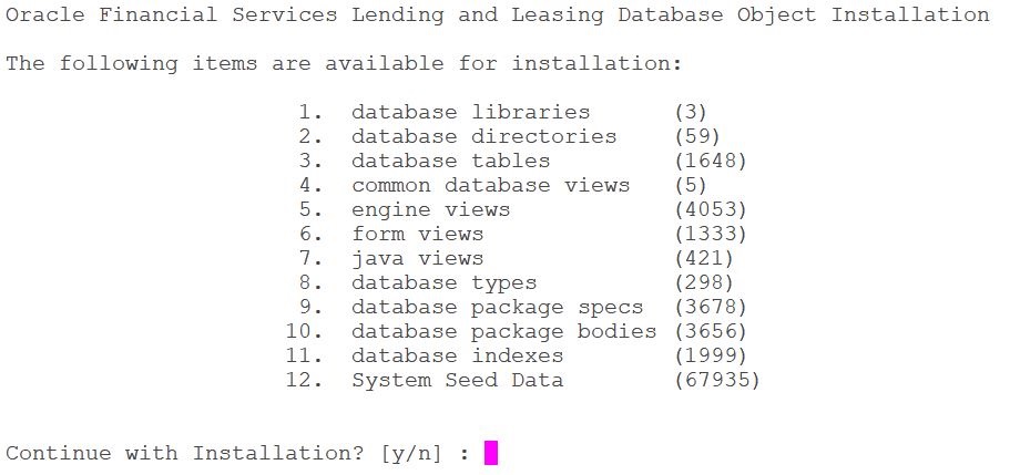

Once the User ID is created, the script initiates the database object installation and lists the objects available for installation.

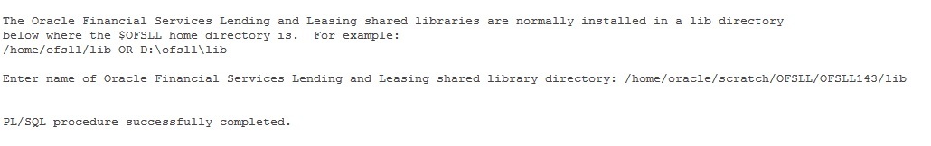

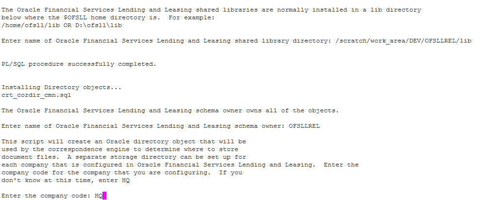

Once the confirmation is received, the script initiates installation of library objects. A sample of the script is given below.
Script Prompts |
Shared Library Directory |
The path for the library directory. The default value is $OFSLL_HOME/lib |
The fax images, correspondence documents, and the account document images are stored as BFILE objects. With BFILE, the image or document is physically stored outside the database on a file system available either on the database server or to the database server. A pointer to the file consisting an Oracle directory object and a file name is stored in the database. Application programs that create the BFILEs use application parameters to determine the specific directory object name. The application parameters are company level parameters, hence, a different directory object can be created for each defined company and branch.
Choose a name that identifies the usage, company, and branch for the directory object. Since directory objects are for the entire database and not just for the application, it is suggested that the schema name or identifier is used in the name to identify it from other directory objects. Choose a directory path with enough storage space to handle the expected volume of correspondences.

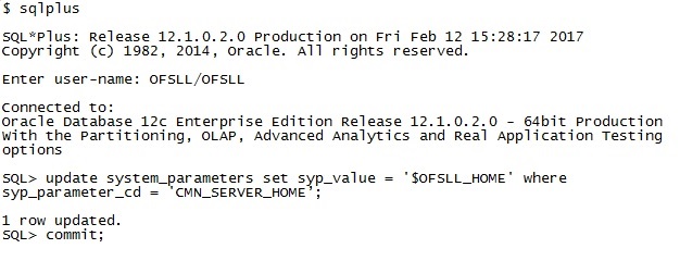

As mentioned, the CMN_SERVER_HOME parameters must be set manually before the application screens can be used to set other parameters.
CMN_SERVER_HOME
Set it to the $OFSLL_HOME directory.

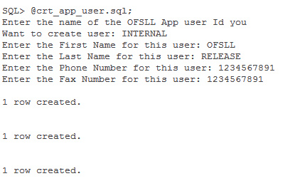

Creating the user 'INTERNAL'. This user is required for batch job process, webservices and to start services.
A script is provided in the distribution media in the dba_utils folder to create an user. Run the script "crt_app_user.sql script" as a OFSLL application owner user.

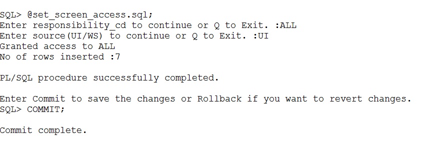

Post user creation, to access all the ‘Screens’ and 'web service' for a specific responsibility, login as an application schema owner and do the following:
set_screen_access.sql
In the prompt, enter the user responsibility. You can also specify ‘ALL’ to provide screen / web service access to all the created users in bulk.
In the next prompt ‘source(UI/WS)’, enter one of the following:
Further, you can customized the access through Setup > User > Access screen - ‘Screen’ and ‘Webservice’ tabs, as detailed in setup guide.

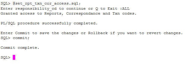

Granting user access to Reports, Transactions, & Correspondence
Post user creation, to access all the Reports, Transactions, Correspondence for a specific responsibility, login as an application schema owner and execute the following db script available in dba_utils folder.
set_rpt_txn_cor_access.sql
In the prompt, enter the user responsibility. You can also specify ‘ALL’ to provide screen access to all the created users in bulk.
Further, you can customized the access through Setup > User > Access screen as detailed in setup guide.

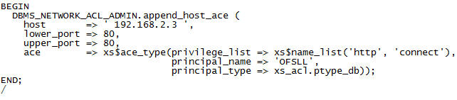

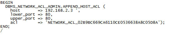

Oracle allows access to external network services using several PL/SQL APIs (UTL_TCP, UTL_SMTP, UTL_MAIL, UTL_HTTP and UTL_INADDR), all of which are implemented using the TCP protocol.
An Access Control Entry can be limited to specific PL/SQL APIs (UTL_TCP, UTL_INADDR, UTL_HTTP, UTL_SMTP, and UTL_MAIL).
In a multitenant environment, Access Control Entries (ACEs) can be created at the CDB or PDB level. For the examples in this article, all the host ACLs and host ACEs will be created at the PDB level. The following code creates two test users in a PDB.
Host ACL are never created directly. Instead, they are implicitly created when we append a host Access Control Entry (ACE) using the DBMS_NETWORK_ACL_ADMIN.APPEND_HOST_ACE procedure. If we append a new ACE to a host that has no existing host ACL, a new host ACL is implicitly created. If the host already has an ACL, the new host ACE will be appended to the existing host ACL.
Login to SQL*Plus as the SYS user.
The parameters used in the procedures and functions above
Parameters |
Description |
host |
Any valid host name or IP address. Wildcards are allowed. |
lower_port |
Specific port number, or lower part of a range of ports. |
upper_port |
Upper part of a range of ports. If NULL, it defaults to the lower_port value. |
ace |
The access control entry, defined using the XS$ACE_TYPE type. |
The XS$ACE_TYPE type has the following definition.
Parameters |
Description |
privilege_list |
The list of privileges available to the ACE. |
principal_name |
The database user the ACE applies to. |
principal_type |
You will always use XS_ACL.PTYPE_DB for these network ACEs as they apply to users and roles. |
The privilege_list specifies one or more privileges in a comma separated list. The available privileges are shown below.
