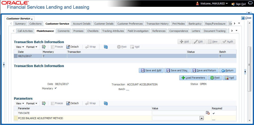

The Customer Service screen’s Maintenance sub tab enables you to post an array of monetary and nonmonetary transactions for any given account. The transactions that are available depend on responsibility of the Oracle Financial Services Lending and Leasing user, nature of account, and whether the account is a Loan.
Appendix A : This appendix catalogues the baseline transaction codes and parameters available on Customer Service screen’s Maintenance sub tab. Instructions on how to use the Maintenance sub tab are located in Customer Service chapter of this User Guide.
This section catalogues the transaction codes and parameters required to complete the following monetary tasks for Loan:

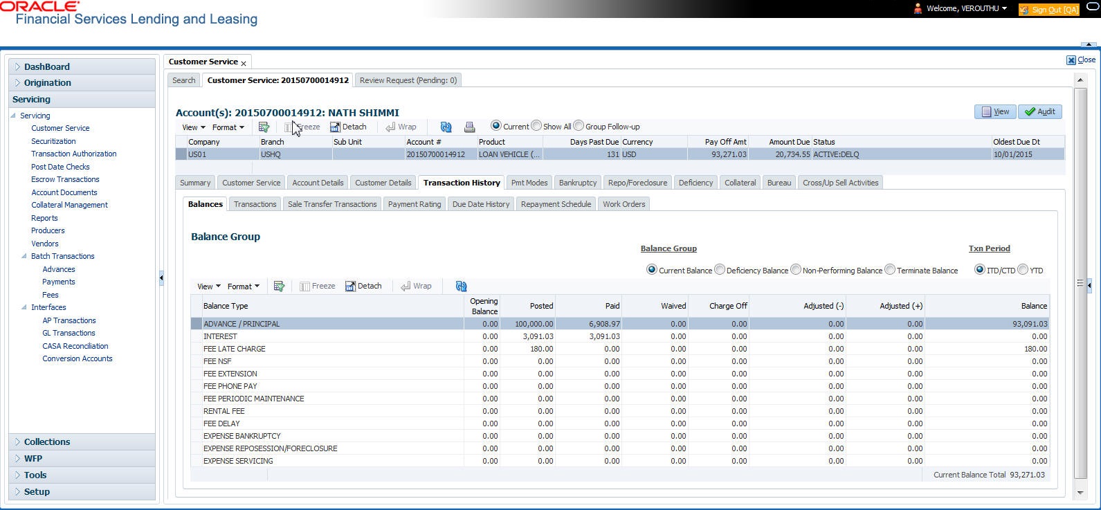

A payoff quote is the amount still owed on account or amount needed to satisfy the Loan. It can be generated anytime and may be requested during a call from a customer, dealer, or insurance agent. A payoff quote can either be generated for current or future date, but not on a back date.
The transaction processing details and new balances after posting payoff quote appears in Results section of Maintenance screen.

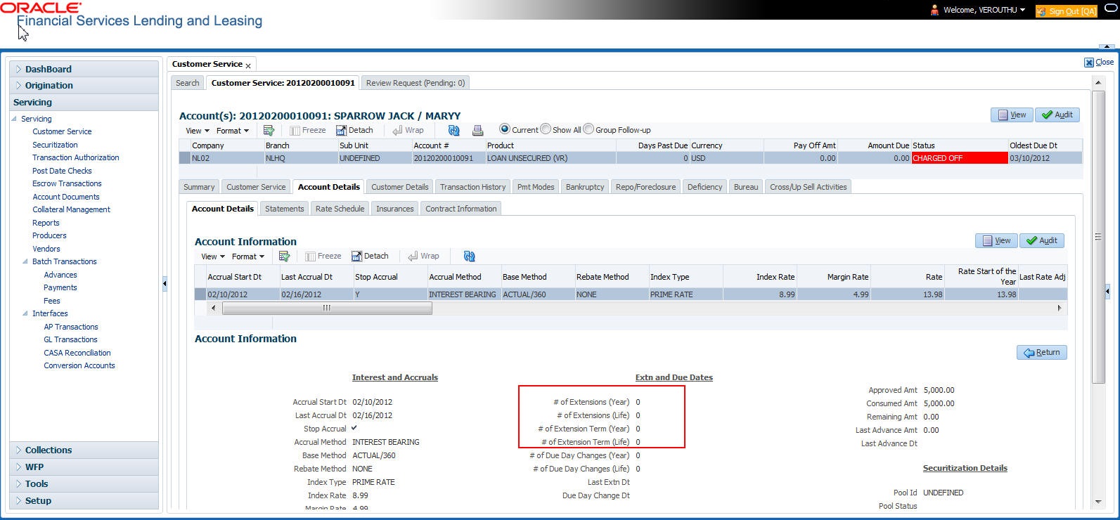

Charging off an account refers to when a lender decides to take a loss on an account, signalling that attempts to recover the Loan have failed. In calculating a charge off, the system considers the total compensation amount (up front compensation plus remaining compensation amount). It is different from the waive off process since a waive off is a concession offered to the customer on payment of some component, such as a late fee. The repayment of the original Loan still continues in waive off process.
When you charge off account, the system changes the status to CHARGED OFF. The balance on the account appears on Customer Service form’s Balance screen when you choose Deficiency Balance in the Balance Group section.
The date of the charge off appears on Account Details screen in Activity section’s Chargeoff Dt field.
However, you can select the ‘Do Not Auto Charge Off’ condition to ignore few account conditions, for the charge-off processing batch job. When an account is marked with the condition DO NOT CHARGE OFF, then batch job will not pick the account for charge off processing.
You can add ‘Do Not Auto Charge Off’ condition in addition to the already existing condition.

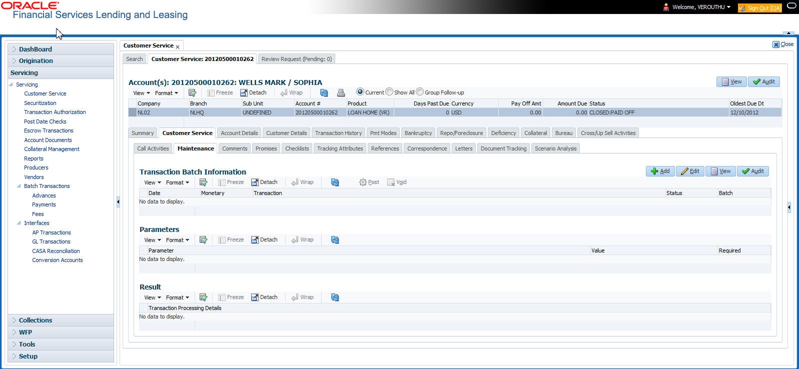

The system automatically closes an account when its status changes from ACTIVE status to Paid or Void. It is manually closed if it has status as CHARGE OFF. Accounts marked as Closed are not processed and after a period of time are purged from Oracle Financial Services Lending and Leasing.

Extension transactions allow you to extend a Loan by moving the balances to future date. Extensions can either be based on ‘Unpaid’ due date or on Oldest due date. An extension fee may be assessed when an account receives an extension. In case of precomputed Loan, this is generally done to recoup the interest lost.
The system adjusts due date on Dues section’s Oldest Due Dt field on Account Details screen to reflect the extension.
It also notes the change with an entry on the Loan Details screen in the Extn and Due Dates section’s # of Extensions (Year), # of Extensions (Life), # of Extension Term (Year) # of Extension Term (Life) fields.
Transaction |
Parameters |
EXTENSION |
TXN DATE Select the extension transaction date from adjoining calendar. |
EXTENSION TERM Specify the required extension term in months. |
REASON Select the reason for extension from the drop-down list. |
STOP ACCRUAL Select either YES or NO from drop-down list to stop the interest accrual on the account. |
PROCESS MASTER ASSOCIATED ACCOUNTS Select either Yes or No from the drop-down list. Selecting ‘Yes’ posts the extension transaction to Master Account and Associated Accounts and selecting ‘No’ posts extension only to current account. |
PROCESS SAME PRODUCT TYPE AND FUNDING TYPE ACCOUNTS Select either Yes or No from the drop-down list. Selecting ‘Yes’ posts the transaction on accounts belonging to same product type and selecting ‘No’ posts the transaction to ALL accounts. |
EXTENSION BASIS Select one of the following option as the basis for posting the extension from the drop-down list. OLDEST DUE DATE -To post extension considering the oldest unpaid due date. Any paid due buckets is not altered and original due dates are retained. UNPAID DUES - To post extension considering only the unpaid due buckets. Here the unpaid due dates are moved by adding the terms represented in the transaction. Unpaid dues are those for which Payment = N in Due Date History and may also include the partially paid amount (i.e. paid amount - tolerance amount). |
CAPITALIZATION START DATE (INCLUDING GRACE DAYS) When extension is being posted on an account for which balance capitalization is enabled, select the next capitalization date from the adjoining calendar which by default includes the CAP GRACE DAYS before triggering the balance capitalization. |
While posting an extension, ensure that the minimum number of required payments, as defined at contract level is met. Else, system displays an error message on verification. Also while posting subsequent extension transactions, ensure that the minimum gap requirement between two extensions is satisfied.

OFSLL supports accelerating a fraudulent loan account for immediate settlement for both pre-compute and non-pre-compute loans. During account acceleration, the loan maturity date is moved to the specified date (either current date or back date) and appropriate transactions are posted for Principal and Interest Adjustment calculations.
Before posting an account acceleration transaction, refer to Appendix - Account Acceleration chapter for detailed information on the process and operational changes on accelerated account.
You can accelerate only those accounts which are in 'ACTIVE' status and post the transaction either manually in the Customer Service > Maintenance screen or through Web Service (generic post transaction service).
To post an account acceleration transaction
Transaction |
Parameters |
Description |
ACCOUNT ACCELERATION |
TXN DATE |
Select the date from which the acceleration is effective on the account. The same can either be the current date or a back date (up to ‘contract date' or 'account back date 'whichever is higher) but not a future date. The selected date will be the acceleration start date and the new maturity date of the account. In case of pre-compute loan accounts, the same date is used for the following actions: - As the effective date for PC (pre-compute) to SI (simple interest) conversion. - As the date for calculating the account finance charge rebate. |
PC2SI BALANCE ADJUSTMENT METHOD |
For 'Pre-Compute' accounts, select one of the following parameter from the drop-down list. The values in this list are populated based on the lookup code ‘PC2SI_BAL_METHOD_CD (PC2SI BALANCE ADJUSTMENT METHOD CODES)’ - PRINCIPA L FIRST - INTEREST FIRST For details on how the PC to SI conversion calculation is done based on above selection, refer to Appendix - Account Acceleration chapter. For ‘Non-Pre-Compute' accounts, select the parameter value as ‘Undefined’. Else, system displays an error on selecting any other value as 'Balance Adjustment Method mandatory for Pre-Compute a/c'. |
On posting the transaction, there are certain pre-defined validations preformed before proceeding with the transaction. Also, on successfully posting the transaction there are certain operational changes on the accelerated account and common actions / implications on posting of transaction (PC or Non PC Account Types).
Acceleration applied on an account can be reversed if required so that the account is reinstated to its previous status. However, the reversal is to be triggered immediately after posting the transaction such that the post maturity interest accruals, fee/expenses posting, and customer payments posting are not initiated.
However during reversal of an account acceleration, there are some changes are performed on the account and the same is detailed in Appendix - Account Acceleration chapter.
To reverse an account acceleration transaction
Transaction |
Parameters |
ACCOUNT_ACCELERATION_REV |
Txn Date |
