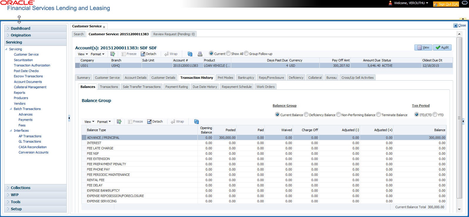

The Customer Service screen’s Maintenance sub tab enables you to post an array of monetary and nonmonetary transactions for any given account. The transactions that are available depend on responsibility of the Oracle Financial Services Lending and Leasing user, nature of account, and whether the account is a Loan.
Appendix A : This appendix catalogues the baseline transaction codes and parameters available on Customer Service screen’s Maintenance sub tab. Instructions on how to use the Maintenance sub tab are located in Customer Service chapter of this User Guide.
This section catalogues the transaction codes and parameters required to complete the following monetary tasks for Loan:

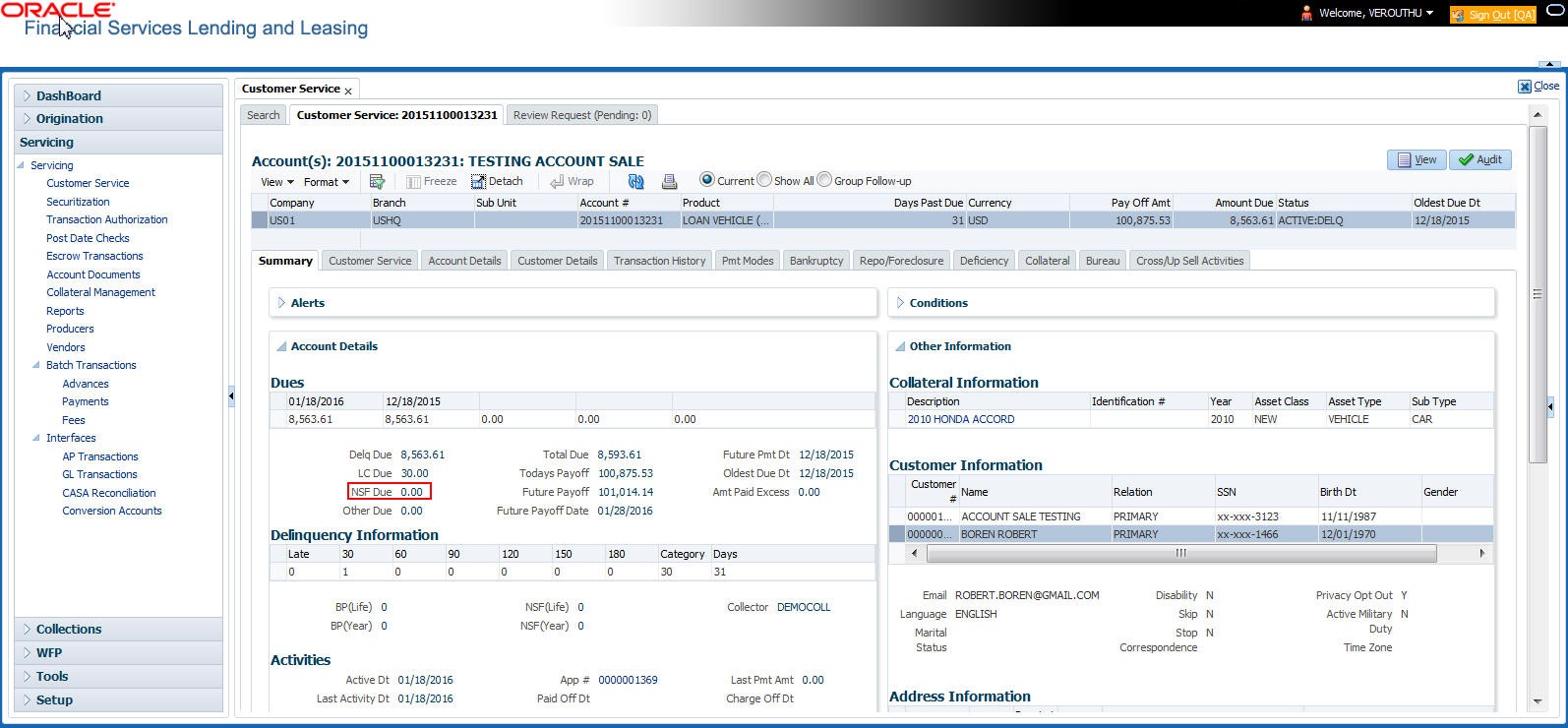

Nonsufficient fund fees are posted when a payment does not cover the amount owed. The fee that the system automatically applies to an account is recorded during setup.
Nonsufficient fund fees appear in the NSF Due field on the Dues section of Summary tab of Customer Service screen. This is the first screen to appear on the Customer Service screen when you load an account.

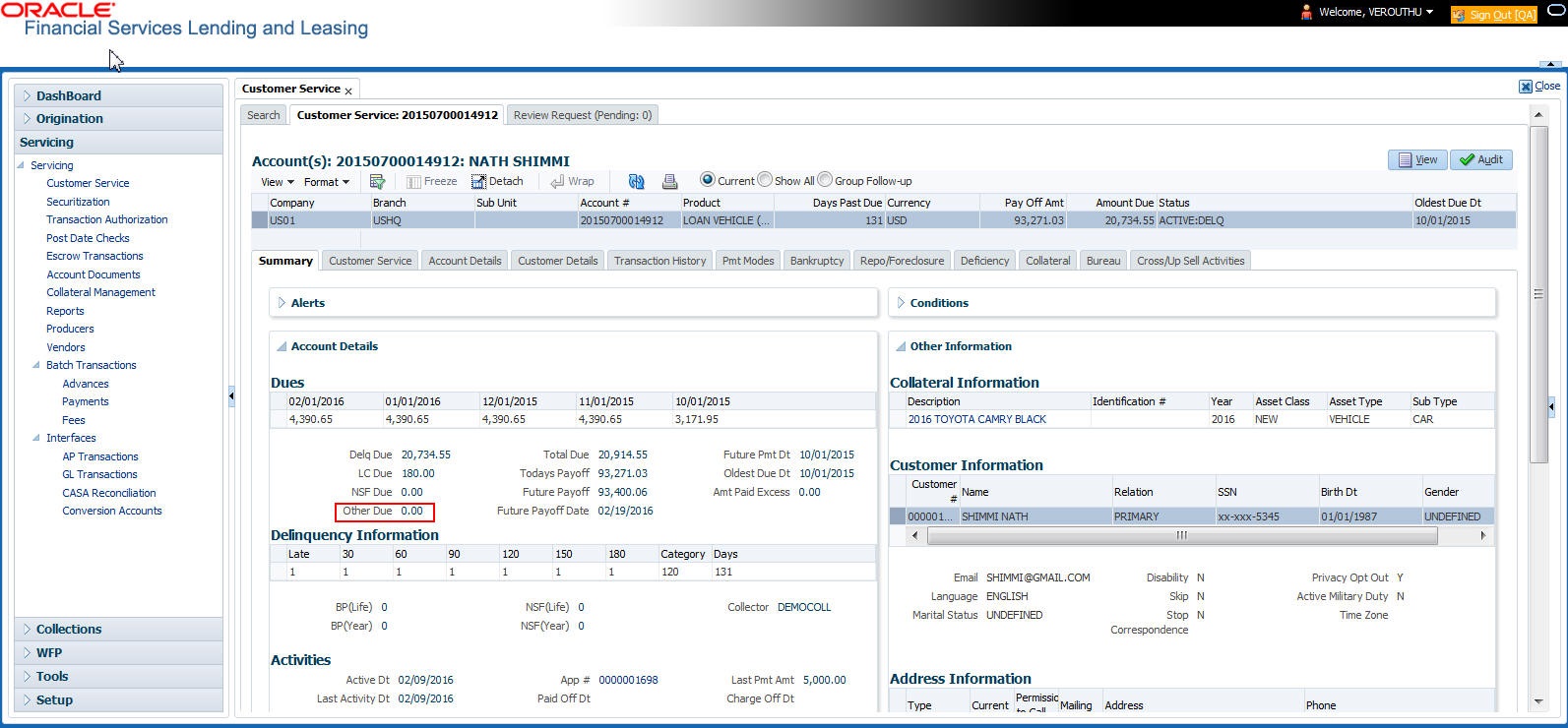

Repossession expenses include any costs incurred while obtaining the asset, including legal fees or storage costs.
Repossession expenses appear in Other Due field on the Dues section of the Summary tab of Customer Service screen. This is the first screen to appear on the Customer Service screen when you load an account.

Bankruptcy expenses include any costs incurred when an account holder declares bankruptcy, such as legal fees or additional collection costs.
Bankruptcy expenses appear in the Other Due field on the Dues section of Summary tab of Customer Service screen. This is the first screen to appear on the Customer Service screen when you load an account.

Phone pay fees are where a borrower calls the lender and arranges for a debit to their checking or savings account to make a payment on a Loan account.
Phone pay fees appear in Other Due field on Dues section of the Summary tab of Customer Service screen. This is the first screen to appear on the Customer Service screen when you load an account.

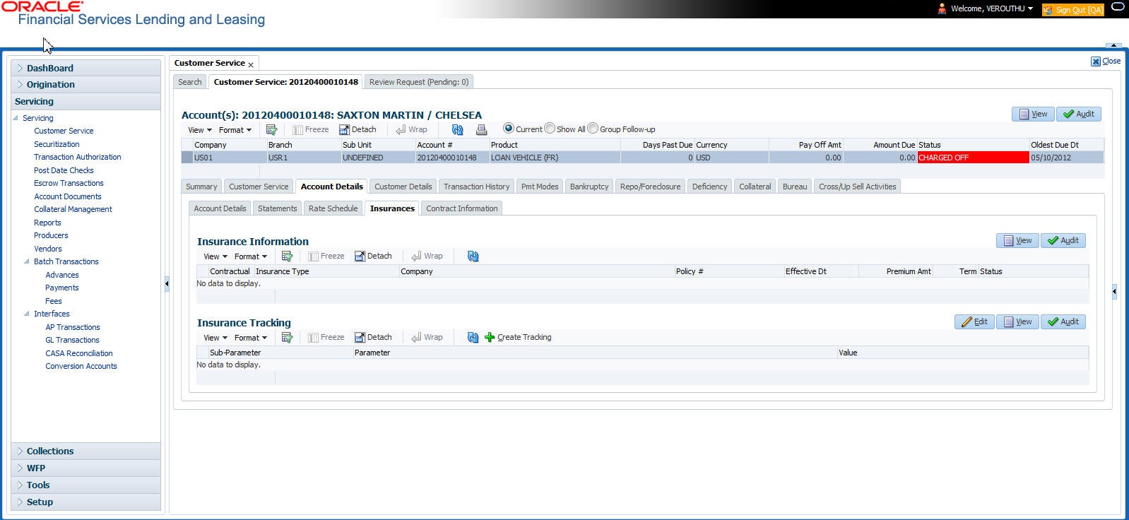

In this section, you can do the following:
You can add financed insurance to an existing account with the INSURANCE ADDITION transaction. This transaction adds insurance premium amount to advance/principal balance on the Loan and adjusts the Loan receivables accordingly. The transaction also triggers the process to re-compute repayment amount for Loan. After you post the transaction Loan will be billed for newly computed payment amount and will be considered for delinquencies and fees calculations based on information on the Contract link’s Contract screen. The newly added insurance information can be viewed on Customer Service drop-down link’s Insurances link.

You can cancel financed insurance on an existing account with the INSURANCE CANCELLATION transaction. When you post this transaction, the system computes premium refund amount based on the refund method associated with insurance item.
To cancel a financed insurance
Transaction |
Parameters |
Insurance Cancellation |
Txn Date |
Insurance Type |
Policy Effective Date |
Insurance Refund Amount |
Cancellation Reason |
Current Usage |
If you enter a value for INSURANCE REFUND AMOUNT parameter, the system overrides calculated refund amount and adjusts advance/principal balance and Loan receivables accordingly. The INSURANCE CANCELLATION transaction re-computes the repayment amount for Loan based on remaining balances. After posting the transaction, Loan will be billed for newly computed payment amount according information on the Contract tab’s Contract sub tab. The insurance cancellation information can be viewed on the Contract link’s Insurances sub screen.
Also if you enter a value for ‘Current Usage’, system computes the rebate amount using the 'Pro Rata (Mileage) method. However system also calculates the rebate amount using ‘Refund Calculation Method' and considers the minimum value out of both.
You may rectify possible errors resulting from incorrect information entered on the INSURANCE ADDITION transaction (such as an incorrect premium account) with the monetary transaction INSURANCE MODIFICATION.

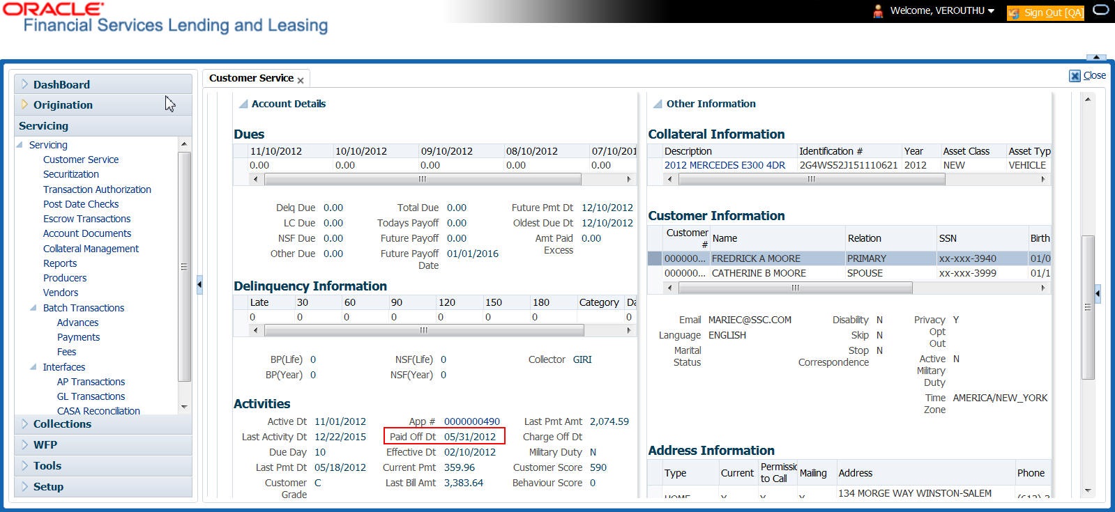

An account is automatically paid off or marked for payoff processing by the system with a batch transaction when the account balance is $0.00. You can also manually payoff an account with the Maintenance screen. You can also pay off an account using the Consumer Lending (Advance and Payment) form. For more information, see the Payment Processing chapter.
When you payoff an account, the system changes the account’s status to PAID OFF. The date the account was paid off appears in Activities section’s Paid Off Dt field on Account Details screen.
The system also notes the amount of the principal that was waived when account was paid off in the Waived column on Account Balances screen.
To pay off an account
Transaction |
Parameters |
Paid off |
Txn Date |
If you reverse the payoff payment using Customer Service form, then the pay-off is automatically reversed. The system changes the account’s status from PAID OFF to ACTIVE when you refresh the account.

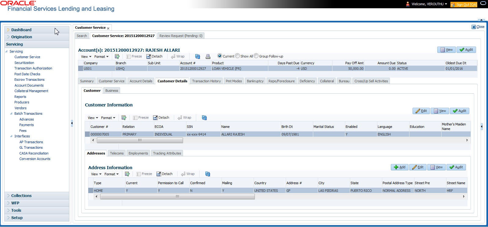

The new details appear throughout the system; for example, in Customer Service screen’s Customer(s) section and Customer Details screen’s Customer section.
You can update and change the following details regarding a customer: social security number, marital status, disability indicator, driving license number, number of dependants, and email address.
To change other details about a customer
Transaction |
Parameters |
Customer Maintenance |
Txn Date |
Relation Type Code |
Customer SSN |
Customer Marital Status Code |
Customer Disability Indicator |
Customer Driving License Number |
Customer Number of Dependents |
Customer Email Address 1 |
Customer Birth Date |
Customer Gender Code |
Customer Language Code |
Customer Driving Licence State Code |
Customer Time Zone |
Payment Hierarchy |
Note
The payment hierarchy is auto-populated by the system based on new/existing customer details and the same can be modified. For more information, refer to Payment Hierarchy field details in Customer sub tab section.
The new details appear throughout the system.

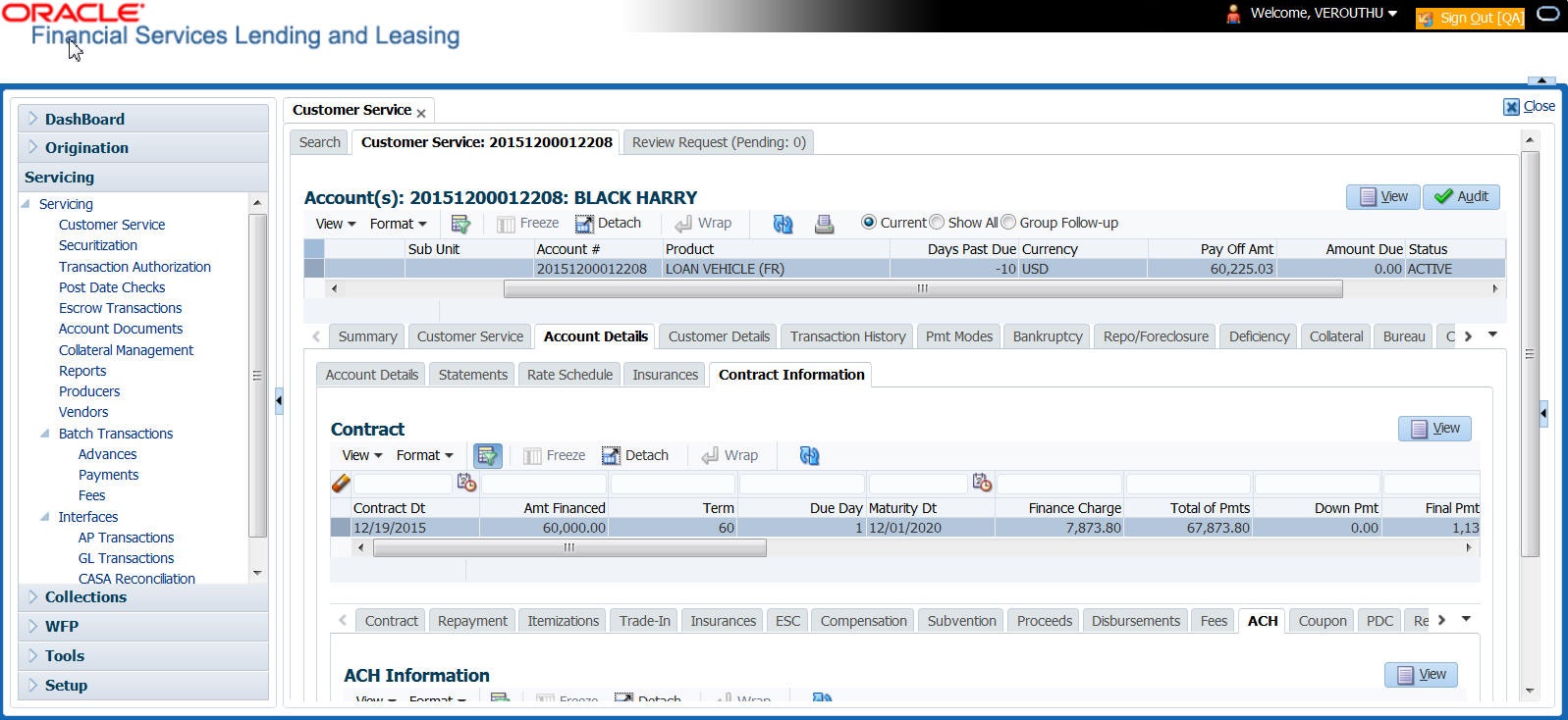

The ACH maintenance transaction is for updating the existing ACH Banks details and not to define a new Ach Bank. The transaction is effective provided the ACH account no, ACH routing no, account type are matching with the existing Ach Banks details. On successful posting, the confirmation number will be generated.
To update the existing ACH bank details
Transaction |
Parameters |
ACH Maintenance and NEW ACH MAINTENANCE and ACH ONE TIME PHONE PAY |
ACH Account Number |
ACH Account Type Code |
ACH Payment Frequency Code |
ACH Status Code |
ACH Bank Name |
Bank City |
Bank State |
ACH Bank Routing Number |
ACH Reference Number |
Payment Mode |
Name as it Appears on Account |
ACH Default Indicator |
ACH End Date |
ACH Payment Amount |
ACH Payment Amount Excess |
ACH Payment Day |
Phone Pay Fee |
ACH Fee Indicator |
ACH Start Date |
Debit Date |
Txn Date |
Note that for an active Recurring ACH record, ensure that the payment mode is selected as AUTOPAY and for an AUTO PAY type of Payment Mode, ensure that at least one active ACH record exist.
This information appears in the ACH section of the Account Details screen.

You can update and maintain Contract Information at Account level during Servicing and Collection stage by posting ‘ACCOUNT CONTRACT MAINTENANCE’ non-monetary transaction in Customer Service > Maintenance > Transaction Batch Information section.
By default, the contract information in Customer Service screen’s Contract sub tab is populated from Origination screen on funding the application and is a display only version of the same information found on the Funding screen’s Contract screen.
This transaction can be posted on all Product Type, Status and Conditions. On posting, the same does not restructure the account based on the account fields update. Also, no calculations are performed as a result of posting of this transaction.
To post Contract updates to an account
Transaction |
Parameters |
ACCOUNT CONTRACT MAINTENANCE |
TXN DATE |
AMOUNT FINANCED |
APPLICATION CHANNEL |
DISBURSED LOAN AMOUNT |
TOTAL DOWN PAYMENT AMOUNT |
TOTAL SALES PRICE |
CONTRACT RCVD DATE |
CONTRACT VERIFIED BY |
CONTRACT VERIFIED DATE |
COMMENTS |
REASON CODE |
For more information on above fields, refer the section Contracts tab in Funding chapter of the Origination User Guide.
On successfully posting the transaction, a confirmation message is displayed in the Results section and contract details are updated to the account in Customer Service > Account Details > Account Details tab.
