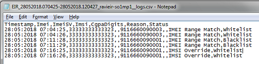

For example, if an MP server receives entry ID 1234 on July 15, 2003, at exactly 4:36 PM from a Service Module card provisioned at address 192.168.120.1 indicating that Blacklisted subscriber 9195551212 using handset 12345678901234 was detected, this entry is created:
20030715163600,192.168.61.1,1234,9195551212,12345678901234,0
Figure 3-1 Sample Log File
img/sample-log-file.png
