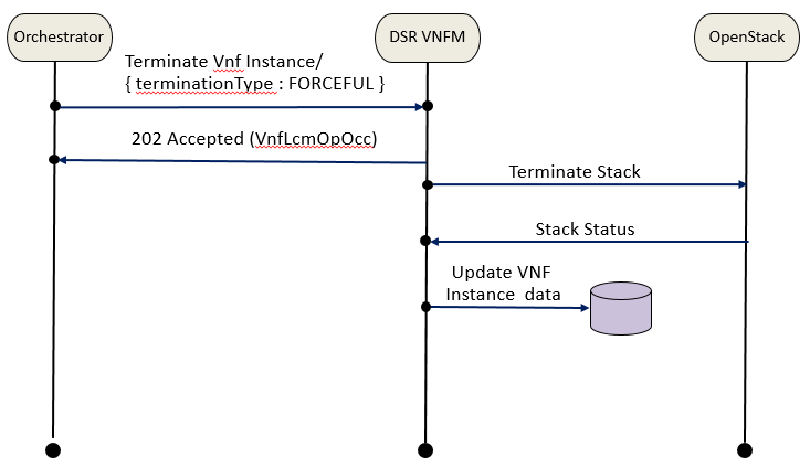

Forceful Termination
If the VNF is still in service, requesting forceful termination can adversely impact the network service.Figure 15-1 Forceful Termination
Terminating DSR and SDS VNF Instance Forcefully

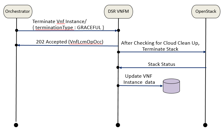

Graceful Termination
The VNFM first validates if the VNF configuration is cleaned up after accepting the request. Once that configuration is cleaned, the VNFM deletes the VNF. Then the instance file is updated with VNF Operational State set to STOPPED.
If AppWorks configurations are not cleaned manually and the orchestrator tries to do graceful termination for that VNF, then the termination of VNF fails.
User must manually cleanup the AppWorks configurations before doing Graceful Termination.Steps for cleaning up the AppWorks Configuration for Signaling Stack of DSR and SDS:

Figure 15-2 Graceful Termination
Terminating DSR and SDS VNF Instance Gracefully
