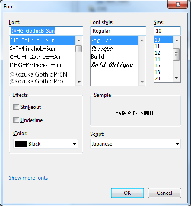

3. (Optional) In order to populate the system with alternative language options, do the following:
Open IBM Data Studio and set font in editor for properly displaying Japanese (HG-GothicB-Sun)
Figure 2.3.1 - Font Style Dialog -

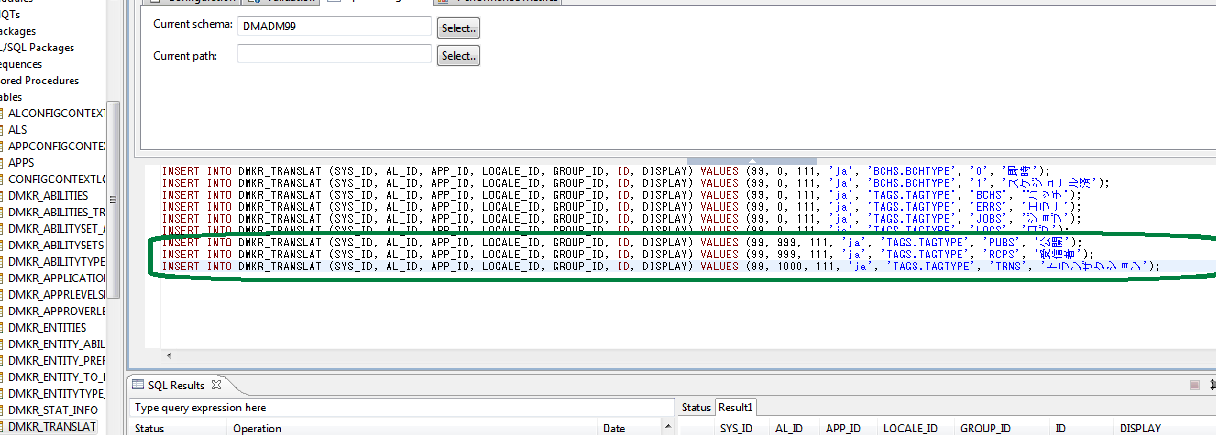

Open the dmkr_admin_xx.sql in a text editor that displays text correctly (in the example below, Notepad properly displayed Japanese text).
Copy and paste the content of the script into IBM Data Studio tool editor for SQL and validate the characters are correct.
Example from Notepad, dmkr_admin_ja.sql:
INSERT INTO DMKR_TRANSLAT (SYS_ID, AL_ID, APP_ID, LOCALE_ID, GROUP_ID, ID, DISPLAY) VALUES (99, 999, 111, 'ja', 'TAGS.TAGTYPE', 'PUBS', '公開');
INSERT INTO DMKR_TRANSLAT (SYS_ID, AL_ID, APP_ID, LOCALE_ID, GROUP_ID, ID, DISPLAY) VALUES (99, 999, 111, 'ja', 'TAGS.TAGTYPE', 'RCPS', 'Âèó‰ø°ËÄÖ');
INSERT INTO DMKR_TRANSLAT (SYS_ID, AL_ID, APP_ID, LOCALE_ID, GROUP_ID, ID, DISPLAY) VALUES (99, 1000, 111, 'ja', 'TAGS.TAGTYPE', 'TRNS', '„Éà„É©„ÉŠ„ǹ„ÇØ„Dz„É߄Ɋ');
From IBM Data Studio:
Figure 2.3.2 - IBM Data Studio -
Process the DML statements, inserts, to the correct dmkr_admin schema.
Validate that the content appear correctly in table by selecting the rows for review.
Repeat with the dmkr_asline_xx.sql targeting the dmrk_asline schema for inserts.

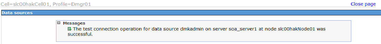

View the Configure JDBC Data Sources options (do not change these values), then click Next.
The connection to the database is tested. When the test finishes, view the results, then click Next.
Copy the sqljdbc4.jar file under wl_server\/server\/lib, your_domain_name\/lib if JDBC Component Schema fails to make connection. This is applicable only for MS SQL Server.
Update the Configure JDBC Component Schema window. This will configure the connections your SOA repository. Click Next.
Figure 2.3.3 - Data Sources Dialog Message -
