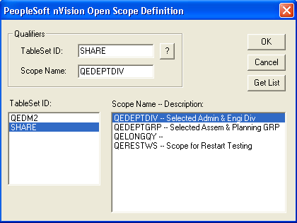

Image: PeopleSoft nVision Open Scope Definition dialog box
This example illustrates the fields and controls on the PeopleSoft nVision Open Scope Definition dialog box.

From within the PeopleSoft nVision Scope Definition dialog box, click the Open button.
The PeopleSoft nVision Open Scope Definition dialog box appears.
Click the Get List button to see a list of available scope definitions.
In the TableSet ID list box, there is a list of setIDs; in the Scope Name – Description list box, there is a list of scope definitions for each setID.
You can limit the list by entering qualifiers into either the TablesSet ID or Scope Name fields before clicking the Get List button.
Select a scope definition from the list.
Click the OK button.
