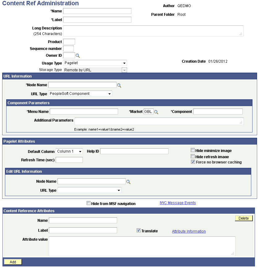

Access the Content Ref Administration page. (Select Click the Edit link for a content reference.)
Image: Content Ref Administration page for a pagelet
The following screenshot illustrates about modifying Pagelet attributes and security on the Content Ref Administration page.
The portal registry stores every content reference that is available through the portal. The label and description defined here affect the appearance of the label and description in the navigation menu. Other attributes on this page affect the URL that will be used to reference the content associated with a definition.

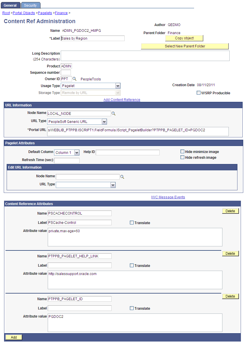

Image: Content Ref Administration page for a URL-based pagelet
The following screenshot illustrates registering URL-Based Pagelets on the Content Reference Administration Page.

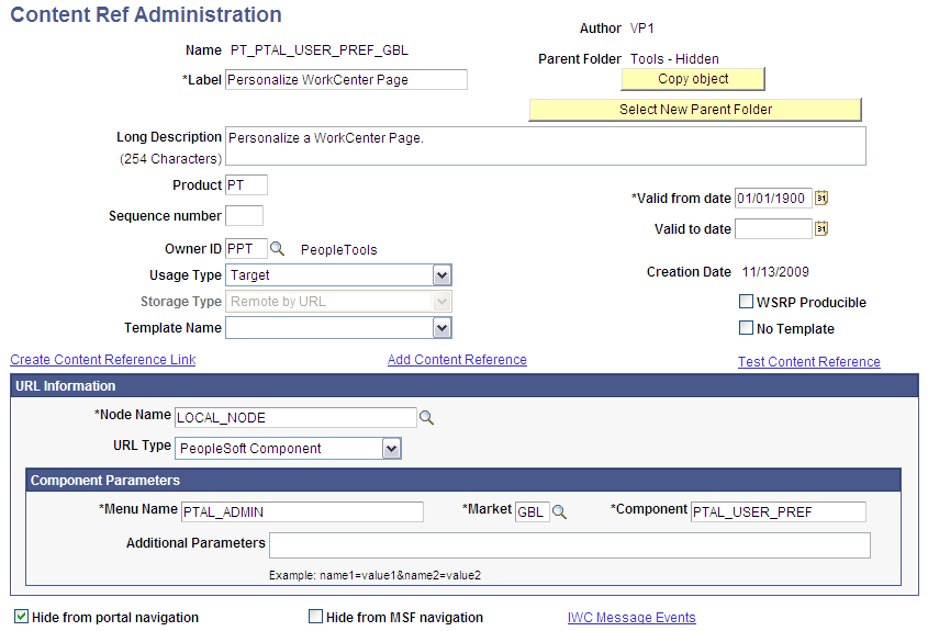

The following screenshot is an example of registering pagelet extensions for a Personalization page.
A personalization page must be identified in the registry as being related to a specific pagelet application.
Note that the personalization component (PTAL_USER_PREFS) is referenced in the Component Parameters group box. This is where the personalization page that is related to the pagelet application is identified.
