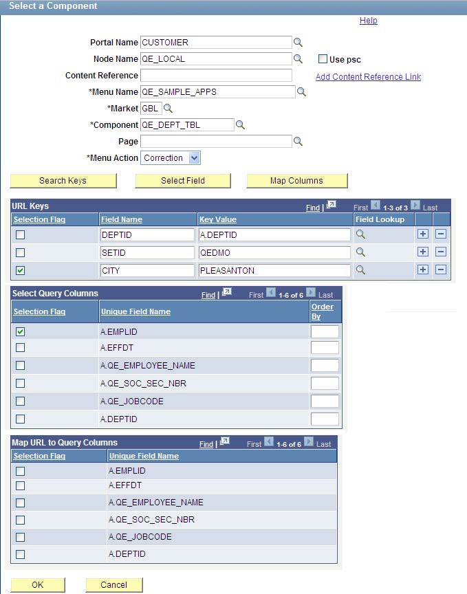

Defining Component Drilling URLs
The Component URL widget enables you to use the Select a Component page (QRY_COMPURL_SELECT) to build drilling URLs in component URL format. When you click the Component URL link in the Edit Expression Properties page to access the Select a Component page, a PeopleSoft Pure Internet Architecture page is launched.

Image: Select a Component page
This example illustrates the fields and controls on the Select a Component page. Definitions for the fields and controls appear following the example.

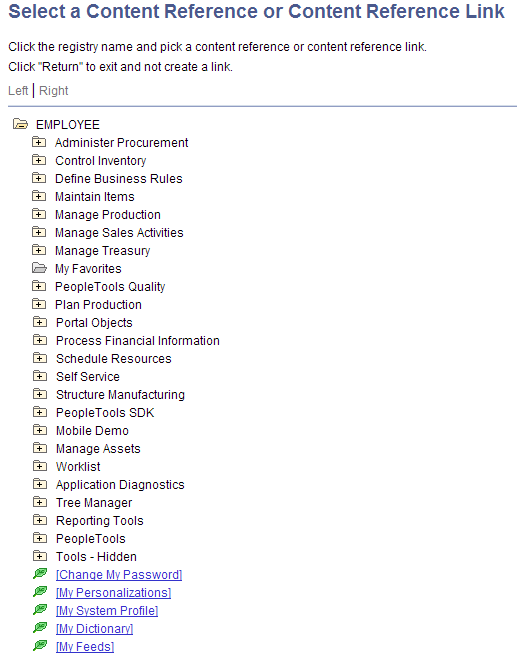

Use the Select a Content Reference or Content Reference Link page (QRY_CREFURL_SELECT) to select a content reference or content reference link.
Navigation
Select
.Select the Expressions tab, and click the Add Expression button.
Select the Drilling URL option from the Expression Type list, and click the Component URL link.
Click the Add Content Reference Link link.
Image: Select a Content Reference or Content Reference Link page

To select a component to build drilling URLs:
Select
The Query Manager search page appears.
Click the Create New Query link on the Query Manager search page to create a source query, or click the Search button and open an existing one.
If you create a new source query, click the Search button and click the Add Record link to select a record for the query.
The Fields page appears.
The Edit Expression Properties page appears.
Select the Drilling URL option from the Expression Type list.
Click the Component URL link to define a drilling URL for the source query that you just created.
The Select a Component page appears.
Optionally, define the portal name, node name, or content type.
Type a content reference in the text box or click the Add Content Reference Link link to select one from existing components.
If needed, define the values for the Menu Name, Market, and Component fields.
Optionally, define value mapping in the URL Keys section.
In the Field Value and Key Name fields, either use the lookup icon to select a source query column field to map to it, or enter static values as mapping value directly into the fields.
Note: If the selected component has a search key, the URL Keys section appears with a list of search key fields after you click the lookup icon.
Optionally, define query result columns for existing drilling URLs:
Click the Select Field button to display the Select Query Column section.
Select query result columns to form fieldname and value pairs and to define the order of the appended value pair in the URL.
Optionally, define the map columns in the Map URL to Query Columns section.
Click the Map Columns button to map the drilling URL to a source query selected column.
Select appropriate values from the Map URL to Query Columns section.
Click the OK button.
The Edit Expression Properties page appears with a component drilling URL in the Expression Text field.
