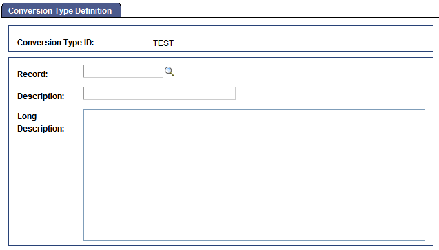

Access the Conversion Type Definition page.
To identify a database table whose values need to be converted:
Select
Enter a conversion type ID or search for an existing one.
You can also search for the record name.
Enter the record name of the table whose values you want to convert and enter a description.
You can enter a description in the Description text box, the large edit box, or both.
Save the page.
