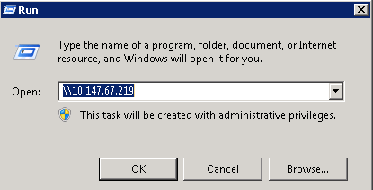

After you install and initialize the PI, you access a shared drive which makes the folders from the image accessible to the host (Microsoft Window OS).
From Windows Explorer access the virtual appliance file system from your Microsoft Windows host by selecting Start, Run, and entering the Microsoft Windows UNC path containing your virtual machine IP address.
Image: Microsoft Windows Run dialog box with IP address
This example illustrates the fields and controls on the Microsoft Windows Run dialog box with IP address.

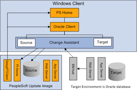

If your target database is on Oracle database and PeopleTools 8.55, you will have 1 PS Home and 1 Oracle client.
Image: Target Environment on Oracle Database
This diagram illustrates the relationship between the Microsoft Windows client running Change Assistant and the PI when your target database platform is Oracle.

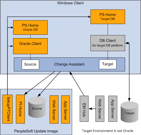

When the target environment is not on Oracle database, you will always have 2 PS Homes and 2 database clients (one for Oracle and one for the target database platform). The PS Home for the PUM Source database will be on PeopleTools 8.55 and the Target PS Home will be on the same release as the target database.
Image: Target Environment Not on Oracle Database
This diagram illustrates the relationship between the Microsoft Windows client running Change Assistant and the PI when your target database is not Oracle.
