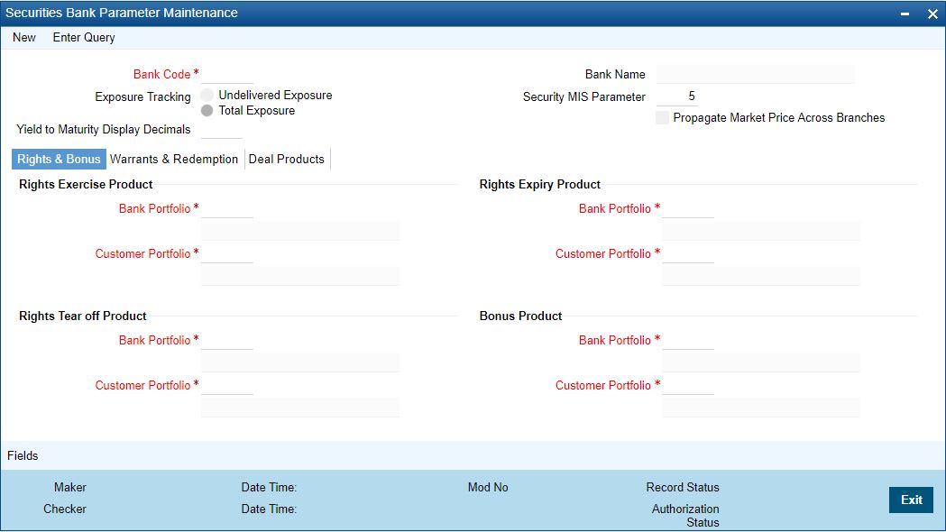

4.2.1 Maintain Bank Parameters
This topic describes the systematic procedure to maintain bank parameters:
Context:
In the Securities Bank Parameters screen, you can maintain certain basic information regarding the processing of Auto Deals.
1.On Homepage, specify SEDXBNPM in the text box, and click next arrow.
Step Result:   Securities Bank Parameter Maintenance screen is displayed.
Figure 4.1: Securities Bank Parameters Maintenance
2.On Securities Bank Parameter Maintenance screen, specify the fields.
For more information about the fields, refer to 4.2.2 Maintain Deal Product.
If you are calling a record that has already been created, click on the Summary view. From the Summary screen, you can open an existing record. Highlight the record you wish to view and double click on it. The details of the bank parameter record will be displayed in a tabular form.
Table 4.1: Securities Bank Parameter Maintenance
Field
Description
Security MIS Parameter
In Oracle Banking Treasury Management, a maximum of 10 transaction classes is maintained for security and portfolio.
By specifying the security MIS parameter, you can indicate how the MIS transaction classes for a security position (Portfolio plus Security combination), is built from the respective transaction classes of the security and portfolio.
The number that you enter in this field denotes the number of MIS transaction classes of the security that should be picked up, to determine the MIS transaction of the security position.
Year to Month Display Decimals
The YTM values, which you can view through the Yield to Maturity details sub-screen of the Deal Online screen, are rounded off to the number of decimal places that you specify on this screen.
Indicate the deal combination product code, which should be picked up, in case of declaration of one of the following:
Rights
Tear-off
Expiry
Expiry
Bonus
Warrants
Tear-off
Exercise
Redemption
Deal combination product codes are maintained in the Deal Combination Product definition screen. All the product codes defined on that screen will be reflected in the pick list available.
The attributes defined for a particular deal combination product will be inherited by the auto dealer to which it is linked. The parameters maintained in this screen are applicable across the bank.

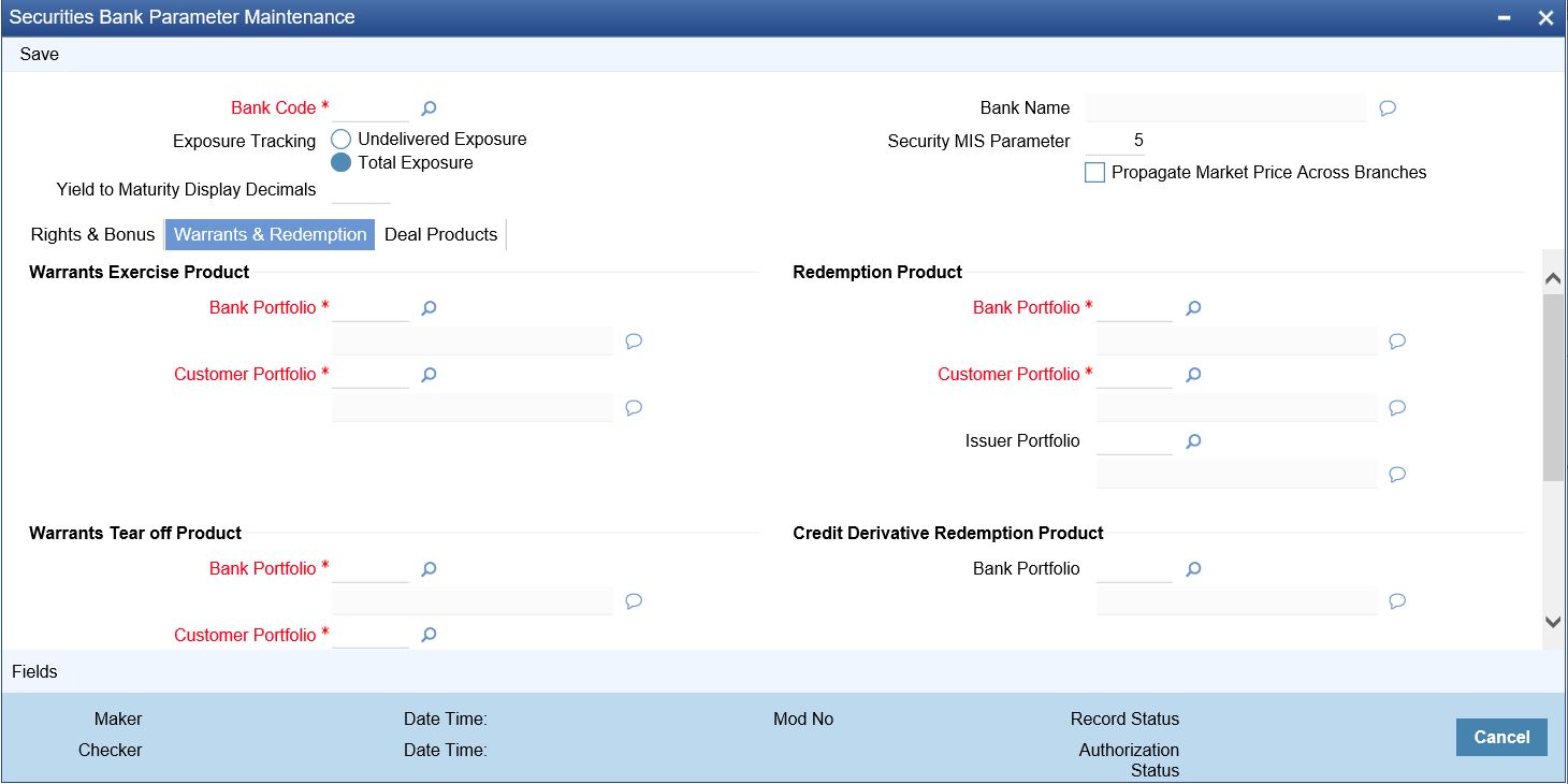

3.On the Securities Bank Parameter Maintenance screen, click Warrants and Redemption.
Step Result:   Securities Bank Parameter Maintenance - with Warrants and Redemption screen is displayed.
Figure 4.2: Securities Bank Parameter Maintenance
4.On the Warrants & Redemption tab screen, specify the details as required.
For information on fields, see the below table
Table 4.2: Warrants & Redemption- Field Description
Field
Description
Bank Portfolio
Select the portfolio details from the drop-down list as required.
note: Only the combination where both the buy product and sell product from Credit Derivative Deal Product Definition screen are populated in LOV.

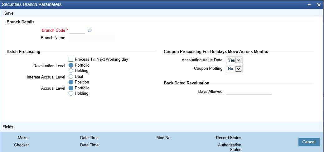

4.3 Branch Parameters
This topic contains the following sub-topic:
1)Define Branch Parameters
4.3.1 Define Branch Parameters
This topic describes the systematic instruction to define branch parameters.
Context:
A set of rules that governs the processing of securities in a particular branch of your bank is defined in the Branch Parameters screen.
Prerequisite:
Specify User Id and Password, and login to Homepage.
1.On Homepage, specify SEDXBRPM in the text box, and click the next arrow.
Step Result:   Securities Branch Parameters screen is displayed.
Figure 4.3: Securities Branch Parameters
2.On Securities Branch Parameters screen and click Exit.
For more information on fields, refer to the Table 4.3: Securities Branch Parameters - Field Description
The events, for which you had indicated automatic processing, are triggered off during the Batch Process. You can specify preferences for the automatic events that fall on a holiday, in the Branch Parameters screen.

Batch process Parameter
You have the option to specify when the batch process, must process automatic events falling due on a holiday. It could be either:
As part of the EOD on the last working date before the holiday.
As part of the BOD process on the next working day after the holiday
Revaluation Level
Revaluation entries can be passed at the portfolio level or the holding level.
Portfolio: At the portfolio level, revaluation entries will be passed for the portfolio and currency combination.
Holding: At the holdings, level entries will be passed for the net hold­ings for a portfolio, and security across SK locations and SK location accounts.
For example,
PF1 - SE01
PF1 - SE02
PF1 - SE03
The security currency for SE01, SE02 and SE03 is USD. The security currency for SE04 is GBP.
If you indicate that revaluation should be passed at the holdings level, entries will be passes exclusively for the following combinations:
PF1 + SE01
PF1 + SE02
PF1 + SE03
PF1 + SE04
If you specify that entries should be passed at the portfolio level, then the revaluation entries will be made in the following manner:
PF1 + SE01 + SE02 + SE03
PF1 + SE04
Refer the Maintaining a Portfolio Preference class chapter of this User Manual for more details.
note: If you indicate that revaluation should be performed at the Holdings level, you have the option of selecting between Deal level revaluation and Position level revaluation while defining a portfolio.
Specifying the Accrual level
Portfolio: At the portfolio level, accruals will be passed for the portfolio and currency combination.
Holding: At the holdings, level entries will be passed for net holdings of a portfolio and security across SK locations and SK location accounts.
Interest Accrual level
You can opt to accrue interest at a position level or at a deal level.
Position: At the position level, accrual happens for a combination of security and portfolio
Deal Matching: Deal level interest accrual is done for every individual buy deal for the same combination of security and portfolio
Interest accrual at deal level is for Bank Portfolios only.

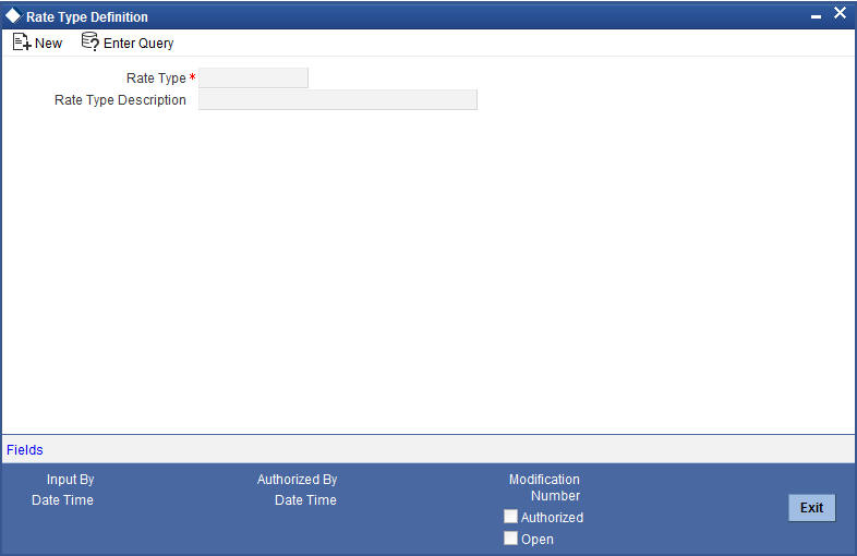

4.6 Define Rate Type
This topic describes about the systematic instructions to define rate type.
Prerequisite:
Specify User ID and Password, and login to Homescreen.
1.On Homescreen, specify CFDRTTYP in the text box, and click next arrow.
Step Result:   Define Rate screen is displayed.
Figure 4.6: Rate Type Definition
2.On rate Type Definition specify the fields.
Table 4.14: Rate Type Definition
Field
Description
Rate Type
Specify a unique code to identify the rate type you wish to maintain. The code cannot exceed
10 characters.
Description
Enter a brief description for the rate type.

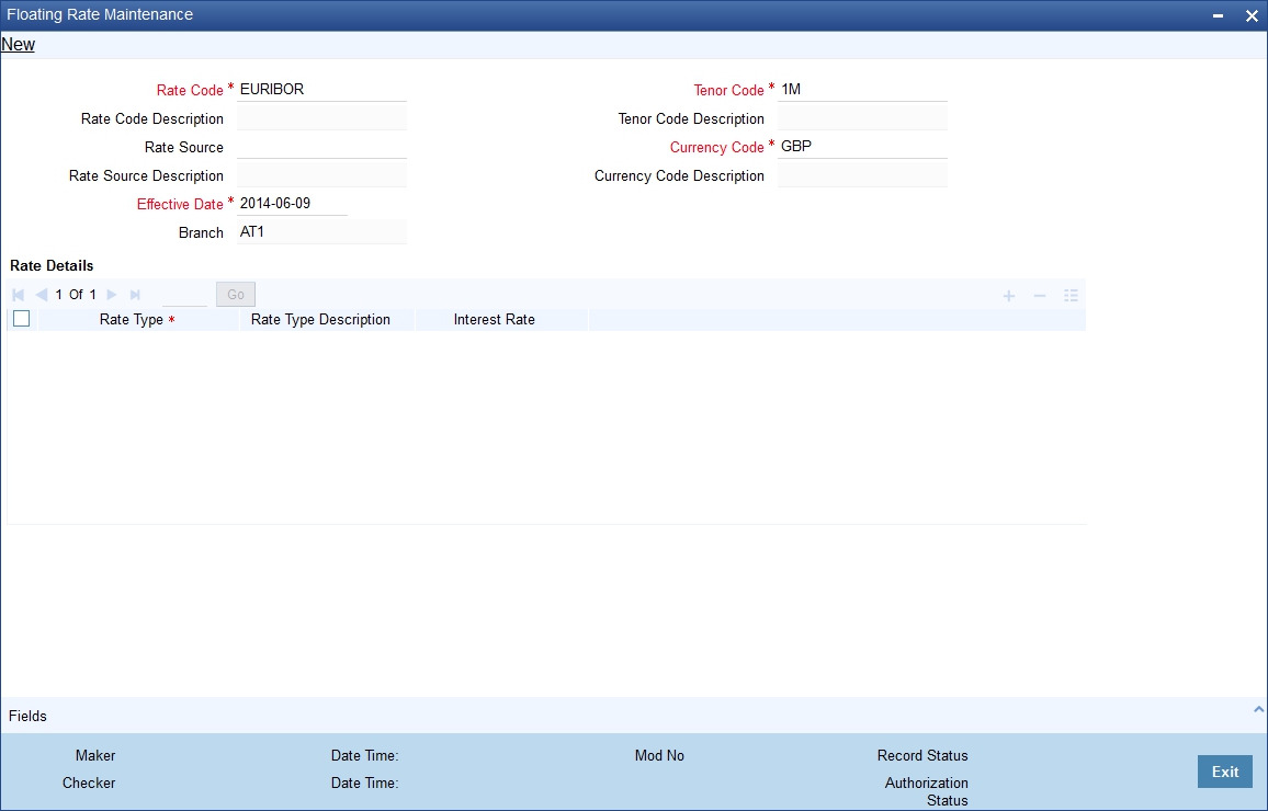

4.7 Define Float Rates
This topic describes the systematic procedure to define float rates.
Prerequisite:
1.On Homescreen, specify CFDFLRAT in the text box and click next arrow.
Step Result:   Floating Rate Maintenance screen is displayed.
Figure 4.7: Floating Rate Maintenance
2.On Floating Rate Maintenance screen, specify the fields.
For more information about the fields, refer to Table 4.15: Floating Rate Maintenance.
Field
Description
Rate Code
Select the Appropriate Rate Code from the List of Values Available.
Rate Source
Select the Appropriate Rate Source from the List of Values Available.
Tenor Code
Select the Tenor Code created as part of Rate Code Maintenance from the List of Values Available.
Currency Code
Select the Currency Code from the List of Values Available for which the Interest Rates are to be maintained.
Rate Details
Update the Interest Rate by adding the required rate types maintained and providing the Interest rates about the particular rate type selected.

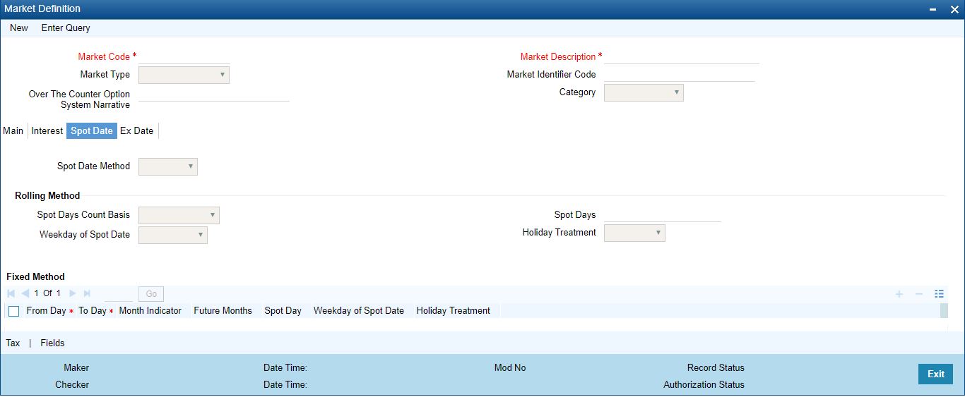

5.On Market Definition screen, click Spot Date.
Step Result:   Spot Date tab is displayed.
Figure 4.9: Spot Date Tab
6.On Spot Date tab, specify the details.
In this section, indicate the method by which Spot Date is calculated. Spot date is calculated to keep a track of deal settlements. You can click on the respective tab to go to this section of the screen.
There are two methods for calculating the spot-date. It can be calculated as a certain number of days from the trade date of the security. It can also be fixed for a market place for a specific range of trade dates.
Table 4.17: Spot Date - Field Description
Field
Description
Rolling
If the spot date calculation method indicated is rolling, then you can specify the spot day count basis.
Spot Day Count Basis
There are two options available for this field:
Calendar days – spot days will be expressed as calendar days
Working days - spot days will be expressed as working days
Weekday of Spot Date
Indicate your preference of weekday for the spot date, if you have specified the calculation method as rolling.
If the weekday of the spot date computed is different from the preferred weekday then, the spot date computed will be moved forward to the preferred weekday.
Holiday Treatment
Once you indicate a preferred weekday for the spot date, it is required to specify the holiday treatment for the preferred weekday. If you choose to ignore this option, the spot date will be retained on the holiday. If not, as specified by you, it will be moved forward to the next working day or moved back to the previous working day.
When the spot day method specified is Fixed, indicate the details relating to the range of trade dates and the corresponding spot date for each slab. You also have to specify whether the spot date lies in the current month or a future month. You can select the relevant option from the pick-list available for the month indicator.
7.On Market Definition Screen, click Ex Date
Step Result:   Market Definition Ex-Date tab is displayed.
8.On Ex Date tab, specify the fields.
There are different methods for calculating the ex date. It can be calculated as a certain number of ex days, prior to the next coupon date of the security or it can be fixed for a market place for a specific period.
Table 4.18: Ex Date - Field Description
Field
Description
Expiry Date Method
If the expiry date calculation method indicated, is rolling then you can specify the expiry date count basis.
Expiry Days Count Basis
express the expiry days as calendar days or as weekdays.
Weekday of Expiry Date
Specify your preference for the weekday for the ex-date. The concept of weekday, of the ex-date and the holiday treatment, is the same as that of Spot date.
Fixed Method
If the ex-date specified is fixed, then maintain certain mandatory details such as the From and To dates, the month indicator, and the holiday treatment. The information that you maintain here, is similar to the information entered for the spot date. This is so only if the spot date method specified, is fixed. However, in such a case, the ex-date will be before the event date.

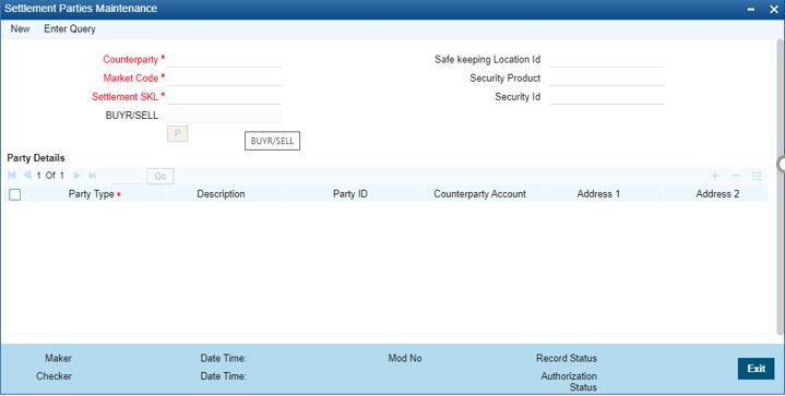

4.12 Maintain Settlement Parties
This topic describes about the systematic instructions to maintain deal settlement parties.
Prerequisite:
1.On Homescreen, specify SEDSPRTY in the text box, and click next arrow.
Step Result:   Maintain Settlement Parties screen is displayed.
Figure 4.10: Settlement Parties Maintenance
2.On Settlement Parties Maintenance specify the fields.
For more information on the fields, refer Table 4.19: Settlement Parties Maintenance - Field Description
Field
Description
Counterparty
Specify a counterparty from the adjoining option list. The list displays all valid counterparties maintained in the system. You can choose the appropriate one.
Market Code
Specify a market code from the adjoining option list. The list displays all valid market codes maintained in the system. You can choose the appropriate one.
Safe Keeping Location ID
Specify the safe keeping location ID from the adjoining option list. The list displays all valid location IDs maintained in the system. You can select an appropriate one.
Security Product
Select the security product from the adjoining option list. All the valid security products maintained in the system are displayed here. You can select an appropriate one.
Settlement SKL
The system defaults the place of settlement. However, you can specify the settlement SKL from the adjoining option list.
Security Id
Specify the security ID from the adjoining option list. All the valid security IDs maintained in the system are displayed here. You can select an appropriate one.
P button
Click the ‘P’ populate button. The system sets the BUYRSELL field. It displays the Counterparty BIC code or Address Line 1 to Address Line 4 if the BIC is not maintained for the counterparty.
BUYR/SELL
The system displays the BUY or SELL field
Party Details
Party Type
Specify the party type from the adjoining option list. The list displays all valid party types maintained in the system. You can choose the appropriate one.
Counterparty Account
Specify the counterparty account number.
Address1
Specify the address line 1 for the selected Party ID.
Address2
Specify the address line2 for the selected Party ID.
Address3
Specify the address line 3 for the selected Party ID.
Address4
Specify the address line 4 for the selected Party ID.
During creation of Security deal, the system defaults the values from ‘Deal Settlement Parties Maintenance’ in the ‘Parties’ tab of Securities Deal Input screen from the Parties maintenance done for the combination of counterparty and Market code.
The party details are defaulted to the Bank leg of the Deal (i.e. BB or BS).
BB – SELL, DEAG, PSET
BS –BUYR, REAG, PSET
The system gets the BIC or address for the counterparty from customer leg and sets the BUYR or SELL record.
3.The settlement party maintenance are defaulted in Parties tab for the Bank Leg. You can capture the values if there is no maintenance available.
4.You can amend the defaulted settlement parties maintenance in Parties tab before authorization of the Secu­rity Deal.
5.The system performs the following validations in this screen:
On selection of the Party ID for Party type ‘DEAG’, the system defaults the BIC code of the Party ID or Address Line 1 to Address Line 4 if the BIC is not maintained for the Party ID (coun­terparty).
You cannot edit the fields Address Line 1 to Address Line 4 from ‘Party Details’ grid if any one value is set from BIC or CIF.
The system allows you to modify the fields Address Line 1 to Address Line 4 from ‘Party Details’ grid if Party ID is not selected. The value specified for Address Line 1 should satisfy BIC code validation.
The system validates when neither Party ID nor Address Line 1 field is specified on save of the record.

With every market place that you define, you can associate a Tax scheme. When you specify the market code, at the time of defining security, the details of the tax scheme associated with the market code are automatically asso­ciated with the security.
note: At the market definition level, you can only maintain the Issuer tax details. You can, however, change these details at the security definition level.
To invoke this screen, click the Tax button in the Market Definition screen. The Tax Definition screen will be displayed.
