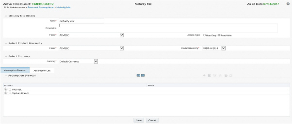

Figure 1:   Maturity Mix Details page to Create a New Maturity Mix Rule
This illustration shows the Maturity Mix window that allows you to create a new Maturity Mix rule. Enter the rule name and description, and select the product hierarchy and currency. From the Assumption Browser tab, select the product using the corresponding check box and click Add +. Click Save. You will be navigated to the Maturity Mix Details page.
Description of Maturity Mix Details page to Create a New Maturity Mix Rule as follows
NOTE
In addition to the standard steps for Creating Rules, the procedure for creating a Maturity Mix Rule involves one extra step. After Standard Step, you need to select a product hierarchy. For more information, see the Overview of Common Rule Management Tasks section. You can define methodologies at any level of the hierarchical product dimension. The hierarchical relationship between nodes allows the inheritance of methodologies from parent nodes to child nodes.
 Oracle Asset Liability Management provides you with the option to copy, in total or selectively, the product assumptions contained within ALM business Rules from one currency to another cur­rency, a set of currencies, from one product to another product, or a set of products.

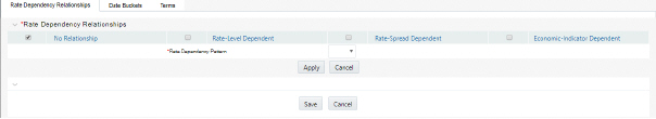

4.     Select Rate Dependency.
a.     Select the Rate Dependency Relationships tab and enter de-tails as shown in the following table.
Figure 2:   Rate Dependency Relationship Tab of the Maturity Mix Rule
This illustration shows the Rate Dependency Relationship tab of the Maturity Mix window that allows you to select the rate dependency pattern for Ma-turity Mix rule. You must enter the parameter details and click Apply. See the following table for parameter details.
Description of Rate Dependency Relationship Tab of the Maturity Mix Rule as follows
Table 1:  Fields of Rate Dependency Relationship Tab to Create a New Maturity Mix Rule
Fields
Description
There are four Rate Dependency options to select:
·        No Relationship
·        Rate-Level Dependent
·        Rate-Spread Dependent
·        Economic-Indicator Dependent
If any Rate Dependency option other than No Relationship, is selected, the Rate Dependency Pattern drop-down list becomes active. The list of available patterns is limited to those which apply to the selected Rate Dependency Relationship Type.
b.     Click Apply.

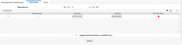

5.     Define Maturity Mix assumption bucket ranges
a.     Select Date Buckets tab. The Maturity Mix Date Bucket selection window is displayed.
b.     Click Add Row to select the number of Maturity Mix Date ranges that are required during the forecast period. The Bucket Number field is used to calculate the Start and End dates. The Bucket Number field determines which Income Simulation Bucket is used to calculate these dates.
The Maturity Mix Rule uses the modeling period defined in the Active Time Bucket Rule. Verify that your modeling horizon and related assumptions are consistent with the As of Date and Active Time Bucket Rule before processing.
c.     Enter details as shown in the following table:
Figure 3:   Date Buckets Tab of Maturity Mix Rule Details page
This illustration shows the Terms tab of the Maturity Mix Rule window to de-fine the Term parameters for selected rate tier. You must enter the param-eter details and click Apply. See the following table for parameter details.
Description of Date Buckets Tab of the Maturity Mix Rule as follows
Table 2:  Fields of Date Buckets tab to create a new Maturity Mix Rule
Fields
Description
Rate Tiers
Rate Tiers reflect the Rate Dependency Pattern details from the selected Rate Dependency Pattern. Define Maturity Mix assumptions for each rate tier. The application will automatically determine which set of assumptions to apply for a given scenario based on the relationship between the Rate Tier and the related Forecast Rate assumption value.
Bucket Number
The Bucket Number allows you to select a range of buckets over which the Maturity Mix assumptions will apply. Start Date and End Date values are updated automatically based on the Bucket Number input for each row.
When the Maturity Mix Detail page opens, the Start Date (min value) and End Date (max value) columns are automatically populated and are read-only values. The date ranges represent the Income Simulation Date Buckets as defined in the Active Time Bucket Rule. See Time Buckets for more information. Any new business originated within these dates is modeled using the Maturity Terms defined in the Maturity Mix Rule.
The Start Date value in the first row is always set equal to the first modeling date, that is the As Of Date plus 1 day, and the End Date value in the last row always equals the last day of the modeling horizon as defined in the Active Time Bucket Rule.
Apply Defined Buckets to all Rate Tiers
This option allows you to copy the bucket setup from one page to all other Rate Tiers when using Rate Dependent assumptions.
d.     Click Define.

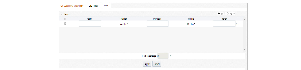

6.     Enter Maturity Mix Assumption details.
a.     Select the Terms tab.
This tab allows you to define the Maturity Term details. You can assign one or more Maturity Terms within the details page, but the sum of the percentage weights must be equal to 100%.
b.     Enter Attribute details as shown in the following table:
Figure 4:   Terms Tab of Maturity Mix Rule Details page
Description of Terms Tab of the Maturity Mix Rule as follows
Table 3:   Form Fields of Terms Tab to Create a New Maturity Mix Rule
Fields
Description
Maturity
Defines the Maturity Term.
Multiplier
Maturity multiplier (that is, days, months, years).
Amortization
The Amortization Term will default to the maturity term. The Amortization Term should always be greater than or equal to the maturity term.
Multiplier
Amortization multiplier (that is, days, months, years).
Percent
The percentage of new business at the specified term and maturity for the associated date bucket.
For each Date Bucket defined, the maturity terms must be specified.
c.     Click Apply.
