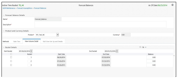

1.     Select the New Volume Detail tab.
2.     Select the modeling bucket start and end range. The default Bucket Range includes all modeling buckets. To forecast new business in a subset of the modeling horizon, reduce the bucket range by increasing the bucket start date or decreasing the bucket end date. As you change the bucket start and/or the bucket end, the view adjusts accordingly to display only buckets within the selected range.
3.     Select corresponding row to the first modeling bucket. If rate-volume relationships are used, this cell also corresponds to the first rate tier. Input the targeted value. For New Add, Target End, and Target average, input an amount. For Target Growth, input a percent. The percent should represent the percentage growth within the modeling bucket. It should not represent an annual­ized amount.
4.     You can also use the Excel import/export feature to add the New Volume Detail information.

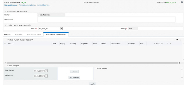

Rollover Setup and Details Tab
In the Rollover Setup and Details tab, first input the setup details necessary for definition of rollover percentages (source product leaves and bucket ranges), second, input rollover percentages. The roll­over percentages represent the percent of the runoff amount from the source (leaf and runoff type for the selected currency) which generates new business into the target leaf for the selected currency. An example of the Rollover Setup and Details tab appears as shown in the following figure:
Description of Rollover Setup and Details Tab in Forecast Balance Rule Definition page as follows
1.     Click the Rollover Setup and Details tab to display the page.
2.     Click the Add icon to select the Product Runoff Type Selection.
3.     The Hierarchy page will appear. Select the product leaf members for the rollover and click Ok.
4.     The selected products will appear below the Product Runoff Type selection bar.
5.     Choose the desired runoff type (Total, Prepay, Maturity, Payment, Core, Volatile, Devolvement, Recovery, or NPA).
6.     Define the input bucket ranges. You only need to define multiple bucket ranges if you want to vary rollover assumptions by modeling buckets. The bucket ranges defined here only apply to rollover occurring from the source leaf to the target leaf. You must have at least one bucket range defined. Typically, you define a bucket range from the first modeling bucket to the last modeling bucket, covering the entire modeling horizon. To define a bucket range, complete the following steps:
·        Select a start bucket date for the first date range.

7.     The Rollover Bucket Range Details form will appear at the bottom.
To define the details for the above prescribed bucket ranges, do the following:
·        Select a bucket from the drop-down list of defined bucket ranges.
NOTE
The defaulted values for runoff type are populated.
§       Enter the percentage rollover for the given products.
§       You can also use the Excel Import/Export feature to add the Rollover Bucket Range Detail information.
§       Click Apply.

7.     Select Rate-level dependent as the Rate-Volume relationship. The completed Method informa­tion should appear as shown in the following example:
8.     Click the Rate Tiers Tab.
9.     Select a Rate Dependency Pattern from the drop-down list.
10.  Click the New Volume Detail Tab. The two lookup methods for 1% and 4% will appear in the col­umns, next to each bucket. Enter 8% growth for a 1% 3 year rate environment, and 2% growth for a 4% 3 year rate environment.

9.     Click the Rollover Setup and details tab.
10.  Click the Add icon to add desired products in Product Runoff Type Selection.
Choose Total, Prepay, Maturity, or Prepayment runoff.
11.  Define the bucket range. (In this case the entire bucket range). Click “Add” to create the range.
12.  Click Apply. The rollover Bucket Details Bar will appear at the bottom of the page.
13.  Input the desired rollover for each rate spread scenario. In this case it is the steepening spread between 6 month and 5 yr Libor curve points.
14.  Click Apply.
