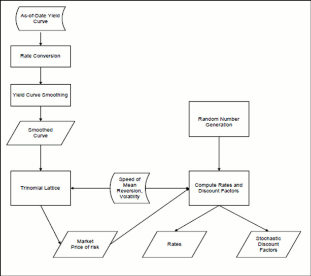

The no-arbitrage models (Ho and Lee and Extended Vasicek) are designed to fit the current term structure of interest rates exactly. This is achieved when the price of a zero-coupon bond computed through the Monte Carlo process exactly matches today's observable market rates, as defined by the risk-free curve selection. The market price of risk is a function of time that takes care of this fit.
To adhere to this condition, the process flow for no-arbitrage models is more complicated. A trinomial lattice is used to compute the market price of risk to calibrate the term structure. The full original As-of-Date yield curve is used, smoothed and converted to continuous compounding, to be fed into the lattice.
Description of process flow for Vasicek (or Merton) follows
Today's yield curve from an OFSAA Rate Management IRC might not have enough terms for a term structure model to give the best rates forecast. In particular, the trinomial lattice needs the value of the yield for every month. To do this, two smoothing techniques have been introduced into the Rate Generator: Cubic Spline and Linear Interpolation.
Hull and White have shown how trinomial trees (lattice) can be used to value interest rate derivatives. The goal of the trinomial lattice is to compute the market price of risk for all buckets for the Ho and Lee or Extended Vasicek (no-arbitrage) term structure models.
Hull and White's lattice is a popular methodology to calibrate a term structure model. The lattice is constructed for up to 360 monthly buckets, from bucket zero to either (the last maturity on the IRC + 15 years) or 30 years, whichever is shorter.

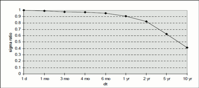

We introduced two timescales, the normal timescale, and the equal-month timescale, to satisfy three requirements:
· Monthly buckets have to be an integer number of days in length because the cash flow engine works on a daily timescale.
· Performance should generate rates with an equal-month timescale.
· We cannot set the bucket length to be 30 days, because buckets will start 5 days earlier each year, and this conflicts with reporting requirements.
The equal-month timescale is used only internally in the Rate Generator. It assumes that each month is constant and is equal to 1/12 of a year. The normal timescale counts the actual number of days, that is, each monthly bucket has a different length. In other words, the normal timescale assumes an Actual/Actual day count basis, whereas the equal-month timescale assumes a 30/360 count basis. The convention is the regular Oracle ALM convention for a month: if bucket zero starts on day n then all next buckets start on day n except when this day does not exist (February 30 for instance), in which case it reverts to the last existing day of the month (for example, February 28).
There is a one-to-one relationship between the timescales.

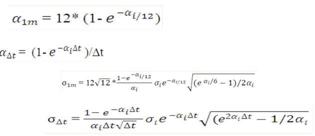

In this example, the discrete yield (quoted Actual/Actual) is constant. However, the 2-month smoothed yield is lower than the 1 month smoothed yield because the timescale transformation overestimates the length of the second month.
The Monte Carlo process requires annually compounded Actual/Actual zero-coupon yields as the input. If the input IRC format is different from that, a rate conversion process is applied.
Also, the Rate Generator converts rates from the yield curves (which are discretely compounded, on the normal timescale) into continuously compounded rates on the equal-month timescale. This conversion has to be done for all the points in today's yield curve.

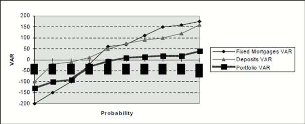

The system will also output VaR at the portfolio level (into the FSI_O_STOCH_ TOT_VAR table). In this example, we assume that our portfolio has only deposits and fixed mortgages.

As you can see from the following graph, the total VaR does not necessarily equal the sum of the VaR for each portfolio because of the correlation between mortgages and deposits.
Description of graph for Output From Monte Carlo follows

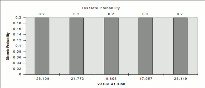

The discrete probability of a gain of exactly -$26,408, -$24,733, $8,808, $17,957, $23,149 is 20% for a 5 scenarios simulation.
NOTE |
The sum of all probabilities adds up to a total of 100% probability. |
Description of graph of discrete probability follows

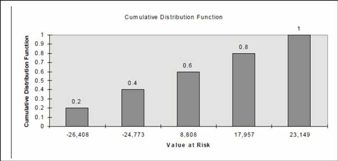

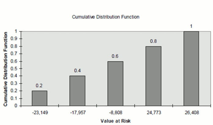

In Value at Risk interpretation, we need to convert the discrete probability to a cumulative distribution function. For example, we know that there is a chance of a gain of -$26,408 with a probability of 20% and a gain of -$24,773 with a probability of 20%. This means that there is a 40% probability of gain less than or equal to -$24,773. This comes from adding a 20% discrete probability from the gain of $-26,408 and a 20% discrete probability from a gain of -$24,773.
Description of graph of cumulative distribution function follows

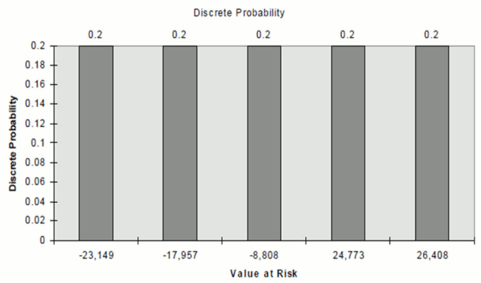

When we apply the signage to liability, the discrete probability is undisturbed for each event.
NOTE |
Each event still has a discrete probability of 20% |
We see here that there is a 20% probability of a maximum loss of -$23,149. There is a 40% probability of a maximum loss of -$23,149 (20% discrete probability from -$23,149 plus 20% discrete probability from -$17,957).

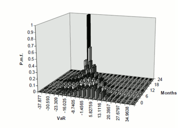

This example tries to give intuition behind the numbers by varying the At-Risk period for a typical case. The instrument we analyze is a two-year discount bond with a principal of $100. The market value is $78.
To ease comprehension of the graph, we display the probability mass function and not the cumulative probability distribution.
Description of graph of probability mass function follows
This graph reflects two important features of a fixed-rate instrument:
· On average, VaR decreases with time because the dynamic present value increases with time.
· The dispersion of VaR goes to zero when approaching maturity.

As mentioned in the preceding sections, speed of mean reversion, volatility, and long-run rate are the parameters the user will have to specify for the chosen model. Speed of Mean Reversion represents the long-run drift factor (1/mean reversion = interest rate cycle). Volatility is the standard deviation of the one-month rate, annually compounded on the equal-month timescale. Long Run Rate (b) represents the equilibrium value of the one-month rate, annually compounded.
Sometimes α and σ are available from external sources, but they are quoted differently. The following equations show how to obtain the “one-month” speed of mean reversion and volatility from the values of α and s corresponding to:
instantaneous rate, αi(αi and σi hereafter)
rate with term ∆t years (α ∆t and σ∆t hereafter)
(For clarity we write α1m and α1m for the one-month parameters)
Description of formula to calculate the Term Structure Parameters Format follows
The following graph shows the change in the ratio σ1m/ σivarying Dt (αi = 0.1):
Description of graph of change in the ratio σ1m/ σivarying Dt (αi = 0.1) follows
Though the decision on the best choice for the term structure parameters is left to the user, the software imposes certain restrictions on those as follows:
