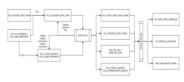

Below figure shows the ALM data flow:
Description of ALM Data Flow as follows

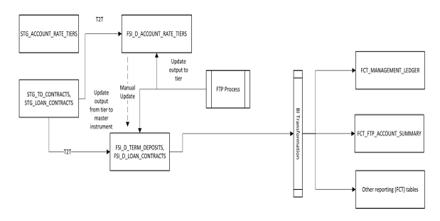

Below figure shows the FTP data flow:
Description of FTP Data Flow as follows

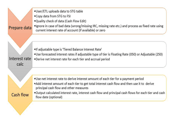

Description of Tiered balance interest rate Process Flow as follows

Transfer Rates and TP Adjustment Rates
The FTP application will run directly against the FSI_D_ACCOUNT_RATE_TIERS table and will treat each tier record as an independent instrument record. Transfer Rates and TP Adjustment rates will be calculated based on the details of each rate tier record. Aggregation of tier level results and posting back to the parent record is not yet supported but can be handled by a custom procedure.
