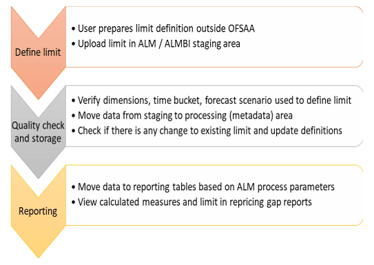

Functional Flow
The following flow explains about how to define a limit, perform the quality check, and move the data for reporting purpose.
Description of process flow of Limit function follows
