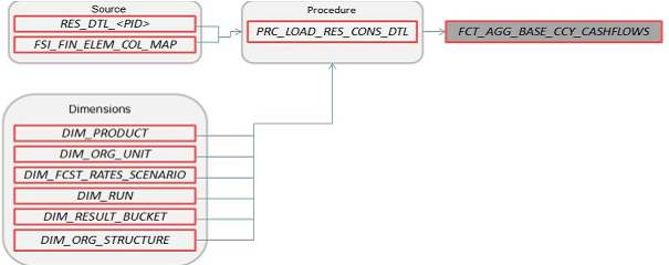

·        FCT_AGG_BASE_CCY_CASHFLOWS
Description of FCT_AGG_BASE_CCY_CASHFLOWS follows
Where, RES_DTL_<Process ID> contains the standard (base currency) cash flow output for all current position and forecast balances, across all forecast rate scenarios.

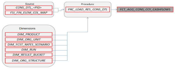

·        FCT_AGG_CONS_CCY_CASHFLOWS
Description of FCT_AGG_CONS_CCY_CASHFLOWS follows
Where, CONS_DTL_<Process ID> contains standard (consolidated to reporting currency) cash flow output for all current position and forecast balances, across all forecast rate scenarios.

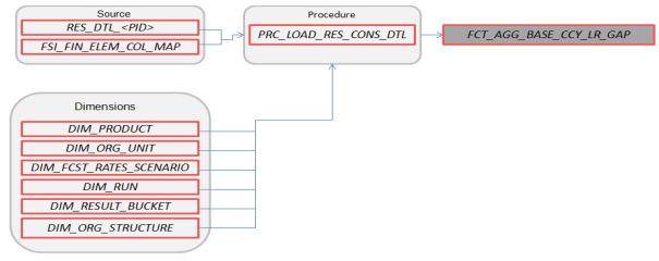

·        FCT_AGG_BASE_CCY_LR_GAP
Description of FCT_AGG_BASE_CCY_LR_GAP follows
Where, RES_DTL_<Process ID> contains Liquidity Gap Financial Element (base currency) cash flow output for all current position balances, across all forecast rate scenarios.

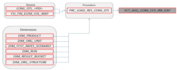

·        FCT_AGG_CONS_CCY_IRR_GAP
Description of FCT_AGG_CONS_CCY_IRR_GAP follows
Where, CONS_DTL_<Process ID> contains Repricing Gap Financial Element (consolidated to reporting currency) cash flow output for all current position balances, across all forecast rate scenarios.

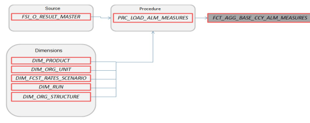

·        FCT_AGG_BASE_CCY_ALM_MEASURES
Description of FCT_AGG_BASE_CCY_ALM_MEASURES follows
Where, FSI_O_RESULT_MASTER contains Market Value, Duration, and Convexity information (base currency) for all current position balances, across all forecast rate scenarios.

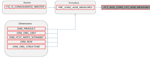

·        FCT_AGG_CONS_CCY_ALM_MEASURES
Description of FCT_AGG_CONS_CCY_ALM_MEASURES follows
Where, FSI_O_CONSOLIDATED_MASTER contains Market Value, Duration, and Convexity information (consolidated to reporting currency) for all current position balances, across all forecast rate scenarios.

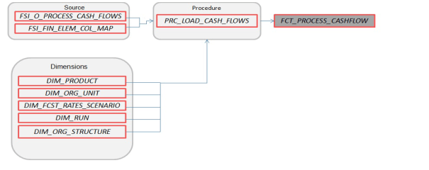

·        FCT_PROCESS_CASHFLOW
Description of FCT_PROCESS_CASHFLOW follows
Where, FSI_O_PROCESS_CASH_FLOWS contains account level detailed cash flow information for the number of instrument records selected on the Audit block of the ALM Process.
Note: Here, FCT_COMMON_ACCOUNT_SUMMARY is a pre-requisite for FCT_PROCESS_CASHFLOW. To run the Cash flow successfully, first load the table FCT_COMMON_ACCOUNT_SUMMARY(PK) and then FCT_PRCESS_CASHFLOW(FK). There is a Referential Integrity (PK-FK) between these two tables which should be satisfied.

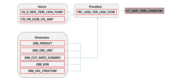

·         FCT_RATE_TIERS_CASHFLOW
Description of FCT_RATE_TIERS_CASHFLOW follows

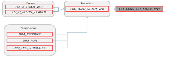

·        FCT_CONS_CCY_STOCH_VAR
Description of FCT_CONS_CCY_STOCH_VAR follows
Where, FSI_O_STOCH_VAR contains Value at Risk information (in Consolidated Currency) for each Monte Carlo rate path at the Product COA level.

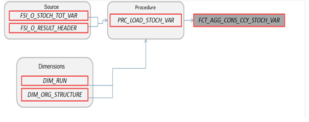

·        FCT_AGG_CONS_CCY_STOCH_VAR
Description of FCT_AGG_CONS_CCY_STOCH_VAR follows
Where, FSI_O_STOCH_TOT_VAR contains Value at Risk information (in Consolidated Currency) for each Monte Carlo rate path at the Portfolio level.

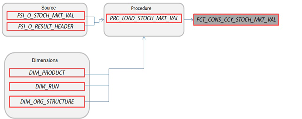

·        FCT_CONS_CCY_STOCH_MKT_VAL
Description of FCT_CONS_CCY_STOCH_MKT_VAL follows
Where, FSI_O_STOCH_MKT_VAL contains Market Value information (in Consolidated Currency) for each Monte Carlo rate path at the Product COA level.

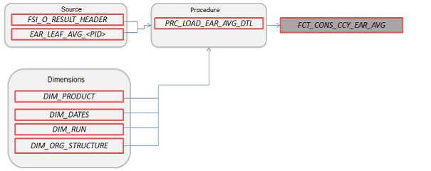

·        FCT_CONS_CCY_EAR_AVG
Description of FCT_CONS_CCY_EAR_AVG follows
Where, EAR_LEAF_AVG_<Process ID> contains the average Earnings at Risk information (in Consolidated Currency) across all Monte Carlo rate paths at the Product COA level.

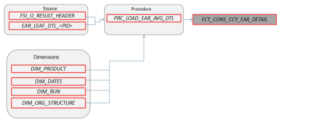

·        FCT_CONS_CCY_EAR_DETAIL
Description of FCT_CONS_CCY_EAR_DETAIL follows
Where, AR_LEAF_DTL_<Process ID> contains Earnings at Risk information (in Consolidated Currency) for each Monte Carlo rate path at the Product COA level.

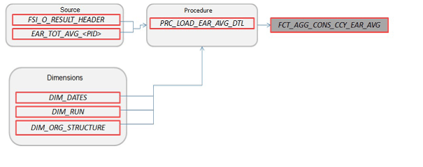

·        FCT_AGG_CONS_CCY_EAR_AVG
Description of FCT_AGG_CONS_CCY_EAR_AVG follows
Where, EAR_TOT_AVG_<Process ID> contains average Earnings at Risk information (in Consolidated Currency) across all Monte Carlo rate paths at the Portfolio level (net interest income - net interest expense).

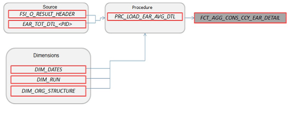

·        FCT_AGG_CONS_CCY_EAR_DETAIL
Description of FCT_AGG_CONS_CCY_EAR_DETAIL follows
Where, EAR_TOT_DTL_<PID> contains Earnings at Risk information (in Consolidated Currency) for each Monte Carlo rate path at the Portfolio level (net interest income – net interest expense).

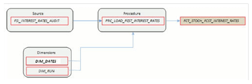

·        FCT_STOCH_FCST_INTEREST_RATES
Description of FCT_STOCH_FCST_INTEREST_RATES follows
Where, FCT_STOCH_FCST_INTEREST_RATES contains 1M forward rates output from the Monte Carlo process for each scenario, typically used for Audit purposes.

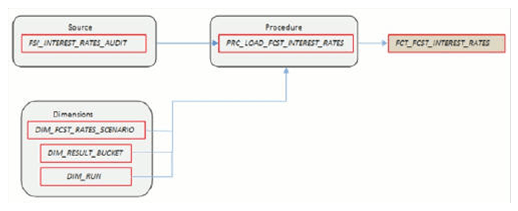

·        FCT_FCST_INTEREST_RATES
Description of FCT_FCST_INTEREST_RATES follows
Where, FCT_FCST_INTEREST_RATES contains forecast interest rates for each ALM Deterministic Process, for each scenario.

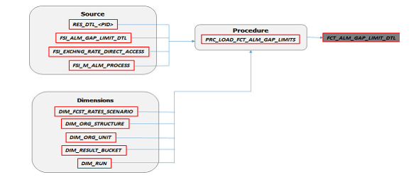

·        FCT_ALM_GAP_LIMIT_DTL
Description of FCT_ALM_GAP_LIMIT_DTL follows
Where, FCT_ALM_GAP_LIMIT_DTL contains a repricing gap limit for each ALM process and for each scenario.
