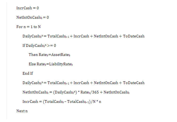

1. At the end of each modeling bucket, taxes and dividends will be computed on the net income and net taxable income and paid out of cash.
The calculation of interest earned or paid out from the cash account must first be simulated, because this value also impacts the net income.
The first step is to derive an initial cash amount for every bucket end date, equal to Cash Balanceb plus Net Incomeb. Let's call this amount Total Cashb. Total Cash0, is equal to the starting cash amount, is equal to just the Cash Balance0. In addition to this variable, there are four additional variables.
· Total Cashb is the initial cash amount for every bucket end date, equal to Cash Balanceb plus Net Incomeb. Total Cash0, equal to the starting cash amount, is equal to just the Cash Balance0. This amount does not include adjustments for interest on the cash account or taxes and dividends paid out of the cash account.
· Daily Cashbn is the Daily cash balance for day n in each modeling bucket b. The variable n designates the day into the modeling bucket, for example, n = 1 is the modeling bucket start date.
· Net Interest On Cashb is the total interest earned over the modeling bucket b on the cash account.
· Incremental Cash is the incremental additional cash added due to changes in activity on the balance sheet. Because this value is reset for every modeling bucket, it does not require a b subscript.
· To Date, Cash is a running total of cash added from processing the cash account in previous modeling buckets. Because this value is a running total for all modeling buckets, it also does not require a b subscript.
· Rateb is the forecasted interest rate for the interest rate code associated with the Auto-balancing Asset or Liability account for the current modeling bucket and scenario. Note that the sign of the current balance will determine whether the interest rate code for the auto-balancing asset or the auto-balancing liability account should be used.
For each modeling bucket, interest can be calculated as follows:
N = number of days in the current modeling bucket
Description of formula to calculate the interest for each modeling bucket follows
After processing of cash account, taxes and dividends must be calculated and deducted from the cash account before calculation of the final cash balance.
StateTaxesb = StateTaxRateb * (NetTaxIncb + NetIntOnCashb)
FedTaxesb = FedTaxRateb * (NetTaxIncb + NetIntOnCashb )
Dividendsb = DivAmountb + DivRateb * (NetIncb + NetIntOnCashb )
The To Date additional cash must be adjusted for the start of processing of the next modeling bucket:
ToDateCash = ToDateCash + NetIntOnCashb - StateTaxesb - FedTaxesb - Dividendsb
The Ending Balance of the current modeling bucket must be adjusted for the cash paid out for taxes and dividends
DailyCashbN= DailyCashbN - StateTaxesb - FedTaxesb - Dividendsb
