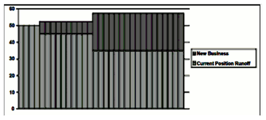

New Business from Rollover
To model new business generated from rollover, the new business should be booked on the date the principal run-off occurs. A new record would be created on each date principal run-off occurs during the modeling period, as shown in the following figure:
Figure 4: Roll-over (150% of Principal Runoff)
Description of graph of Roll-over (150% of Principal Runoff) follows
Ending Balance = $57.50
Average Balance= ($50*4 days + $52.50*10 days + $57.50*17 days)/31 days
                                                                                     = $54.9193

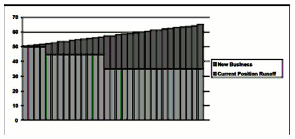

New Originations
For new originations, users could make several assumptions about the timing. For instance, they could assume that it occurs at a single date within the bucket, that it occurs evenly over the bucket, or that it accelerates over the bucket. For our purposes, we are assuming that new originations are booked evenly over the modeling bucket; the balance will grow gradually over the modeling period.
For new originations, the booking of new accounts is done in a manner that best approximates the user's assumptions about the timing of new business over the bucket. In the case of even bookings over the bucket, the balance in the account appears graphically as a straight, positively sloped line. To match this assumption in the model, a new business record must be generated for each day in the bucket, as shown in the following figure:
Figure 5: New Originations (30% Growth)
Description of graph of New Originations (30% Growth) follows
Figure 6: Average Date Roll-over Method
Description of graph of Average Date Roll-over Method
Ending Balance = $65
Average Balance = ($50 + $65)/ 2 = $57.50
Description of Average Balance formula follows

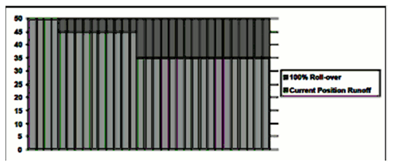

Rollover Accounts
For rollover accounts, the area under the curve is a function of the timing of runoff and the amount of principal runoff. By calculating an average day of run-off, the area under the new business curve can be matched by generating new bookings on the average date, as shown in the following figure:
Figure 7: Flat Balance Sheet
Description of graph of Flat Balance Sheet
Average day of runoff         = ($5 * 5 days + $10 * 15 days)/$15 = 11 2/3 days
Balance Plug:                                                          1/3 * $15* 1.5 = $7.50 on the 11th
                                 2/3 * $15* 1.5 = $15 on the 12th
Average Balance=($50 * 4 days + $45 * 6 days + $52.50 * 1 day + $67.50 * 3 days + $57.50 * 17 days)/ 31 = 54.9193

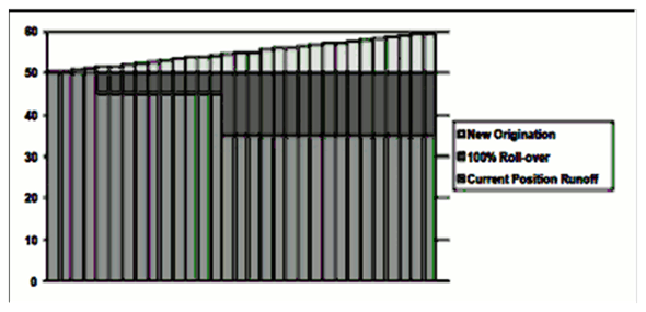

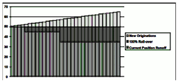

For new originations, the area under the curve is a function of the targeted change in the balance over the bucket, the timing of the runoff of the current position at the start of the bucket, and the amount of principal runoff.
This can be broken into two components:
A component of a new business that assumes a flat balance sheet. This is equal to 100% roll-over, as shown in the above figure.
The new origination component, which can be viewed as a gradually increasing balance over the flat balance sheet, as shown in the following figure.
Figure 8: New Originations Separated by Components
Description of graph of New Originations Separated by Components follows

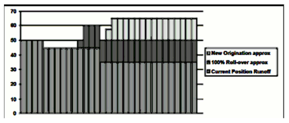

New Business is approximated by splitting the new business into the two components: the average day roll-over method displayed in example 3 to account for the 100% roll-over component of new business plus an additional method to account for the new originations.
That is because, the shape of the new originations curve is a triangle, the area of this shape can be calculated as
1/2 days in the bucket * new origination balance.
The same area can be achieved by booking the entire balance at the mid-point of the bucket. Because, in this case, the mid-point of the bucket falls between two days, the balance should be spread evenly over those two days: $7.50 on the 15th and $7.50 on the 16th, as shown in following figure.
Figure 9: New Origination Average Date Method
Description of graph of New Origination Average Date Method follows
Average Balance = $50 * 4 days + $45 * 6 days + $50 * 1 day + $60 * 3 days + $50.00 *1 day + 57.50 * 1 day + 65 * 15 days = $57.50

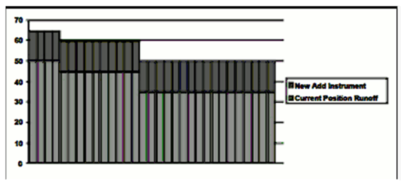

Current Target Average Approach
In the current target average approach, a new business instrument is booked on the first day of the bucket so that the average of this instrument plus the average of the current position will equal the targeted average balance.
The problem with this approach is that the results are not always logical to an end-user because they do not follow the business logic of new business generated throughout the bucket. In the case represented in the following figure, the user has targeted an average balance of $55 from a starting balance of $50. The logical assumption would be that the balance grows over the bucket from $50 to a final value greater than the average. However, in this case, the ending balance is $49.84, lower than the beginning balance. Although the average balance is correct, the ending balance makes no sense.
Figure 10: Current Average Balance Method
Description of graph of Current Average Balance Method
A more appropriate method would be to assume a gradual booking over the month to generate the average balance. In this case, an approach similar to the target end method could be used, where both average date and mid-bucket methods are used as shown in the following figure.
