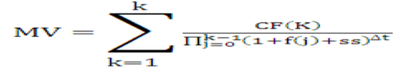

Neither the static spread nor the OAS can be defined directly as they are solutions of two different equations. We give hereafter a simplified version of the equations that the system solves, using the assumptions described earlier. The static spread is the value ss that solves the following equation:
Equation 1
Title: Description of the Static Spread formula follows - Description: The illustration shows the formula to calculate the Static Spread.
Description of the Transfer Pricing Option Cost Equation 1 follows
Where:
:MV
market, or book, or par value of the instrument (as selected in the Transfer Pricing rule)
CF(k)
cash flow occurring at the end of month k along with the forward rate scenario
:f(j)
forward rate for month j
∆t
length (in years) of the compounding period; hard-coded to a month, such as 1/12

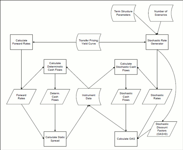

Process Flow
Process Flow
In this section we describe only the following steps:
·        Calculate forward rates
·        Calculate static spread
·        Calculate OAS
The other steps are described later.

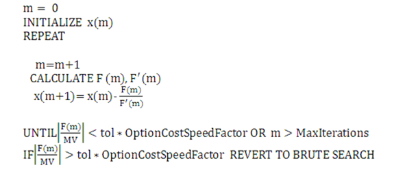

For convenience, we recap hereafter Newton's algorithm. Let x be the static spread. At each iteration m we define the function F(m) by the following equation:
Equation 8
Description of the Transfer Pricing Option Cost Equation 8 follows
The algorithm is:

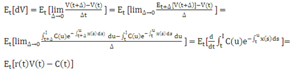

and expectation is taken concerning the risk-neutral measure. The expected change in value is given by:
Equation 14
Description of the Transfer Pricing Option Cost Equation 14 follows
The variation in value is therefore equal to the expected value of the change dV plus the change in the value of a martingale M in the risk-neutral measure:

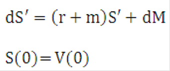

In other terms, the expected future value of the portfolio is equal to the expected future value of the money market account adjusted by the correlation between the standard money market account and the relative risk. Assuming complete and efficient markets, banks can fully hedge their balance sheet against this relative risk, which should be neglected to calculate the contribution of a particular portfolio to the profitability of the balance sheet. Therefore,
Equation 24
Description of the Transfer Pricing Option Cost Equation 24 follows
Equation 25
Description of the Transfer Pricing Option Cost Equation 25 follows
In this example, the risk-adjusted rate of return of the bank on its portfolio is equal to the risk-free rate of return.
Let us suppose now that another instrument offers cash flows
C'>C
Assuming complete and efficient markets its market value will then be:
Equation 26
Description of the Transfer Pricing Option Cost Equation 26 follows
The value of the corresponding portfolio is denoted by
S'>S
By analogy with the previous development, we have:
Equation 27
Description of the Transfer Pricing Option Cost Equation 27 follows
Again, the risk-adjusted rate of return of the bank on its portfolio is equal to the risk-free rate of return. Suppose now that markets are not complete and inefficient. The bank pays the value V(0) and receives cash flows equal to C'. We have:
Equation 28
Description of the Transfer Pricing Option Cost Equation 28 follows
By definition of the total risk-adjusted return, we have:
Equation 29
Description of the Transfer Pricing Option Cost Equation 29 follows
Therefore, by analogy with the previous development,
Equation 30
Description of the Transfer Pricing Option Cost Equation 30 follows
This can be decomposed into
Equation 31
Description of the Transfer Pricing Option Cost Equation 31 follows
Equation 32
Description of the Transfer Pricing Option Cost Equation 32 follows
Equation 33
Description of the Transfer Pricing Option Cost Equation 33 follows
The solution of Equation 31 and Equation 33 is:
Equation 34
Description of solution for the Transfer Pricing Option Cost Equation 31 and 33 follows
By the law of large numbers, Equation 31 and Equation33 result in:
Equation 35
Description of the Transfer Pricing Option Cost Equation 35 follows

Model Usage Hints
Non-Unicity of the Static Spread
In some very rare cases, there is more than one value that solves the static spread equation. This section describes one of these cases.
The market value of the instrument is $0.445495. It has 2 cash flows. The following table shows the value of the cash flows and corresponding discount factors (assuming a static spread of zero).
Cash flows and corresponding discount factors
aa
Firstevent
Secondevent
Time
1
2
Cash flow value
1
-0.505025
Discount factor(static spread=0)
0.9
0.8
The continuously compounded static spread solves the following equation:
Equation 42
Description of the Transfer Pricing Option Cost Equation 42 follows
There are two possible solutions for the static spread:
static spread =0.19%
static spread =1.81$
Accuracy
In case you desire a better numerical precision than the default precision, you can take two actions:
·        Decrease the speed factor (see the section Calculate Static Spread).
·        Increase the number of Monte Carlo scenarios.
Both actions increase calculation time.
