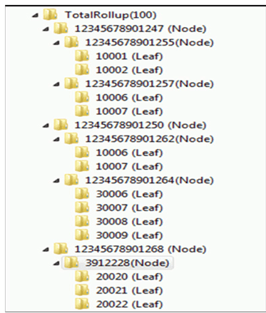

Populating STG_<DIMENSION>_HIER_INTF Table
The STG_<DIMENSION>_HIER_INTF table is designed to hold hierarchy structure. The hierarchy structure is maintained by storing the parent child relationship in the table. In the following hierarchy there are 4 levels. The first level node is 100, which is the Total Rollup. The Total Rollup node will have the N_PARENT_DISPLAY_CODE and N_CHILD_DISPLAY_CODE as the same.
Column Name
Column Description
V_HIERARCHY_OBJECT_NAME
Stores the name of the hierarchy
Stores the parent Display Code
Stores the child Display Code
N_DISPLAY_ORDER_NUM
Determines the order in which the structure (nodes, leaves) of the hierarchy should be displayed. This is used by the UI while displaying the hierarchy. There is no validation to check if the values in the column are in proper sequence.
V_CREATED_BY
Stores the created by user. Hard coded as -1
V_LAST_MODIFIED_BY
Stores the last modified by user. Hard coded as -1
Hierarchy Structure

Simple Data
"This table describes the sample data.
N_DISPLAY_ORDER_NUM
V_CREATED_BY
V_LAST_MODIFIED_BY
INCOME STMT
100
100
1
-1
-1
INCOME STMT
100
12345678901247
2
-1
-1
INCOME STMT
12345678901247
12345678901255
1
-1
-1
INCOME STMT
12345678901255
10001
1
-1
-1
INCOME STMT
12345678901255
10002
2
-1
-1
INCOME STMT
12345678901247
12345678901257
2
-1
-1
INCOME STMT
12345678901257
10006
1
-1
-1
INCOME STMT
12345678901257
10007
2
-1
-1
INCOME STMT
100
12345678901250
3
-1
-1
INCOME STMT
12345678901250
12345678901262
2
-1
-1
INCOME STMT
12345678901262
30005
1
-1
-1
INCOME STMT
12345678901250
12345678901264
1
-1
-1
INCOME STMT
12345678901264
30006
1
-1
-1
INCOME STMT
12345678901264
30007
2
-1
-1
INCOME STMT
12345678901264
30008
3
-1
-1
INCOME STMT
12345678901264
30009
4
-1
-1
INCOME STMT
100
12345678901268
4
-1
-1
INCOME STMT
12345678901268
3912228
1
-1
-1
INCOME STMT
3912228
20020
1
-1
-1
INCOME STMT
3912228
20021
2
-1
-1
INCOME STMT
3912228
20022
3
-1
-1

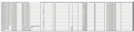

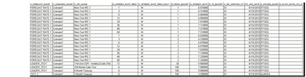

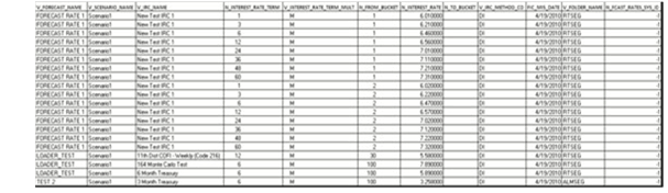

·        STG_FCAST_IRCS
STG_FCAST_IRCS Table
v_forecast_name
The Name of the Forecast Rate assumption rule as defined.
The Forecast name indicates the Short Description for the Forecast Rate Sys ID as stored in the FSI_M_OBJECT_DEFINITION_TL table. In case the forecast sys id is provided, then populate this field with -1.
v_scenario_name
This field indicates the Scenario Name for which the Forecast Rate data is applicable.

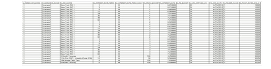

Sample Data for STG_FCAST_IRCS to Load all forecast rates defined within a folder
Description of STG_FCAST_IRCS follows
Sample Data for STG_FCAST_XRATES to Load all forecast rates defined within a folder
Description of STG_FCAST_XRATES follows
Sample Data for STG_FCAST_EI to Load all forecast rates defined within a folder
Description of STG_FCAST_EI follows

Sample Data for STG_FCAST_IRCS to load data for specific Forecast Rate providing the Forecast Rate System Identifier

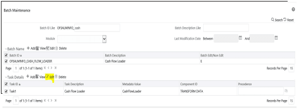

To execute Forecast Rate Loader from OFSAAI Batch Maintenance, a seeded Batch is provided.
<INFODOM>_FORECAST_RATE_LOADER is the Batch ID and Forecast Rate Loader is the description of the batch.
1.     The batch has a single task. Edit the task.

Sample Data for STG_FCAST_IRCS to load data for a specific Forecast Rate assumption rule, with the Forecast Rate System Identifier already provided

Sample Data for STG_FCAST_IRCS to Load a specific forecast rate assumption rule, within the Folder, provide the name of Forecast Rate rule as defined in ALM

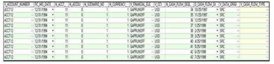

STG_ACCOUNT_CASH_FLOWS Sample Data
Instrument Cashflow Data
Continuation...
Instrument Cashflow DataInstrument Cashflow Data

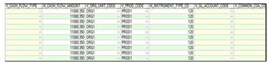

Aggregate Data Sample
Continuation...

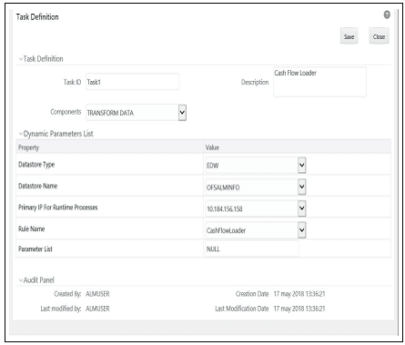

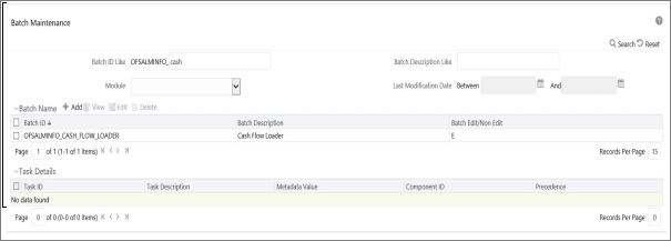

To execute the Cash Flow Loader from OFSAAI Batch Maintenance, a seeded Batch is provided.
Execution Steps
1.     Select <INFODOM>_CASH_FLOW_LOADER as the Batch ID and Cash Flow Loader is the description of the batch.
Batch Maintenance
Description of Batch Maintenance window follows
2.     The batch has a single task. Edit the task.
Task Definition window
Description of Task Definition window follows
3.     If the user wants to load all the process ids given in the FSI_CASH_FLOW_LOADER_SETUP table for the given as of date, then Process_id parameter should be null.
4.     Specify the following parameters:
§       Data store Type:  Select appropriate data store from list
§       Data store Name:  Select appropriate name from the list
§       IP address:  Select the IP address from the list
§       Rule Name:  CashFlowLoader
5.     If the user wants to process the specific process id mentioned in the FSI_CASH_FLOW_LOADER_SETUP table for the given as of date, then the process_id parameter should be given.
6.     Specify the following parameters:
7.     Save the batch
8.     Execute the Batch defined for the required As of Date.
