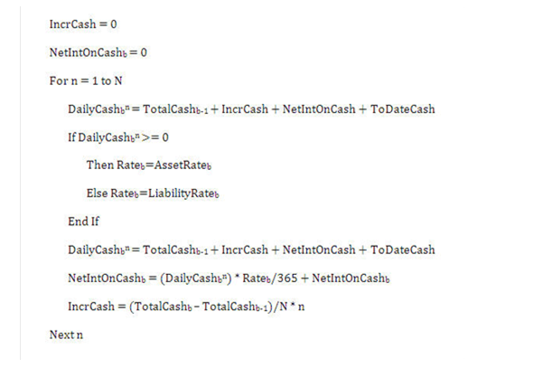

·        Rateb is the forecasted interest rate for the interest rate code associated with the Auto-balancing Asset or Liability account for the current modeling bucket and scenario. Note that the sign of the current balance will determine whether the interest rate code for the auto-balancing asset or the auto-balancing liability account should be used.
For each modeling bucket, interest can be calculated as follows:
N = number of days in the current modeling bucket
Description of  formula to calculate the interest for each modeling bucket follows
