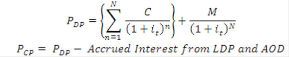

·        Firstly, the underlying bond has to be priced for the given 'As of Date'.
Description of PCP Formula follows
Where,
it= Interest rate at time t
C = F * c = coupon payment
Where, F = Face Value of the bond
c = Coupon rate
N = number of payments
M = maturity value of the bond
PCP= Clean price of the bond
PDP= dirty price of the bond
LDP = Last Payment Date
AOD = As of Date

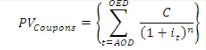

·        Calculate the present value of the coupon payments during the life of the option. ( Coupon payments between the As of Date and the Option Expiry Date(OED))
formula to calculate the PDP
 Description of formula to calculate the PDP
