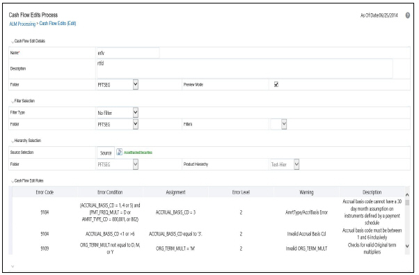

Creating a Cash Flow Edit process is a one-step process. You define both the attributes that uniquely describe a particular Cash Flow Edit process and the data to be validated or cleansed by that process on the Create Cash Flow Edit process page.

1. Navigate to the Cash Flow Edits Summary page.
2. Click Add button.
The Create Cash Flow Edits Process page is displayed.
3. Complete standard steps for this procedure. For more information, see Creating Rules section.
Note At this point, you can input the components to ensure that the data processed by Cash Flow Edits will be clean. If you save the Rule without selecting Instrument tables or selecting product members from the hierarchy, the Process will be saved but no data would be selected for cleansing. |
4. (Optional) Select a Filter.
5. Select the Instrument tables or use a hierarchy to make Product member selections.
Note Use the Source Selection: Shuttle Control to select the Instrument tables that you want to include in the Cash Flow Edit process. You can move Instrument tables from Available Tables into Selected Tables and vice versa by using Move, Move All, Remove, and Remove All. These tables can also be reordered to change the order of processing. Initially, the selected tables list is empty. However, during subsequent runs, the selected tables list retains the names of the tables that you selected previously. For example, if you select two tables and save the Cash Flow Edits Process, the system shows them the next time you open the rule. A table name shown in the Selected Tables list does not appear in the Available Tables. |
6. Click Save.
The Cash Flow Edits process is saved and the summary page is displayed.
