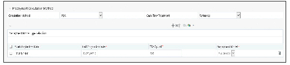

4.    Specify the Arctangent Argument table parameters.
5.    Select the Start Origination Date using the date picker. Alternatively, you can enter the Start Origination Date in the space provided.
6.    Enter the values for the Arctangent parameters (columns K1 through K4) for each Start Origination Date in the table. The valid range for each parameter is -99.9999 to 99.9999.
7.    Click Add Another Row to add additional rows and click the corresponding Delete to delete a row.
You can add as many rows in this table as you require. However you need to enter relevant parameters for each new row.
