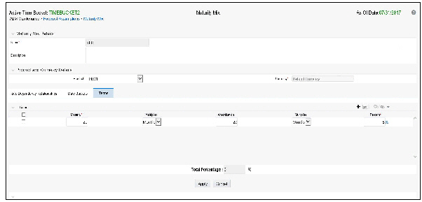

Maturity Mix Details Screen
The Maturity Mix details screen allows you to define the maturity mix details. You can assign one or more maturity terms within the details page, but the sum of the percentage weights must equal 100%.
Maturity: Maturity (= term)
Multiplier: Maturity multiplier (= days, months, years)
Amortization: The amortization term will default to the maturity term. The amortization term should always be greater than or equal to the maturity term.
Multiplier: Amortization multiplier (= days, months, years)
Percent: The percentage of new business at the specified term and maturity for the associated date bucket.
For each Date Bucket defined, the maturity terms must be specified.

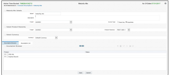

Defining a Maturity Mix Rule: An Example
1.     Define a Maturity Mix rule using a Rate Dependency Pattern.
2.     From the Assumption Browser, select Currency (US Dollar) and a product from the hierarchy browser.
3.     Select the “Add New” icon to enter the Assumption Details page.
4.     Select the Rate Level Dependent – Rate Dependency option.
5.     Select the Rate Level – Rate Dependency Pattern from the drop list.
6.     Select Apply to navigate to the Date Buckets Tab.
7.     Add bucket ranges to the page as needed. Optionally, select the “Apply Defined Buckets to All Rate Tiers” checkbox to copy the bucket structure across all rate tier pages.

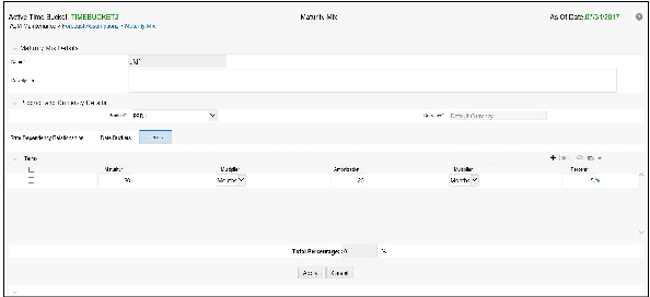

8.     Select the check box for the first bucket range and select “Define” to navigate to the Terms tab.
9.     Add one or more rows based on the number of maturity terms needed for the selected product.
10.   Input Maturity Terms, Amortization Terms and Percentage Weights for each row and select Apply to save your inputs for the selected bucket range. Notice the status column on the Date Buckets tab turns from Red to Green, indicating that you have successfully defined assumptions for the bucket range.
11.   Continue to define Maturity Mix assumptions for each Bucket Range.
12.   You can also use the Excel import/export feature to add the maturity information in the Terms tab.
13.   Select Apply to commit your assumptions for each Rate Tier. Repeat the process for each rate tier. After you have defined assumptions for all Rate Tiers, you will return automatically to the Assumption Browser page.
Note
You can select more than one product at a time from the Assumption Browser page.
14.   When Maturity Mix assumptions are defined for all required product / currency combinations, select SAVE from the Assumption Browser page.
