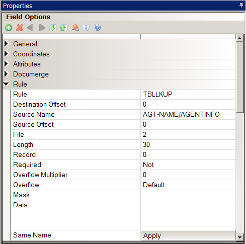

Specify the source file you want the system to search in the File field by entering a number that represents the position of the file in the list. For instance, if you want a field to look something up in the AGENTINFO.TBL file, you would enter two (2) in the File field.
| Note | The Record property is not part of the XDD layout. If you leave the File property equal to zero (0), the system uses the table index value in the XDD. |
Here is an example:
