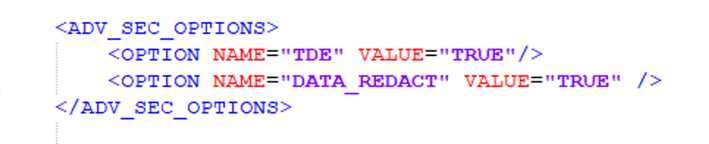

Table 24: OFS_IBCE_SCHEMA_IN.xml file (Advance Security Parameters)
Tag Name / Attribute Name |
Description |
Mandatory (Y / N) |
Default Value / Permissible Value |
Comments |
<ADV_SEC_OPTIONS>/ |
Parent tag to hold Advance Security Options. |
N |
NA |
Uncomment the tag and edit if you want to add security options. For example, TDE and Data Redact. For details, see the example following the rows. |
<ADV_SEC_OPTIONS>/TDE |
Tag to enable/disable TDE feature. |
N |
Default value is FALSE. To enable TDE, set this value to TRUE. |
Ensure this tag is not commented if you have uncommented <ADV_SEC_OPTIONS>. |
<ADV_SEC_OPTIONS>/DATA_REDACT |
Tag to enable/disable Data Redaction feature. |
N |
Default value is FALSE. To enable DATA_REDACT, set this value to TRUE. |
Ensure this tag is not commented if you have uncommented<ADV_SEC_OPTIONS>. |

Example: The following snippet shows that TDE is enabled and hence the tablespace is shown with encryption ON.
<ADV_SEC_OPTIONS>
<OPTION NAME="TDE" VALUE="FALSE"/>
<OPTION NAME="DATA_REDACT" VALUE="FALSE" />
</ADV_SEC_OPTIONS>
