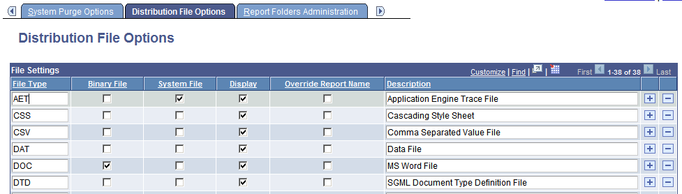

To access the Distribution File Options page, select PeopleTools > Process Scheduler > System Settings > Distribution File Options.
Image: Distribution File Options page
This example illustrates the fields and controls on the Distribution File Options page. You can find definitions for the fields and controls later on this page.
Use the Distribution File Options page to identify all the different types of files and the manner in which they are distributed throughout the system. File types are identified based on the file extensions. This is used by the Distribution Agent to determine how a specific file type will be transferred to the Report Repository using File Transfer Protocol (FTP) or HTTP. Also, this determines the description that is displayed in the Report Manager.
Use the Add and Delete buttons to add and remove available file types.
Field or Control
Definition
File Type
Identifies the type of file.
Binary File
Deselect for TXT and HTML files.
Note: When this check box is selected, the report distribution system will not perform a conversion on the file when moving it between operating systems.
System File
Select to mark this file type as a system file. The file will be available to be viewed in the Process Monitor regardless of output type.
Note: This feature requires that the Process Scheduler server definition has the attribute Transfer System Files to the Report Repository selected.
Display
Select to have the file shown on the report list page.
Description
Enter a description to be used for this file when it is displayed for viewing. If a description is not specified, the name of the file is used.

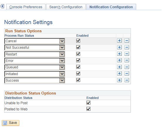

To enable Process Status Notifications, you must configure the Notification Settings page. You can enable some or all the states of a process to receive notification. These notification states are set for the notification channels — E-mail, Notification Window and Pop-up Notification.
Note: For pop-up notifications, if you configure settings under My Preferences > Pop-up Notification section, it will override the configurations set here. See Defining User Preferences.
Access the Notification Settings page (PeopleTools > Process Scheduler > System Settings > Notification Configuration).
Image: Notification Settings page
This example illustrates the fields and controls on the Notification Settings page. You can find definitions for the fields and controls later on this page.
Adding process run status in Notification Window Settings
Field or Control
Definition
Run Status Options
Enable the Run Status Options for which you wish to receive notifications. You can also add or delete states as per your requirement.
For more information about process request run status, see Viewing the Process List, “Process Request Run Status”.
Distribution Status Options
Select the Enabled check box for enabling notification for reports which may successfully post to the web or may not post to the web.
