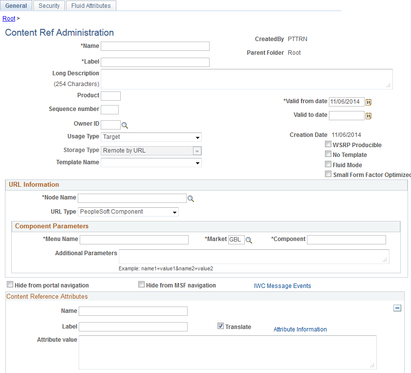

Access the Content Ref Administration page (PeopleTools > Portal > Structure and Content. Navigate the portal registry hierarchy until you are in the parent folder for the content reference; then click the link for an existing content reference or click the Add Content Reference link.)
Image: Content Ref Administration page
This example illustrates the fields and controls on the Content Ref Administration page. You can find definitions for the fields and controls later on this page.
Note: Many of the fields described in this section appear only when you enter certain field values.
Many of these fields are similar to fields on the Folder Administration page.
When you save a content reference that points to a PeopleSoft component or script on the default local node, the security settings for the content reference are inherited automatically from the menu or script security settings. Any permission lists or roles that you enter on the Content Reference Security page before saving the content reference are deleted and replaced by those of the component or script. These new security settings are also propagated up the folder hierarchy. This ensures that the content reference is visible and all folders are viewable, enabling users to navigate to the component.
Warning! Do not add internal component-based PeopleSoft content references using the Content Ref Administration page. Use the registration wizard instead so that information is consistent between Application Designer and the portal. Any changes made to the menu definition in Application Designer and not made to the portal content reference definition break the content reference. The portal navigation system uses the portal registry, not the internal location of menu definitions in Application Designer.
See Understanding the Registration Wizard.
This table describes the fields that appear on the Content Ref Administration page:

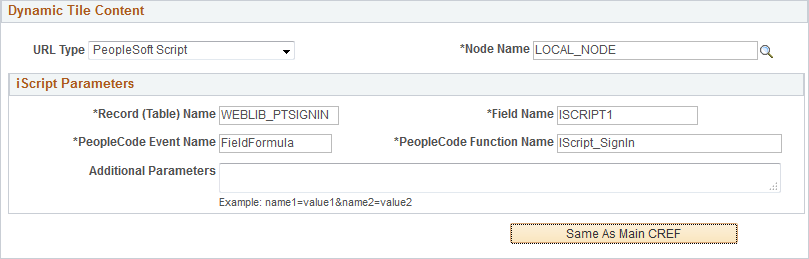

  • PeopleSoft Script: The iScript Parameters group box appears. Select the record (table) and field names, PeopleCode event name, and PeopleCode function name that specifies the iScript to use.

Defining the RELLINK Content Reference Attribute
To define a related link content reference attribute:
  1. Access the Content Ref Administration page (PeopleTools > Portal > Structure and Content. Navigate to the appropriate content reference; then click the Edit link.)
  2. Enter RELATEDLINKS_TEMPLATE in the Template Name field.
  3. In the Name field of the Content Reference Attributes region, enter RELLINK.
    After you enter this value and move out of the field, the Attribute Information link changes to Edit Related Links.
  4. Verify that the Translate check box is selected.
  5. Enter a label for the related links attribute.
Note: You do not need to enter any information in the Attribute Value field. After you create the related link group and the related links, the system populates this field with all defined attributes as a string.
Creating Related Link Groups
Access the Related Links Group (PORTAL_RLNK_ADM) page.
To create a related link group:
  1. In the Related Link Groups Label field, enter a name.
    This name is the heading under which you place related links.
  2. To create additional related link groups, click Add and repeat step 1.
Creating Related Links
To create a link:
  1. In the Related Links region on the Related Links Group (PORTAL_RLNK_ADM) page, enter a name in the Related Link URL Label field.
    This name appears as a link under the group name.
  2. If you're linking to an internal site, select a node name from the list.
    If you're linking to an external site, leave this field blank.
  3. In the Related Link URL field, enter URL information for the link.
    If the link is to an internal site, enter the URL or URI. The URL or URI can be to an internal site, to a portal, and so on. If you specified a value for the Portal URI Text field on the node definition, you can enter a specific document name as the target. The name is appended to the URI text for a full URL.
    If the link is to an external site, enter the URL.
  4. To define additional links for the group, click Add and repeat steps 2 and 3.
  5. Click OK to save the entry and return to the Content Ref Administration page.
    The Attribute Value field is populated with an XML-type formatted string. This string contains all the related link data and is stored in the PORTAL_ATTR_VAL field of the PSPRSMATTRVAL record for the content reference specified in the PORTAL_OBJNAME field. The following example shows a generated XML-type formatted string:

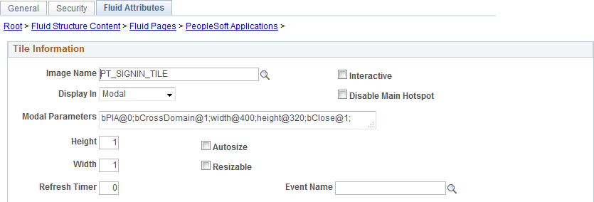

Access the Fluid Attributes page (Select PeopleTools > Portal > Structure and Content. Click the Edit link for a content reference; then select the Fluid Attributes tab.)
Image: Fluid Attributes page
This example illustrates the fields and controls on the Fluid Attributes page. You can find definitions for the fields and controls later on this page.
Tile Information
Use the Fluid Attributes page to configure the behavior and appearance of fluid content such as tiles, embedded related content, and related information. Certain fields pertain to tile definitions only while others pertain to all types of fluid content.
Field or Control
Definition
Image Name
Select an image (in SVG format only) from the database to display a custom static image as the fluid content. Otherwise the default image is displayed.
Note: When dynamic content is also configured for a tile, this static image is displayed only until the dynamic content is loaded.
Interactive
Select this option to display the fluid content as interactive, which allows users to enter data or click buttons within the fluid content. Since interactive fluid content require more resources than non-interactive ones, select this option only as needed.
Important! You must also set dynamic tile content for the fluid content to be interactive; otherwise, a static content is displayed. See the following sections for more information.
Important! While embedded related content can be defined as interactive, you should be aware of the limitations. See the section, “Limitations with Interactive Grouplets,” in Fluid Related Content for more information.
Display In
Control how the target transaction or content appears once a user taps the tile. Options are:
  • Cur Window: Target content appears in the current browser window.
  • Modal: Target content appears in a modal window.
  • NavBar: Target content appears in the NavBar.
    Note: This behavior applies only when the tile is added to the NavBar. If this is selected and the tile is added to a homepage or dashboard, the target content displays in the current browser window when tapped.
  • New Window: Target content appears in a new tab in the browser.
Disable Main Hotspot
Select this option to disable displaying the target content defined for the tile when the tile is tapped. However, any links displayed dynamically within the tile are not disabled.
Modal Parameters
Enter custom modal options. See Modal Options for more information.
Height
Set the height of the tile.
The default dimensions of a tile are 1 tile unit by 1 tile unit. Tiles up to 8x8 are supported. Note the following conditions and limitations with respect to the height and width of a tile:
  • A tile can never be larger than the width of the device. For example, if the width of a device is 2 in portrait mode, and 3 in landscape; the tile can only be maximum of width 2 on this device.
  • The valid size is checked only when the tile is initially loaded. If the device is rotated, or if the browser is resized, the tile is not resized.
  • Any tile sized larger than 2x2 is not guaranteed to display at the specified size depending on the device used to access the PeopleSoft system. For example, a 4x4 tile on a small form factor device in portrait mode would only show as a 2x3 tile.
  • Therefore, tiles larger than 2x2 need to implement variable sizing to accommodate different device sizes. Use large size tiles sparingly.
See the following section titled “Tile Height and Width” for a table of tile widths and heights from 1 to 8.
Width
Set the width of the tile.
Autosize
Select this option to allow the fluid content to dynamically resize itself based on the size of the content. Note the following conditions and limitations with respect to the autosize option:
  • The autosize option pertains to tiles and related information, but not to embedded related content.
  • The autosize option is best used on dashboards with few tiles. Be aware that layout changes can occur from the autosized content.
  • Autosize automatically accounts for resizing of the browser and rotation of the device.
  • The autosize and resizable options are mutually exclusive; both cannot be selected simultaneously.
  • The tile will not resize itself to larger than the dimensions of the device.
  • If the content is larger than the size of the tile, the tile will display scroll bars.
  • Due to the same-origin policy implemented by web browsers, for the autosize option to work with external content, the external content and the PeopleSoft application must either reside within the same domain or they must both set the document.domain property to the same value. Otherwise, the autosize option is ignored. For more information on how the domain and same-origin is determined, see Same-origin policy.
Resizable
Select this option to allow the tile to be redisplayed at the specified alternate dimensions. Note the following conditions and limitations with respect to the resizable option:
  • The resizable option is best used for tiles that can provide both a summary view and detailed view. When a tile is resized by a user, the content is refreshed to the show content that is optimized for the alternate size (and vice versa when the size is toggled back to the original size).
  • The state of the resize is not saved; therefore, whenever the user returns to the dashboard, the tile is displayed at its original size.
  • If the alternate size of the tile is the same as the original size (either by definition or by computation of the maximum size allowed by the device), no resize icon is displayed.
Alternate Height
Set the alternate height for a resizable tile.
Alternate Width
Set the alternate width for a resizable tile.
Refresh Timer
Enter the time in seconds to set an automatic refresh period for dynamic content on a tile. When the timer limit has been reached, the system re-draws the tile so that it displays the current data, such as in the case with chart.
The default value of 0 disables any automatic refresh.
Note: The system enforces a 10 second minimum limit. Any value entered less than 10 seconds is ignored and is treated as 10 seconds. When setting this value, be sure to monitor performance of the page refreshes and adjust accordingly.
Event Name
Select the event name to subscribe to a push notification event defined on the server. Subscribing to an event allows the tile content to be updated by the event.
See Understanding the Push Notification Framework and Defining Eventsfor more information on defining push notification events.
Dynamic Tile ContentURL Type
If you want the tile, embedded related content ,or related information to display dynamic content, select one of these options:
  • Non-PeopleSoft URL
  • PeopleSoft Component
  • PeopleSoft Generic URL
  • PeopleSoft Script
See the following sections for information on each option.
Selecting None results in the system displaying the selected static image or a default static image if no image is defined on the content reference.
Dynamic Tile ContentSame as Main CREF
Click the Same as Main CREF button to reset the dynamic content URL type and parameters to be the same as those already defined on the Content Ref Administration (General) page.
Important! For PeopleSoft components (and for PeopleSoft generic URLs starting with c/ which represent a component URL), the target content URL and the dynamic content URL are required to identify different components to prevent data integrity errors in the component buffer. When the target content (on the General page) is one of these two types, the Same as Main CREF button is not displayed. For the dynamic content, you must manually define a component different from the target component before you can save the content reference definition. See Limitations on Accessing a Component as a Grouplet and Then in a Standalone Manner for more information.

Dynamic Tile Content: Non-PeopleSoft URL
Use the Non-PeopleSoft URL type to display external content as dynamic fluid content.
Important! For the autosize option to work with external content, the external content and the PeopleSoft application must reside within the same domain. Otherwise, the autosize option is ignored.
Image: Dynamic Tile Content: Non-PeopleSoft URL
This example illustrates the fields and controls from the Dynamic Tile Content group box for a non-PeopleSoft URL. You can find definitions for the fields and controls later on this page.
Field or Control
Definition
Node Name
Optionally, enter a defined node name.
Portal URL
Enter the complete or partial URL in this field.
If you selected a defined node, then enter the partial URL here. The result is the concatenation of the selected node's URI text and the portal URL that you entered.
Dynamic Tile Content: PeopleSoft Component
Use the URL type of PeopleSoft Component to display a fluid component as dynamic fluid content.
Image: Dynamic Tile Content: PeopleSoft Component
This example illustrates the fields and controls from the Dynamic Tile Content group box for a PeopleSoft component. You can find definitions for the fields and controls later on this page.
Field or Control
Definition
Node Name
Enter the node for the target component.
Menu Name
Enter the menu for the target component.
Market
Select the market for the target component.
Component Name
Enter the name for the fluid component.
Page Name
Optionally, enter the fluid page name.
Note: Because multi-page components are not recommended as dynamic content, the page name is not required.
Grouplet ID
Enter the page field name as defined on the General tab of the group box definition. See Working with Group Boxes for more information.
Note: The grouplet ID is ignored when the definition is defined to be interactive; the entire component is rendered instead. For non-interactive definitions, if the grouplet ID is not specified, the entire page is rendered instead.
Additional Parameters
Enter any additional query string parameters to be appended onto the URL for the PeopleSoft component. For example, enter emplid=8001.
Dynamic Tile Content: PeopleSoft Generic URL
Use the PeopleSoft Generic URL type to display any PeopleSoft URL type as dynamic fluid content. The generic URL type can be used to define iScripts, worklists, and even component-based URLs.
Image: Dynamic Tile Content: PeopleSoft Generic URL
This example illustrates the fields and controls from the Dynamic Tile Content group box for a PeopleSoft generic URL. You can find definitions for the fields and controls later on this page.
Field or Control
Definition
Node Name
Portal URL
Dynamic Tile Content: PeopleSoft Script
Use the PeopleSoft Script type to display a PeopleSoft iScript as dynamic fluid content.
Image: Dynamic Tile Content: PeopleSoft Script
This example illustrates the fields and controls from the Dynamic Tile Content group box for a PeopleSoft iScript. You can find definitions for the fields and controls later on this page.
Field or Control
Definition
Node Name
Enter the node for the target iScript.
Record (Table) Name
Enter the WEBLIB derived/work record name that contains the target iScript.
Field Name
Enter the field name that contains the target iScript.
PeopleCode Event Name
Enter the PeopleCode event name.
PeopleCode Function Name
Enter the user-defined PeopleCode function to be executed.
Enter any additional query string parameters to be appended onto the URL for the PeopleSoft script. For example, enter emplid=8001.
Tile Repository
Use the Tile Repository group box to specify the category (folder) where content reference definition (or its content reference link definition) resides within the tile repository. In this regard, the tile repository refers to the portal registry subfolders under Fluid Structure Content > Fluid Pages.
Image: Tile Repository group box
This example illustrates the fields and controls in the Tile Repository group box. You can find definitions for the fields and controls later on this page.
Field or Control
Definition
Folder
For an existing content reference outside the tile repository, select a subfolder within the tile repository.
Note: Specifying a subfolder within the tile repository creates a content reference link there. The existing content reference definition remains wherever it is defined.
Folder Label
Displays the label for the selected folder.
View Definition
Click the View Definition link to view the definition for the content reference link.
Homepage
Select this option to allow the definition to be listed when the Add Tile dialog box is accessed from fluid homepages.
Dashboard
Select this option to allow the definition to be listed when the Add Tile dialog box is accessed from fluid dashboards.
NavBar
Select this option to allow the definition to be listed when the Add Tile dialog box is accessed from the NavBar.
