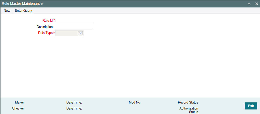

You can invoke the ‘Rule Master Definition’ screen by typing ‘LFDRLAVL’ in the field at the top right corner of the Application tool bar and clicking the adjoining arrow button.
Rule ID and Description
Every charge rule is identified by a unique ten-character code, called a Rule ID. You can link a valid Charge Rule ID to the charge classes that you maintain in your bank. Charges or fees for all products with which you associate a charge class is calculated on the basis of the Rule ID that is associated with the class.
Rule Type
The Rule Type identifies the type of component you are defining. The attributes applicable for a component depend on the Rule Type. This chapter discusses the procedure for setting up rules for charge components.
For every rule that you define, you can enter a description. Specifying a description helps identify a rule.

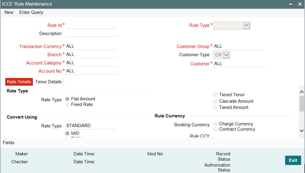

You can invoke the ‘ICCF Rule Maintenance’ screen by typing ‘LFDRUMNT’ in the field at the top right corner of the Application tool bar and clicking the adjoining arrow button.
If you are calling a charge rule that has already been defined, choose the Summary option under ‘ICCF Rule Summary’ in the Application Browser. From the ‘ICCF Rule Summary’ screen, double-click a rule of your choice to open it.
The following are the features of the ‘ICCF Rule Maintenance’ screen.
Rule ID
Specify the valid charge/fee ‘Rule ID’ to the charge/fee classes that you maintain in your bank. The adjoining option list displays the list of all rule IDs available in the system. You can select the appropriate one. These rule IDs are fetched from 'Rule Master Definition' screen.
Rule Description
The ‘Rule Description’ appears based on the rule ID.
Rule Type
The ‘Rule Type’ - ‘Interest’, Charges/Fees are defaulted from the 'Rule Master Definition'
screen. You cannot change the rule type.
Transaction Currency
If you want to define the attributes for all currencies, you can select the ALL option in the Currency Code field to indicate this. If you are maintaining the attributes for the selected ICCF rule in specific currency other than the ALL, select the Transaction Currency on which the rule mapping maintenance is to be made applicable.
Customer Group
Select the customer group on which the rule mapping maintenance is to be made applicable.
Note
You can create a generalized charge rule mapping record by selecting the ALL option in the Customer Group field. This specification is defaulted to the Customer and Customer Account fields. You will not be allowed to change the specification.
Customer
Specify the customer identification number (CIF) of the customer for whom you are maintaining the rule mapping.
Branch Code
If you are maintaining the attributes for the selected ICCF rule from the head office branch, you can select the branch for which the attributes are being defined. If you want to define the attributes for all branches, you can select the ALL option in the Branch Code field to indicate this.
If you are maintaining the attributes for the selected ICCF rule from a branch other than the head office, you can only select those branches that are found in the allowed list of branches for:
In other words, the option-list in the Branch Code field would display only those branches that are allowed both for the rule and the current branch.
Specifying the Rate Type
The rate type indicates whether the charge or fee to be applied for the Rule ID is a flat amount or a percentage of the contract amount. Contract amount here refers to:
If the Charge Rule that you are defining calculates charges on a rate basis, choose the ‘Fixed Rate’ option. To levy a flat amount as charge, say a postal charge on the products that are associated with the Charge Class, choose the ‘Flat Amount’ option.
You can choose to indicate the Rate Code and whether the rate is ‘MID’, ‘BUY’ or ‘SELL’ only when the basis amount currency and the rate currency is different from the contract currency.
You can indicate the specific rates and amounts that you would like to apply, in the subsequent fields in this table. These rates or amounts can be changed during contract processing.
By default, a charge rule that you define can be applied on transactions in
However, to restrict the application of a rule to transactions involving a specific customer or currency, you can specify the same in the Customer or Transaction Currency fields, respectively.
Conditions for the application of a charge rule can be defined in the following manner:
Thus, the most generally applied condition can be that a charge rule is applicable to contracts in any currency and involving any customer. An interim condition is that a charge rule is applied on contracts in a specific currency but involving any customer.
Example
Requirement:
You would like to levy a special flat charge, in EUR, for maintaining customer portfolios in DEM - EUR being the more convenient currency. Further, you would like to exempt corporates and Financial institutions and levy the charge only on individual portfolios.
Set up:
Step 1
To the rule defined for calculating the special charge, enter a unique Rule ID in ‘Rule Master Definition’ screen, SplChPort1 and the same is defaulted to the ‘ICCF Rule Maintenance’ screen. Briefly describe the charge for easy identification: EUR charge: individual portfolios.
Step 2
Select the ‘Flat Amount’ option in the ‘Rate Type’ field from ‘ICCF Rule Maintenance’ screen.
Step 3
Choose EUR in the Currency field. Choose Individuals in the Customer field. Enter the other details such as the Charge Currency and the tiers or slabs on which you would like to levy the charge.
Step 4
Save this record. Another user with the requisite rights should authorize this record before it can be used.
Note
You are not allowed to define an ICCF Rule for a specific combination unless you maintain a record for the same Rule at the generic level. For instance, while creating the Rule ID called SplChPort1 for the very first time the system defaults the values in the Transaction Currency, Branch, Account Category, Customer, Customer Group, and Account fields to All. Only after saving this record you are allowed to create a second record for a specific combination for the same Rule ID.
