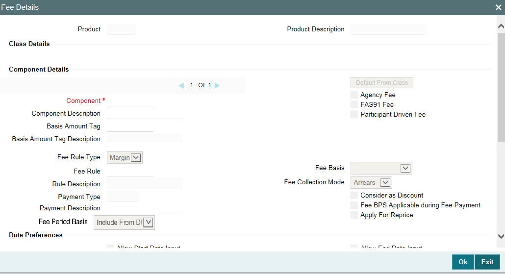

4.2 Defining fee components for a product
You can specify the fee components applicable to a product, in the fee Definition sub- screen of ‘Loans and Commitment Product Definition’ (OLDPRMNT) screen. Click ‘Fee’ from ‘Loans and Commitment Product Definition’ screen to invoke the ‘Fee Details’ sub-screen.
You should necessarily use a fee class to indicate the fee components applicable to a product. A fee class is a specific type of component that you can build with certain attributes.
4.2.1 Associating a fee with a product
To associate a fee class with a product, select the appropriate fee class from the list of classes defined specifically for the particular module of Oracle Lending. Click ‘Default From Class’ from the ‘Fee Details’ screen.
The attributes defined for the fee class are displayed. You have the option to change the attributes defined for the fee class to suit the requirement of the product you are creating.
4.2.2 Associating several fee classes with a product
You can associate several fee classes with a product. To add to the list of classes associated with the product click the ‘Add row’ button. Thereafter, select a class from the option list that is displayed and then click ‘Default From Class’.
To navigate between the fee classes associated with a product, you can use the icons provided for the same.
To disassociate a fee from the product, navigate to the class, and click the ‘Delete row’ button.

4.2.4 Specifying Fee Period Basis
During fee accrual calculation, you can choose fee period basis to compute number of days for the fee schedule based on the option chosen during contract life cycle.
You can select the tenor basis upon which fee is computed over a schedule or fee period for a contract. You can select an option in while defining fee components for a product and the same is inherited to the contract. If required, you can change the default option.

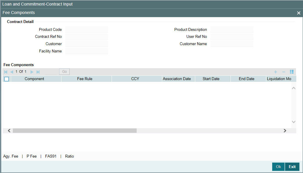

4.3 Specifying Fee details for a contract
From the Loan and Commitment - Contract Input (‘OLDTRONL’) screen, click ‘Fee’ to invoke the ’Fee Details’ sub-screen.
When the details of a contract are captured, the fee components defined for the product is automatically applied. However, while processing a contract, you can change certain attributes of the fee component.
4.3.1 Features of the Contract Fee Details screen
The contract reference number of the contract you are processing is displayed on this screen.
4.3.2 Fee details
The fee components specified for the product to which you have linked the contract is displayed in tabular columns.
