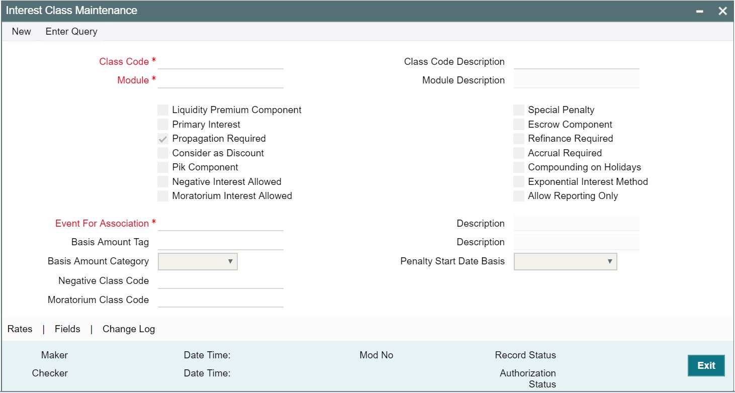

3.1 Introduction
You can define the attributes of an interest class, in the ‘Interest Class Maintenance’ screen.
You can access this screen by typing LFDINTCL in the field at the top right corner of the Application tool bar and clicking the adjoining arrow button.
Before defining the attributes of an interest class, you should assign the class a unique identifier, called the Class Code and briefly describe the class. A description would help you easily identify a class.
Specifying the Module
An interest class is built for use in a specific module. This is because; an interest component would be applied on different basis amounts, in different modules.

Events
The term Event can be explained with reference to a deal. A deal goes through different stages in its life cycle, such as:
Each stage is referred to as an Event in Oracle Lending.
The event at which you would like to associate the interest component, being defined, to a contract is referred to as the Association Event.
Basis Amount Tag
The basis on which an interest is calculated is referred to as the Basis Amount. When building an interest class, you have to specify the tag associated with the Basis Amount.
The attributes defined for an interest class, will default to all products with which you associate the class. When maintaining interest details for a product, you can change these default attributes. Contracts maintained under a product will acquire the attributes defined for the loan product.

Specifying rate fixing
Select this check box to indicate whether the rate fixing is applicable for a particular component. This is applicable for Bilateral Loans and Loan Syndications.
Moratorium Interest Allowed and Moratorium Class code
In case 'Moratorium Interest Allowed' check box is selected for main interest component, then on save the system creates 'Moratorium Class Code' ('Class Code' field value is appended with _M).

Specifying the amount category
Indicate the category of the component on which the interest has to be applied. The available options are:
If Normal is selected, the balance on which interest has to be applied will be the Expected Balance (assuming that all the scheduled repayments, defined for the contract, are made on time). An example of this category is the application of interest on the principal of a loan.
If Overdue is selected, the balance on which interest has to be applied will be the amount that is outstanding, based on the repayment schedule defined for the contract. An example of this category is the application of penalty interest, on the principal or interest, when a repayment has not been made as per the schedule.
If Outstanding is selected with the amount category as principal, the interest is calculated on the balance of the total principal outstanding amount.
If Overdue OS is selected with the amount category as principal, the interest is calculated on the principal overdue outstanding.
If SCH-Overdue is selected, then the basis amount refers to amount outstanding on a particular schedule due date. If you select the ‘Basis Amount Tag’ as ‘SCH_AMT_OS’, then system defaults the ‘Amount Category’ as ‘Sch-Overdue’ and disables this field.
Select the applicable category using the drop-down list. The system defaults to Normal.

Opting to Accrue Interest
You can choose to accrue the interests due on a contract. To accrue the interest payable on a contract, choose the ‘Accrual Required’ option.
The accrual details that you define for an interest class defaults to all products with which you associate the class. When maintaining interest accrual details for a product, you can change these default details. Contracts maintained under a product acquires the accrual details defined for the product. However, you can define unique accrual details for a contract.
