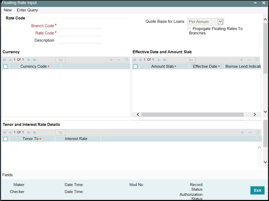

A Floating Rate corresponds to the market rates for the day. These rates are maintained and updated daily (or whenever they change,) in the Floating Rates Table. The rates can be applied on a contract with or without a spread.
You can invoke the ‘Floating Rate Input’ screen by typing ‘CFDFLTRI’ in the field at the top right corner of the Application tool bar and clicking the adjoining arrow button.
The floating interest rates are defined through this screen.
Each Rate Code is associated with a currency. You can define rates for the same Rate Code in different currencies.
A Rate Code identifies a set of rates defined for a combination of Currency, Amount Limit (optional) and Effective Date. When processing a contract initiation, you should link it to the Floating Rate Table by indicating the Rate Code. The rates defined for the Rate Code are applied on the contract.
Propagate Floating Rates To Branches
Select this option to indicate that the rate code should be available across all branches.
Specifying Effective Date and Amount Slab Details
Amount Slab
For a specific Rate Code and Currency combination, you can define an amount slab structure for application of interest rates. You should specify the upper limit of the slab to which a particular rate should be applied. A rate that has been defined for an Effective Date - Amount Slab combination is applicable to an amount less than or equal to the specified amount. You can define interest rates for a slab structure.
Effective Dates
Each rate that you define for a Rate Code and Currency combination should have an Effective Date associated with it. This is the date on which the rate comes into effect. Once a rate comes into effect, it is applicable till a rate with another Effective Date is given for the same Rate Code and Currency combination.
Note
The rates are applied to a contract depending on whether it has been defined with Auto Rate Code Usage or Periodic Rate Code Usage. You can specify this in the ‘Interest Class Maintenance’ sub-screen of the ‘Loans and Commitment Product Definition’ screen.
Borrow/Lend Rate Indication
For every Amount Limit - Effective Date combination, you should define the rate to be applied as a borrow rate or a lend rate. Borrow rates are applied for loans taken by the bank and lend rates apply on placements. You also have the option to specify mid-rate.
Tenor and Interest Rate Details
The rates that are applied for a given combination of Amount Limit – Effective date – Lend/Borrow Indication can be tenor based. In the table, you can define the interest rates for different tenors. The rate that is applied to a contract is based on the interest parameters specified in the ‘Interest Class Maintenance’ sub -screen of the ‘Loans and Commitment Product Definition’ screen.

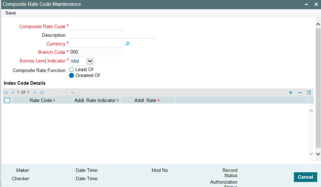

The index rate code which was picked up to derive the resultant composite rate is stored as ‘Picked Up Rate Code’ for the effective date, which has the reset tenor zero.
The rates picked for the index rate codes are for the maximum amount maintained in the amount slab. The composite rate rebuilt is stored with the amount slab as “999,999,999,999.00”. After applying the additional rate (specifically when the additional rate indicator is ‘-‘), if the resultant rate becomes –ve, then it is considered as 0 as –ve rate is not allowed.

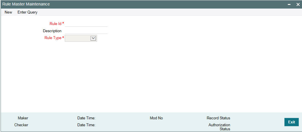

An Interest Rule identifies the basic nature of an interest component.
An interest rule is defined in the ‘Rule Master Definition’ and ‘ICCF Rule Maintenance’ screen.
As you are defining an interest type of component, (that is, a tenor based component), you need to specify only the following details through the ‘Rule Master Definition’ and ‘ICCF Rule Maintenance’ screen:
All the other details of the component are to be specified through the ‘Interest Class Maintenance’ sub -screen of the ‘Loans and Commitment Product Definition’ screen.
You can invoke the ‘Rule Master Definition’ screen by typing ‘LFDRLAVL’ in the field at the top right corner of the Application tool bar and clicking the adjoining arrow button.
Rule ID and Description
Each Interest Rule is defined by a four-character code, called the Rule ID. Attributes are defined for this Rule ID, which is then linked to a product. When a contract is processed, the interest attributes defined for the Rule ID linked to the product is applied on the contract, some of which can be changed.
Rule Type
The Rule Type identifies the type of ICCF component you are defining. In this case it is Interest. The attributes applicable for a component depends on its Rule Type.
For example, you can define any component that is tenor based − an annual fee, for example - as a component of Rule Type Interest. If INTEREST1 is your main interest, your annual fee can be defined as INTEREST2, as it is tenor based. Only on an Interest type of component, you can have the floating rates.

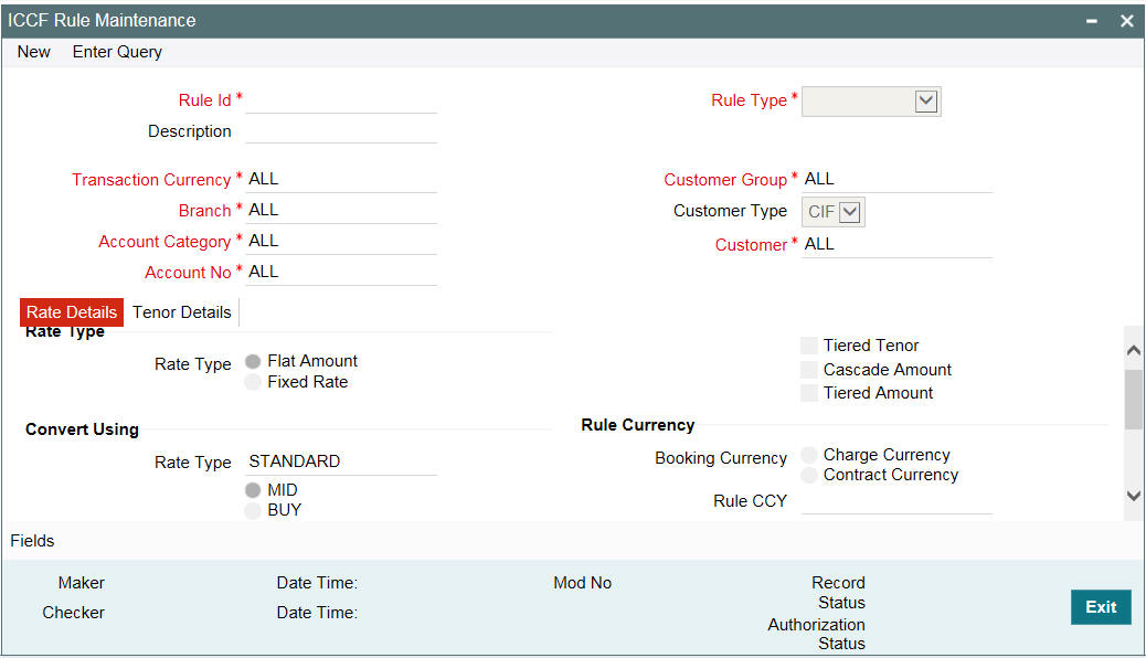

You can invoke the ‘ICCF Rule Maintenance’ screen by typing ‘LFDRUMNT’ in the field at the top right corner of the Application tool bar and clicking the adjoining arrow button.
Rule ID
Specify the valid interest ‘Rule ID’ to the interest classes that you maintain in your bank. The adjoining option list displays the list of all rule IDs available in the system. You can select the appropriate one. These rule IDs are fetched from 'Rule Master Definition' screen.
Rule Description
The ‘Rule Description’ appears based on the rule id.
Rule Type The ‘Rule Type’ ‘Interest’, Charges/Fees, ‘Tax’ are defaulted from the 'Rule Master Definition' screen. You cannot change the rule type.
The Rate Type indicates whether the rate to be applied for the Rule ID is a flat amount or a percentage of the contract amount. The specific rates and amounts applicable have to be specified in subsequently through this screen. These rates or amounts can be changed during contract processing.
You can choose the rate code as ‘Mid’, ‘Buy’ or ‘Sell’ only when the basis amount currency and the rate currency is different from the contract currency. The rate code is used to arrive at the exchange rate if the rate currency is different from the contract currency.
Booking Currency
You can choose one of the booking currency.
Based on the booking currency specified, the system will decide the currency in which the charge needs to be calculated.
Minimum Amount
If the charge is based on a fixed rate, you should specify the minimum amount that can be applied on a contract involving the Rule ID. If the charge calculated using this Rule ID falls below this amount for a contract, the minimum amount specified in this field will be applied instead of the amount calculated using the fixed rate.
Maximum Amount
If the charge is based on a fixed rate, you should specify the maximum amount that can be applied on a contract involving the Rule ID. If the charge calculated using this Rule ID exceeds this amount for a contract, the maximum amount specified in this field will be applied instead of the amount calculated using the fixed rate.
Basis Amount Currency
Charges or fees can be calculated for a transaction on the basis of tiers or slabs. When building a charge rule, you should also indicate the currency of the tiers or slabs based on which you levy the charge. This is the Basis Amount Currency. If the transaction is in a different currency, then the charge is calculated after converting it to the currency of the tiers and slabs.
Basis Amount To
You should specify the upper limit of the slab or tier to which a particular rate or amount should be applied as a charge.
Fixed Rate
If the charge is a percentage of an amount, specify the applicable rate. This rate will be applied on the Basis Amount To, depending on whether you have defined the application basis, as a slab or a tier.
Charge Unit
The Charge Unit specifies the unit for rounding up a charge basis amount or fee basis amount to the nearest amount. The charge or fee will be calculated on the rounded basis amount.
Floor Amount
You should specify this only if the Amount Basis is a Tier. This will be the upper limit of the previous tier limit. By default, the amount specified as the ‘Basis Amount To’ for the previous tier limit will be displayed. For the first limit in the tier do not specify this. This amount, along with the Floor CCF Amount, is used to calculate the charge.
Flat (CCF) Amount
To levy a flat charge, specify the flat amount. This amount will be applied on the Basis Amount, depending on whether you have defined the application basis as a slab or a tier.
Tenor Details – Tenor From and Tenor To
The tenor is in days. For instance, If Tenor from and Tenor to are given as '0' and 91, the tenor slab is from '0' days to '91' days.

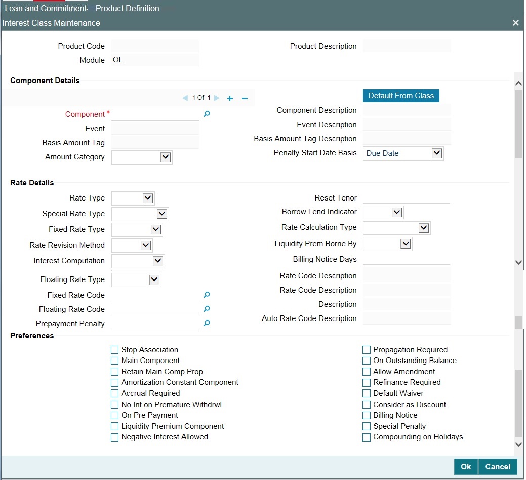

You can specify the interest components applicable to a product in the Interest Class Maintenance’ sub -screen of the ‘Loans and Commitment Product Definition’ screen.
From the Loans and Commitment Product Definition screen (OLDPRMNT), click ‘Interest’ to access ‘Interest Class Maintenance’ sub-screen.
You should necessarily use an interest class that you have created, to indicate the interest components applicable to the product. An interest class is a specific type of interest component that you can build with certain attributes.
Associating an interest class with a product
The attributes defined for the interest class defaults to the product. You have the option to modify the attributes defined for the class, to suit the requirement of the product you are creating.
Associating several interest classes with a product
You can associate several interest classes with a product.
To navigate between the classes associated with a product, you can use the arrow icons that are provided.
To disassociate a class from the product, navigate to the class using the arrow icons described above and click ‘Delete row’ button.
For an interest class, you can define the following:
Dissociating an Interest class from a product
The interest classes defined for a product is automatically applied to all contracts involving the product. If, for some reason, you want to stop applying a particular interest class to new contracts that are initiated (involving the product), you can do so by selecting the ‘Stop Association’ check box.
In effect, stopping the application of an interest class component for a product would be equivalent to deleting the class from the product. By specifying that the application of a class should be stopped, you have the advantage of using the definition made for the class again. To do this, you have to deselect ‘Stop Association’ check box . Contracts that are subsequently initiated picks up the class.
Specifying the main interest component
You can define any number of interest classes for a product. If you have defined more than one interest class, you can specify one of them as the main interest component. This interest component that is used for capitalization or amortization purposes if the repayment schedules are defined.
The details of this Main Component is shown in the Loans and Commitment - Contract Input’ screen (OLDTRONL) and you can change them there without having to invoke the ‘ICCF Details’ sub-screen. Components other than the main component have to be processed through the ‘ICCF Details’ screen.
Specifying to retain main component properties
You can specify to retain the properties of main component for a particular component. The details of main component including gets applied to the selected component. And any changes made to the attributes of main component are reflected to this particular component also. When you select this option, you cannot enter the interest definition details either at product or contract level other than selecting this component for discount.
You have to define an interest class first with the ‘Amount Category’ as ‘Expected’ and the same component can be linked at the product with ‘Retain Main Comp Prop’ selected. As per this component, interest is computed on Expected Balance which is later be used for IRR computation.
Note
Rate revision schedule definition can not be done for such components.
Specifying the event for association
Specify the association event in ‘Event’ field. The event, at which you would like to associate an interest component to a contract, is referred to as the association event.
At this event, no accounting entry (for the interest component) is passed.
Specifying the basis amount tag
The basis on which interest is calculated is referred to as the basis amount. In ‘Basis Amount Tag’ field, you have to specify the ‘tag’ associated with the basis amount. Interest is calculated on the amount represented by this tag.
Specifying the amount category
Indicate the category of the component on which the interest has to be applied. The available options are:
If the Basis Amount Category is Normal, the balance on which interest has to be applied is the Expected Balance (assuming that all the scheduled repayments, defined for the contract, are made on time). An example of this category is the application of interest on the principal of a loan.
If the Basis Amount Category is Overdue, the balance on which interest has to be applied is the amount that is outstanding, based on the repayment schedule defined for the contract. An example of this category is the application of penalty interest, on the principal or interest, when a repayment has not been made as per the schedule.
Select the applicable category using the drop-down list. The system defaults to Normal.
Rate Type - The Rate Type indicates whether the interest is a Fixed Rate, a Floating Rate or a Special amount. When creating a product, you should specify the Rate Type based on which interest is computed.
Floating Rate Code - If the Interest Rate Type has been specified as Floating, indicate the Rate Code to which the product has to be linked. The Rate Code corresponds to the rates, defined in the Floating Rates table, that have to be applied for the product. A Rate Code identifies a set of rates defined for a combination of Currency, Amount (if it is necessary) and an Effective Date.
Select the Rate Code applicable for the product you are defining from the option-list provided. The Rate Code can be changed during contract processing.
Floating Rate Type - In addition, you should specify the method in which the rates in the Floating Rates table have to be applied on the loan. It could either be automatic application (meaning the rate has to be applied every time it changes), or periodic application (meaning the rate has to be applied at a regular frequency, defined for each contract involving the product).
Borrow Lend Ind - For floating rate interest, you should also indicate if the interest rate for a given rate code to be applied, from the Floating Rates table, is the Borrow rate, Lend rate or Mid rate.
Reset Tenor - If interest rates are defined for the tenor of a contract, you should specify the Reset tenor. This will indicate the tenor for which the floating rate (when applied automatically) needs to be picked up from the Floating Rates Table, for contracts using this product.
Rate Calc Type - Interest rates based on the tenor of a contract could be applied in any of the following ways:
Example
The Floating Rates table has the following tenor-based interest rate definitions:
Tenor |
Interest Rate |
5 |
12% |
15 |
16% |
The tenor of the contract to be processed is 9 days. This falls between the 5 day and 15 day slabs for which interest rates are defined in the table.
Depending on the Rate Cycle Type specified, the interest rate for 9 days are applied as follows:

Specifying the Rule ID
You can link a rule to a product. In the Product ICCF Details screen, in the Rule ID field, pick the rule you want to link to the product. For an interest type of rule, all the interest-related details have to be specified in the Product ICCF Details screen.

You can link composite rate codes to loans. Based on the formula maintained at the composite rate maintenance, system derives at a composite rate for floating rate.
To link composite rate code with an Oracle Lending (OL) product, you need to select composite rate code from the ‘Float Rate Input’ screen (CFDFLTRI).
To link composite rate code with OL contract, select composite rate code from the list of options available for ‘Floating Rate Code’ in the Loans and Commitment - Contract Input’ screen (OLDTRONL). During reprice, composite rate code can be linked to a contract by selecting ‘Rate Code’ available in ‘Consolidate Details ‘reprice screen (OLDREPRC).
Any rate change in Head Office for the index rate codes triggers a re-pickup of the rate for composite rates also and propagate the same to other branches for composite rate code. Branch wise changes to the index rate codes are not considered for re-pickup of composite rate code.
Note
At any point there can be either a composite rate code or a floating rate code, both cannot co-exist in a single contract. Composite rates are supported for Floating Periodic Auto and Floating Automatic type of loans. Composite rate code definition does not have any impact on the rate revision of a contract.
If there is any change in the index codes for a Composite rate code, the underlying Floating Automatic type of contracts are impacted and the new rate is arrived based on the derivation logic on that day’s EOD. In case of Floating Periodic Auto type of loans, the rate is derived on the EOD of the revision schedule. There is no impact of back value rate change of the index codes on the underlying Floating Periodic (Auto) type of Contracts.
You can maintain the composite rate code from the head office using ‘Composite Rate Code Maintenance’ screen.
You can access this screen by typing ‘OLDCMPMT’ in the field at the top right corner of the Application tool bar and clicking the adjoining arrow button.
Specify the following details here:
Composite Rate Code
Specify the code you want to maintain for the composite rate.
Description
Specify a small description for the composite rate code.
Currency
Select the currency for which the composite rate code is maintained.
Branch Code
Select the branch for which the composite rate code is maintained.
Rate Function
Select if the composite rate should be the least or greatest of the rates maintained plus the additional rate for the rate codes.
Following index code details are populated here:
You can perform following operations in the ‘Composite Rate Code Maintenance’ screen:

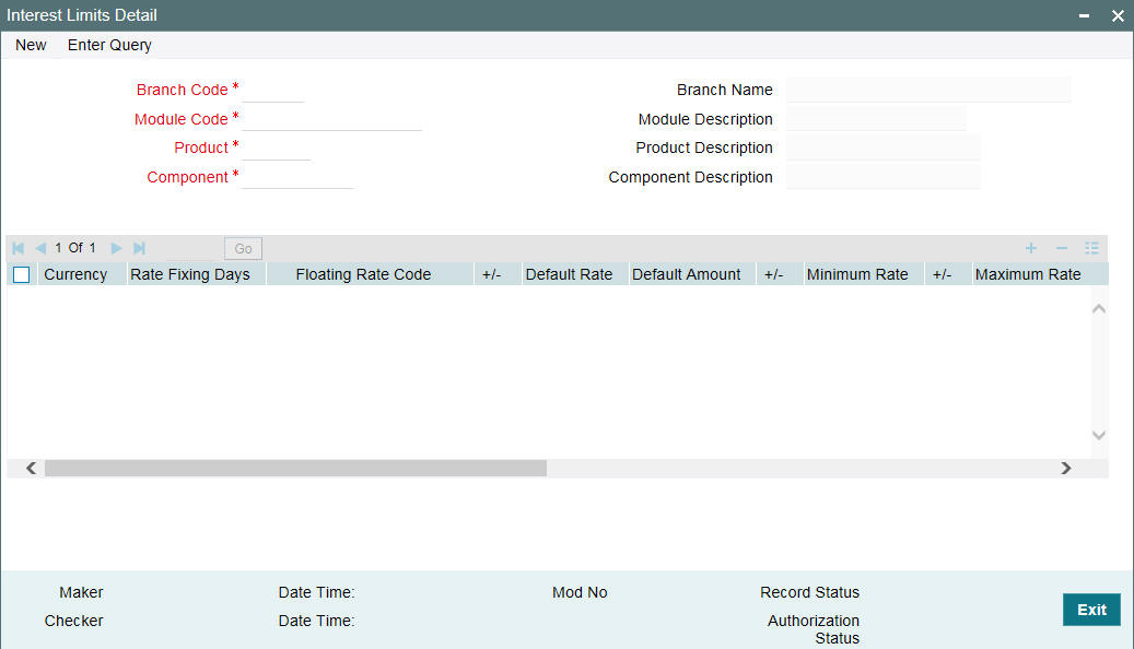

You can maintain tenor based, currency-wise interest limits for a combination of Product and Interest Component through the ‘Interest Limits Detail’ screen. You can access this screen by typing ‘OLDINTLM’ in the field at the top right corner of the Application tool bar and clicking the adjoining arrow button.
When an interest class for which currency-wise interest limits have been maintained is associated with a Loans product (in the Interest Class Maintenance’ screen), the product inherits the limits, by default. Such default limits can be modified if required, when the interest limits for the product and branch combination are maintained, in the ‘Interest Limits Detail’ screen.
This maintenance would be applicable for all contracts for which:
You can maintain the following information to set up the tenor-based, currency-wise interest limits for a product, interest component, and branch combination:

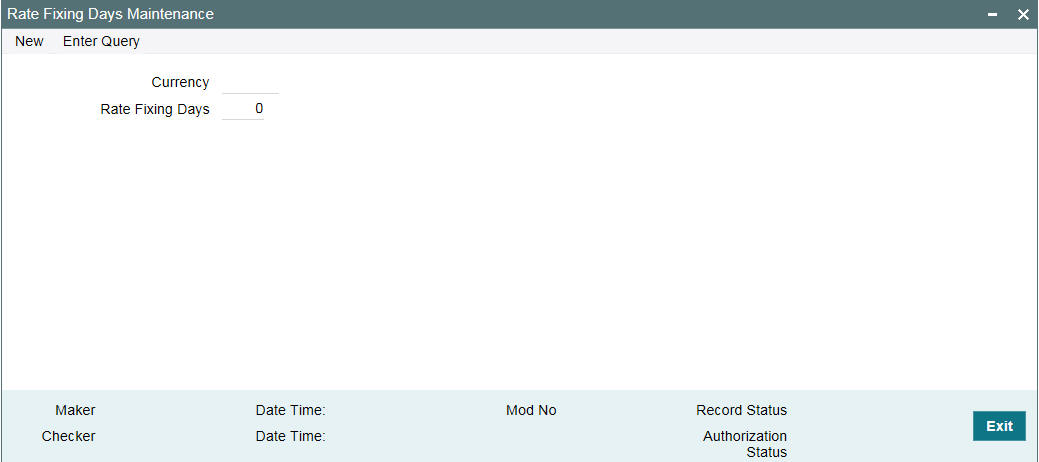

Capturing the Rate Fixing Days
The rate fixing days gets defaulted from the ‘Rate Fixing Days Maintenance’ screen. This is a numeric field. The system checks for the following:
Capturing the Floating Rate Code
Floating rate code is applicable for floating products. You cannot use floating rate code for fixed rate type. If floating rate code are different in ‘Interest Class Maintenance’ screen (LFDINTCL) and 'Bilateral Loans Product Definition’ screen (OLDPRMNT), then the system takes the floating rate code from the ‘Bilateral Loans Product Definition’ screen. If you want to change the floating rate code, you can change in this screen.
Capturing the Default Amount or Default Rate for Late Payment Charge
For components defined with Rate Type ‘SPECIAL’ in ‘Interest Class Maintenance’ screen, you can specify a default flat amount or a default rate at the interest limit level which is defaulted to the ‘Interest Limits Details’ screen.
Based on the value of ‘Special Rate Type’, you can either maintain the ‘Default Rate’ or ‘Default Amount’ for late payment charge applicable to the loan product.
If the value of ‘Rate Type’ is ‘SPECIAL’ and ‘Special Rate Type’ is ‘FIXED’ in the ‘Interest Class Maintenance’ screen, then you can specify the default fixed rate to be applied as late payment charge to all loans created under this loan product.
You can specify the default late payment charge (either fixed rate or flat) by selecting the loan product code and the late payment charge component. This component should already be linked to the loan product through the ‘Interest Class Maintenance’ screen.
For interest rate components, you can specify the minimum and maximum rate that can be changed at the contract level.
For Fixed Rate products
If the interest rate specified for a contract is less than this minimum rate, the minimum rate is applied on the contract. Similarly, if the interest rate specified for a contract is greater than this maximum rate, then the maximum rate specified is applied on the contract.
By defining minimum and maximum rates for a fixed interest, you can ensure that your rates stay within the stipulated limits.
For penal interest components, you can specify the overdue tenor for which the penalty interest should be applied.
For Floating Rate Products
For Floating Rate products, specify the Minimum and Maximum spread that can be applied on the floating rate.If the spread specified during contract processing is less than the value specified as the minimum spread, this value will be picked up as the spread. Similarly, if the spread specified during contract processing is more than the value specified as maximum spread, this value is picked up as the spread.
By defining minimum and maximum spread for floating interest, you can ensure that your spread stays within the stipulated limits.
The rate maintained for the maximum tenor is used if the Overdue days extend beyond the maximum tenor maintained.

When the details of a contract are captured, the interest details defined for the product involved are automatically be applied on the contract. However, you can change certain attributes.
At the time of processing the contract, you can change the following attributes:
From the ’Loan and Commitment- Contract Input’ screen, click ‘ICCF’ to access the contract ‘ICCF Details’ screen.
It is possible to define more than one interest component. You can have several interest components, which you link to a product. The contract involving the product, in turn, will be linked to these interest rules.

Special Rate Type
System defaults the maintenance done for ‘Special Rate Type’ in the ‘Interest Limits Maintenance’ screen. However, you can edit this value and select the special rate type from the adjoining drop-down list. This list displays the following values:
Specifying the Fixed Rate Code
If the Fixed Rate Type is ‘Standard’, this indicates the Standard Rate Code based on which the system pick ups the rate applicable on the contract.
This specification is defaulted from the product. However, you are allowed to change it at the time of contract processing.
Specifying the Penalty Rate Code
If pre-payment penalty is allowed for the loan product, select the rate code based on which the system pick-ups the prepayment penalty rate for the contract.
This specification is also be defaulted from the product. However, you are allowed to select a different rate code at the contract level.
Choosing Revision Method
Select the revision method option for the periodic floating type of loans from the list of option provided:
Alternative Risk-Free Rates
For information on ‘Alternative Risk-Free Rates’, refer to ‘Interest Class Maintenance’ in this User Manual.
Specifying Interest Rate Rounding Components
The ‘Rate Rounding Rule, ‘Rate Rounding Unit’, and ‘Rate Rounding Position’ values get defaulted from ‘Interest Limits Detail’ screen. If required, you can change these values
Enabling the Consider as Discount option
While defining an interest class for either the loans or the bills module, you can indicate whether the interest component is to be considered for discount accrual on a constant yield basis.
The value for this field is defaulted from the Interest Definition and it can be changed here.
If ‘Accrual Required’ option is not selected then ‘Consider as Discount’ option is disabled for Bearing Contracts.
If you select this option the interest received against the component is used in the computation of the constant yield and subsequently amortized over the tenor of the associated contract.
Note
You are allowed to enable the Consider as Discount option for loans only when the payment method specified is Discounted or True Discounted and for the Discount operation for Export bills.
For bearing type of contracts, all future interest cash flows are considered for computation of constant yield. For discount type of contracts, only the interest amount received for the components with the ‘Consider as Discount’ option enabled are considered for the computation of constant yield; subsequently the interest amount received in advance for these components is amortized over the tenor of the associated contract.
Specifying whether the Interest Component is to be accrued
While defining an interest class for either the loans or the bills module, you can indicate whether the interest component is required to be accrued.
The value for this field is also defaulted from the ‘Interest Class Maintenance’ screen. However, you can change it here.
Note
If both ‘Consider as Discount’ and ‘Accrual Required’ fields have not been enabled for the product, you cannot enable these for contracts.
If the ‘Special Penalty Component’ check box is selected for a component, then system deselects the ‘Accrual Required’ box for such components and disable it.
System automatically checks this box for late payment charge components (based on the maintenance done in ‘Interest Class Maintenance’ screen) and you cannot modify it.

You can invoke the ‘Rate Fixing Days Maintenance’ screen by typing ‘OLDCCYRF’ in the field at the top right corner of the Application tool bar and clicking the adjoining arrow button.
Specify the following:
Currency
Enter the currency. You can maintain rate fixing days for each currency. The currency details are defined in the Currency Details screens (‘CYDCDEFE’).
Rate Fixing Days
Enter the rate fixing days. The rate fixing days must be greater than zero and not greater than 5 days.
