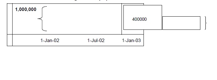

Case1: Yield Basis method of accrual for loan contracts
Assume that your bank has disbursed a loan with the following details:
The detail of the loan contract is diagrammatically represented as shown:
According to the above illustration, the loan contract has a repayment schedule on 1st July 2002 and we are assuming that the customer has repaid USD 6,00,000 of the loan amount and therefore the outstanding balance is USD 4,00000.
Oracle Lending calculates the fee accrual amount for the above loan contract as follows:

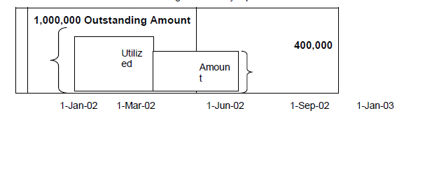

Case 2: Yield Basis method of accrual for revolving type of commitments with utilized facility amount
Let us assume that your bank has processed a revolving commitment with the following details:
Details of the loan linked to the above commitment
The details of the commitment are diagrammatically represented below:
In the above representation, the shaded area represents the outstanding amount of the commitment and non-shaded area represents the amount utilized by the customer.
With reference to the above illustration, we are assuming that the schedules for the commitment are on 1st march 2002, 1st June 2002 and 1st September 2002. Further, we assume that the utilized amount between 1st September 2002 and 1st January 2003 is USD 400,000.
Keeping these details in view, system calculates the fee accrual amount as shown below:

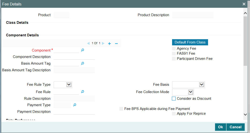

After defining a fee component, you need to link the fee component to a product in Oracle Lending. Consequently, you can collect and accrue fees on all contracts associated with that product.
Click ’Fee’ n the Product Definition screen to invoke this screen.
Click ‘Add Row’
to add fee components. Click ‘Default
From Class’ to associate the required fee component with the product.
System defaults the parameters of the selected fee component. However,
you can change the parameters according to your requirements.
For each of the fee component that you associate with the product, Oracle Lending generates the following accounting roles:
For more information on accounting role to head mapping, refer to the Product Definition User Manual.
For the fee component you associate with product you can specify if the component is considered for discount accrual. Discounted Accrual is applicable for both Fixed and Floating type of Fixed Maturity type Loan and Advance type of User Input fees. The discount accrual selected here for the product gets defaulted to the contract level.
Select ‘Consider as Discount’ check box for applying discount accrual to the component.
Among the fee components you associate with product one of the fee components can be used to transfer the unamortized fee amount in the contract to the child contract. Applying for Re-price has no impact on the schedules of the fees.
Select ‘Consider as Discount’ and ‘Apply Reprice’ check box for transferring the unamortized amount of the contract to another child contract. While transferring the amount system shows an error if both the options are not selected for the component.

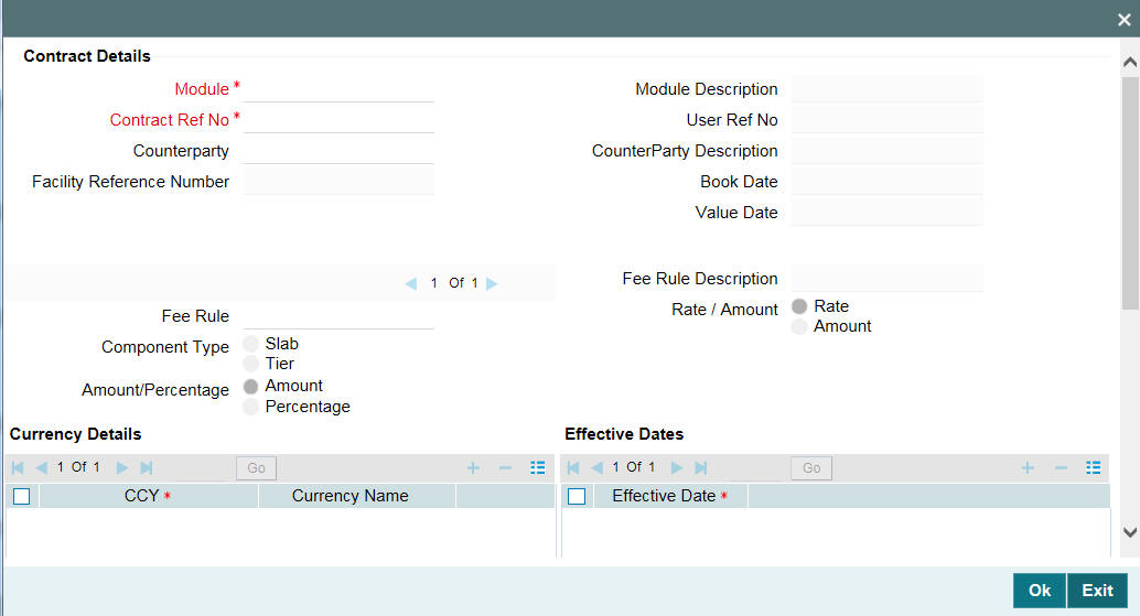

You can invoke ‘Fee Rule Maintenance’ screen by clicking ‘Fee Rule’ from the ‘Loan and Commitment- Contract Input’ (OLDTRONL) screen. You can define the slab ranges and the fee amount or rate for each slab for each of the fee components like ‘Loan Fee’ and ‘Commitment Fee’.

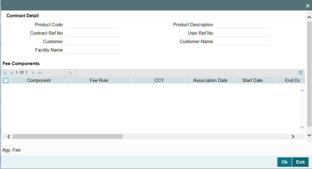

On clicking the ‘Fee’, the ‘Fee Component’ screen is displayed.
Here, the system defaults the loan fee, unused fee and commitment fee components which are maintained at the product level with which this contract is associated.
The system defaults the following details:

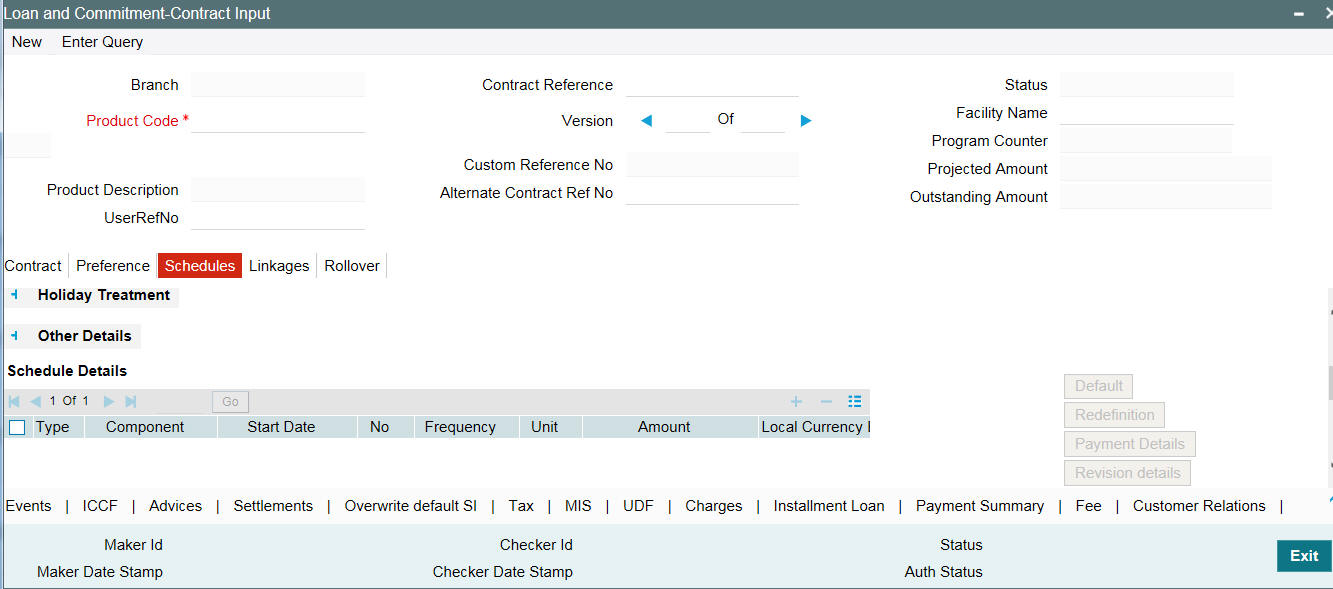

You can define the fee payment schedules in the Loan and Commitment- Contract Input’ (OLDTRONL) screen under ‘Schedules’ tab.
Here the fee payment schedules are defined under Schedule Details as seen above.

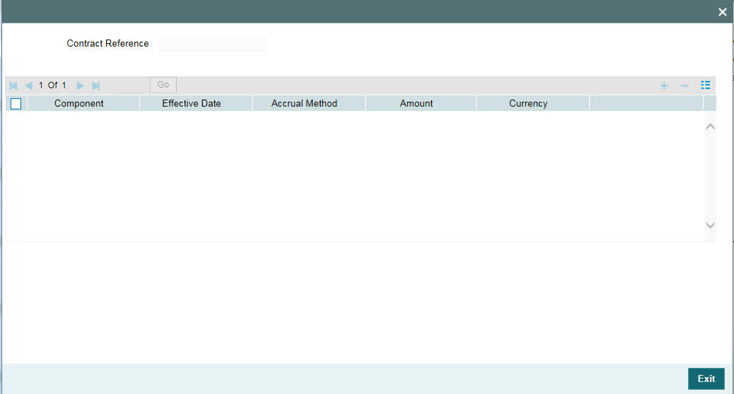

You are allowed to amend the above preferences in future through the ‘Fee Amendment’ screen.
You can amend fee schedules in ‘Schedules Details’ tab.
Here you can amend the schedules of a particular component of a contract if required.
Click ‘Accrual Fee Details’ in the ‘Product Definition’ screen to invoke the ‘Accrual Fee Input’ screen.
Click ‘Add row’ to add fee components. Click ‘Default From Class’ to associate the required fee component with the product. System defaults the parameters of the selected fee component. However, you can change the parameters according to your requirements.
You need to specify the following details:
Accrual Method
Specify the accrual method from the adjoining drop-down list. This list displays the following values:
Basis Amount
Select the basis amount on which the fee component should be calculated from the adjoining drop-down list. This list displays the following values:
Fee Type
Specify the fee type from the adjoining drop-down list. This list displays the following values:
Payment Method
Allow Method Amendment
Select this check box to indicate that the amendment method is allowed for the accrual fee component.
Allow End Date input
Select this check box to indicate that the fee component (if applicable for the product involved in the contract) cease to be associated with a contract on the contract ‘End Date.
CLP Buy Price Diff
Select this check box to indicate that the difference between the PAR price (100%) and actual buy price is booked as fee against that component.
Note
Asset Transfer Marks
Select this option to indicate that the amortization fee component is of the asset transfer marks type. This is defaulted to the component level when details of the amortization fee are being entered.
Accrual Required
You have the option to accrue the fee earned on syndication contracts. To do this, you have to check this option.
Select this check box to indicate that the discount accrual to the component is applied.
Deferred Interest Component
Select this check box to indicate that this component should represent deferred interest. When the loan status changes to ‘Performing’ from ‘Non-performing’, the system checks the value of the backend parameter ‘ALLOW_REPERFORMING_LOAN_FUNC’. If the value of this parameter is ‘Y’, the system performs memo interest reversal. Amortization fee liquidation is done on deferred fee interest component for the memo interest amount that is moved to Real GL as part of the reversal.
Note that you can maintain only one deferred interest component for a product.
