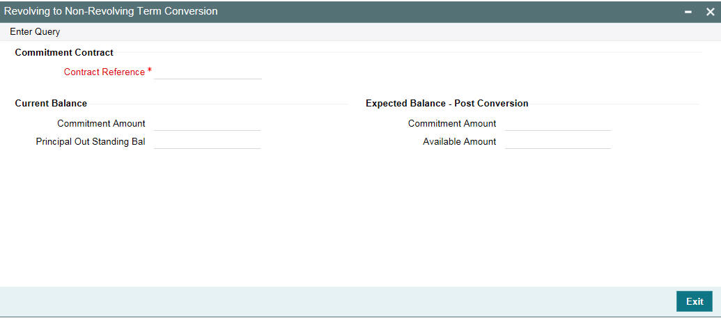

You can convert the existing revolving commitment contract to non revolving commitment (Term commitment) contract using, ’Revolving to Non-Revolving Term Conversion’ screen.
You can change the contract preference from revolving to non-revolving in ’Revolving to Non-Revolving Term Conversion’ screen.
You can invoke the ‘Revolving to Non-Revolving Term Conversion’ screen by typing ‘OLDTMCNV’ in the field at the top right corner of the Application tool bar and clicking the adjoining arrow button.
Contract Reference Number
Specify the contract reference number of the revolving commitment contract which you want to convert to non-revolving commitment contract.
Current Balance
Commitment Amount
The total commitment amount before conversion is displayed in this field.
Available Amount
The total unutilized amount of a commitment contract before conversion is displayed in this field.
Expected Balance – Post Conversion
Commitment Amount
The total commitment amount after conversion is displayed in this field.
Available Amount
The total unutilized amount of a commitment contract after conversion is displayed in this field.
The contract balances are not rebuilt by the system while converting the commitment from Revolving to Non-Revolving. You should handle any balance changes during the conversion or subsequent to conversions by means of Value dated amendments for the respective commitments.

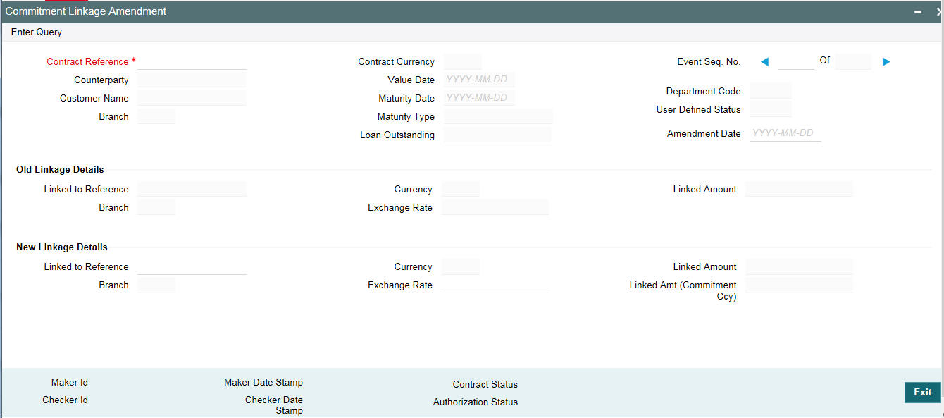

12.4.8 Amending Commitment Linkage Details
A new commitment and an existing commitment can be linked to a loan contract and you can modify the new commitment through the ‘Commitment Linkage Amendment’ screen.
You can invoke the ‘Commitment Linkage Amendment’ screen by typing ‘OLDLNKAM’ in the field at the top right corner of the Application tool bar and clicking the adjoining arrow button.
You can specify the following details:
Contract Ref No
Specify the contract reference number of the contract for which you need to amend the commitment linkage.
Amendment Date
Specify the amendment date of the loan contract.
Old Linkage Details
The system displays the values of old linkage details and you cannot modify these details.
New Linkage Details
Linked to Ref
Specify the reference number of the new commitment which is to be linked. The adjoining option list displays all the commitment reference numbers maintained in the system. You can choose the appropriate one.
Exchange Rate
Specify the exchange rate of the linked amount.
Note
If a contract is pending for authorization in any screen and if you try to unlock in ‘OLDLNKAM’ to do changes, then an error message “Unauthorized amendments exist for contract in ‘function id’ “appears.

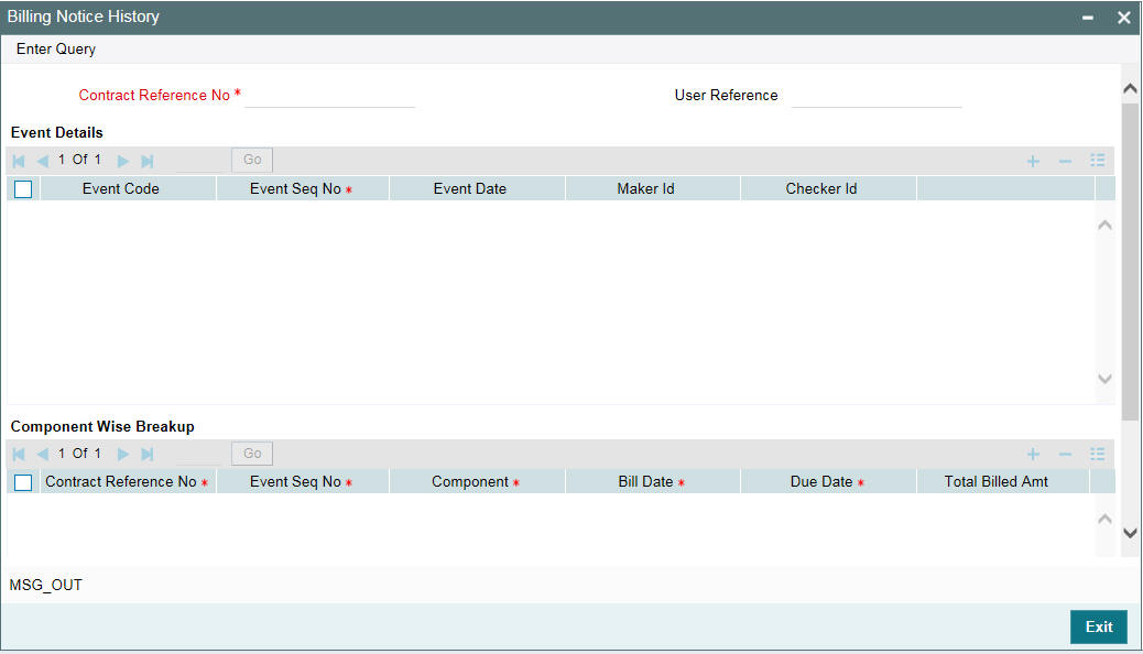

12.5 Viewing Billing Notice History
Oracle Lending facilitates storing the billing notice internally, which is generated as part of NOTC event. You can use this information for reporting activities.
You can view the component wise break up of a contract reference number through the ‘Billing Notice History’ screen.
You can invoke the ‘Billing Notice History’ screen by typing ‘OLDNOTCH’ in the field at the top right corner of the Application tool bar and clicking the adjoining arrow button.
Here you can view the following details about the billing notice, generated as part of NOTC event:
You can view the history of NOTC events generated under a given contract through the ‘View Events’ screen.
For more information about Event Details, refer to ‘Viewing Event details’ section in the User Manual.

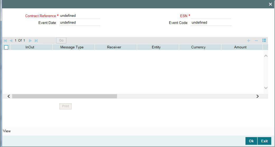

You can view the details of the notice in the ‘Message Details’ screen. To invoke this screen click the ‘Messages’ in the above screen.
Here the system displays the following details of the notice:

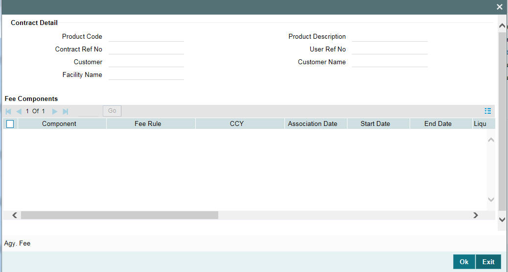

12.6.3 Associating Fee at Contract Level
You can associate the fee by clicking the ’Fee’ in the ‘Loans and Commitment-Contract Input’ screen. The ‘Fee Component’ screen is displayed.
For more information on Contract details, refer to Disbursing a Loan section in this User Manual.
Here, the system defaults the following value from the product:
The system defaults all the other values on the contract value. You are allowed to change the following values:

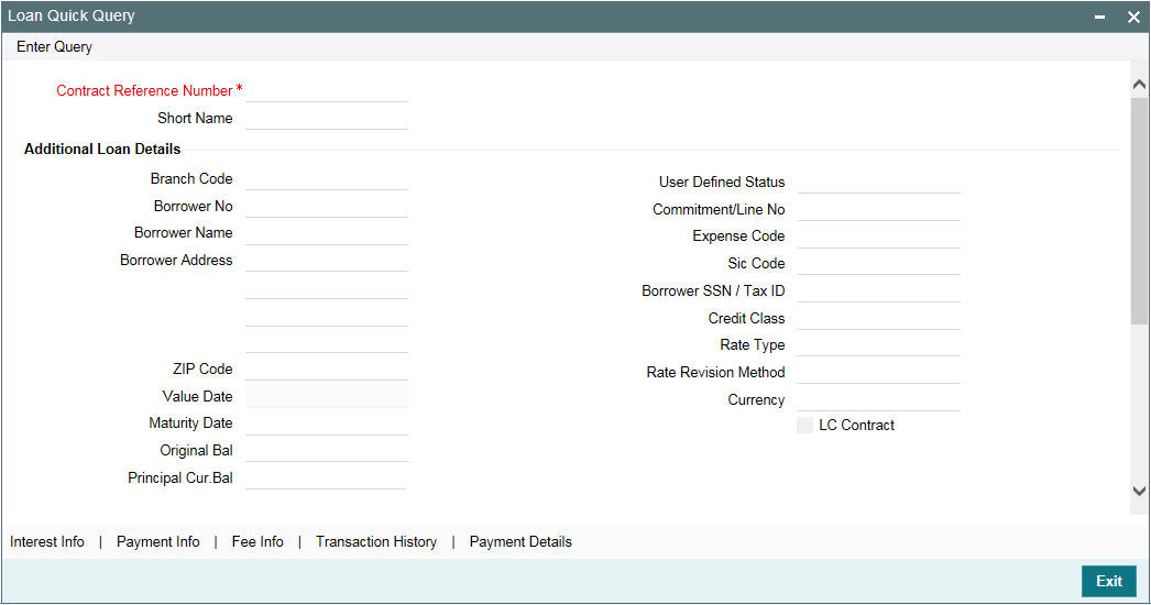

12.7 Viewing Quick Query Details of Loans
You can view the basic details of a loan using ‘Loans Quick Query’ screen.
You can invoke the ‘Loan Quick Query’ screen by typing ‘OLDQCKRD’ in the field at the top right corner of the Application tool bar and clicking the adjoining arrow button.
Specify the reference number of the contract whose details you want to view.

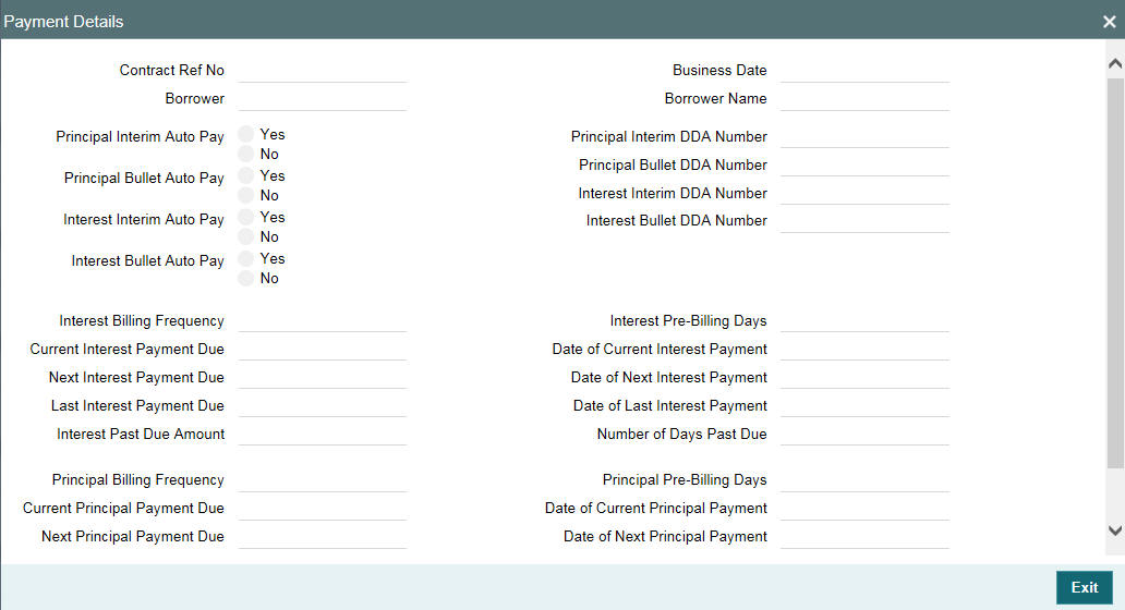

Click ‘Payment Info’ to view the payment Info details of the contract.
You can view the following details in this screen:

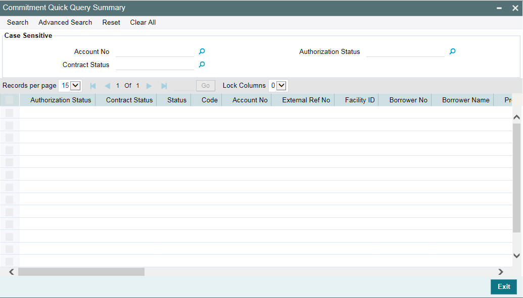

12.7.1 Viewing Loan Quick Reference Summary Details
You can view summary details of Loan Quick Reference in ‘Loan Quick Reference Summary’ screen.
You can invoke the ‘Loan Quick Query Summary’ screen by typing ‘OLSQCKRD’ in the field at the top right corner of the Application tool bar and clicking the adjoining arrow button.

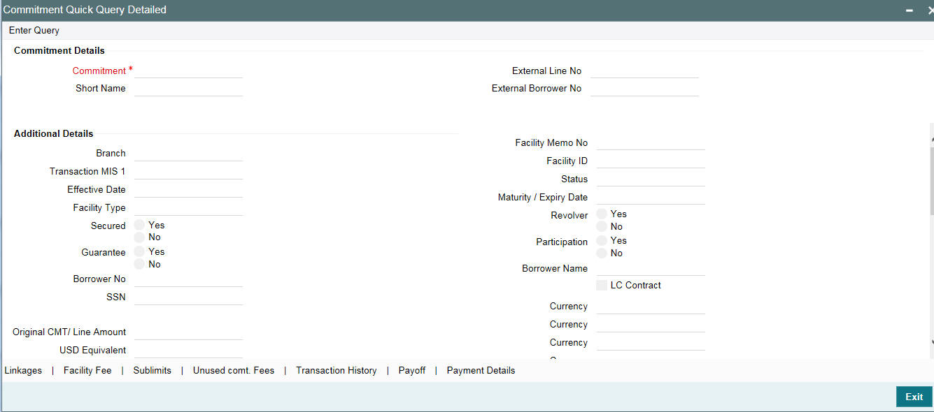

12.8 Viewing Quick Query Details of Commitments
You can view the most viewed details of commitments using ‘Commitment Quick Details’ screen.
You can invoke the ‘Commitment Quick Query Detailed’ screen by typing ‘OLDCLQRY’ in the field at the top right corner of the Application tool bar and clicking the adjoining arrow button.
Commitment/Line Number
Specify the number of the commitment/Line whose details you wish to view.
The following fields are displayed in this screen.
Current YTD
Last Calendar Year
Click ‘Linkages’ to view the Loans/LOCR Linked to the Commitment/Line.
The following details are displayed:

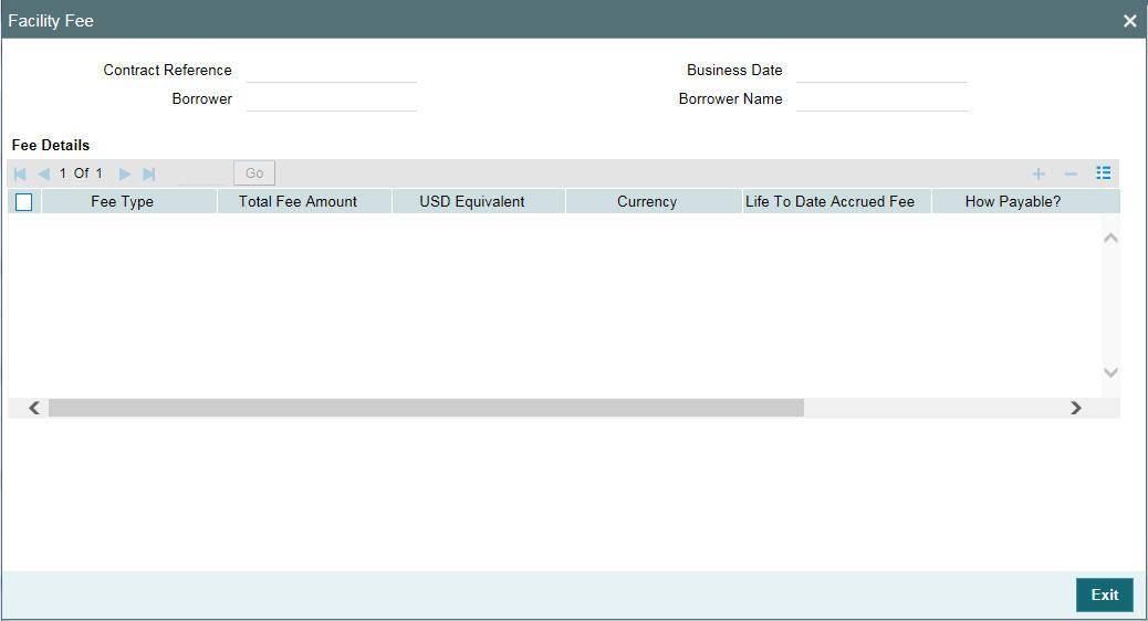

Click ‘Facility Fee’ to view the Facility/Restructuring (FASB/FASC)/Upfront Fee details.

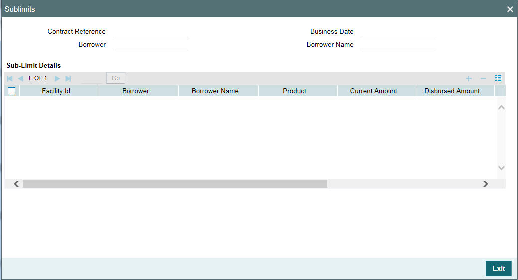

Click ‘Sublimits’ to view the Sublimits details.

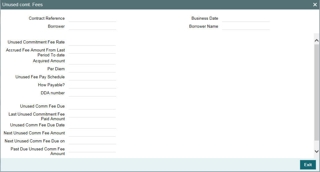

Click ‘Unused comt. Fees’ to view the Unusual Commitment Fee details.

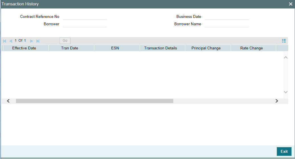

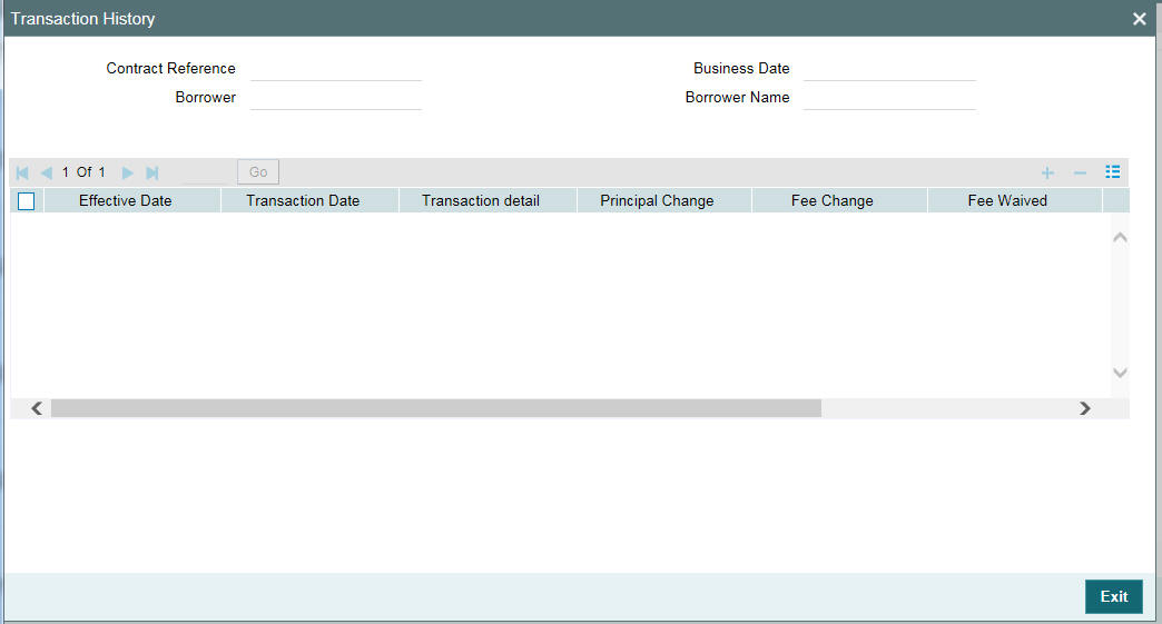

Click ‘Transaction History’ to view the Transaction History details.
