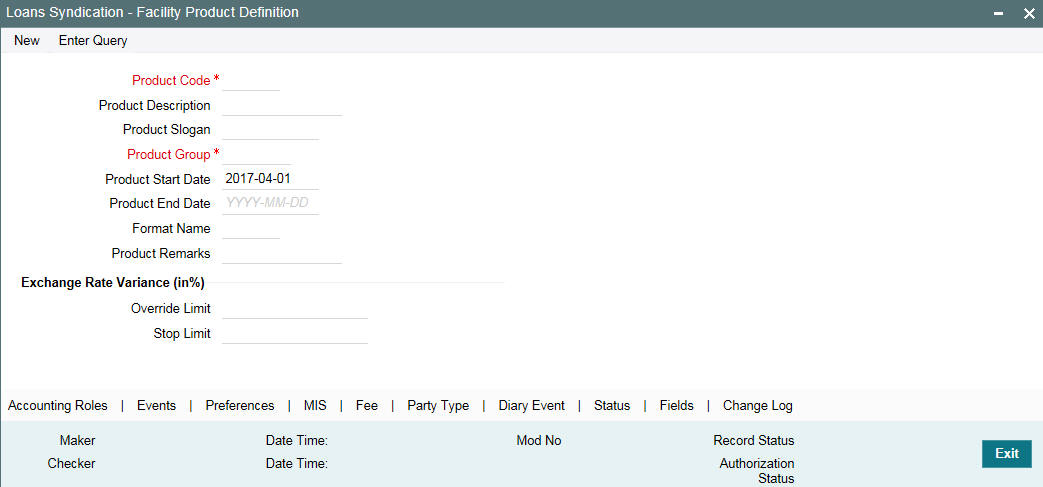

4.2.2 Borrower Facility Product
At the first level, you must define a borrower facility product for borrower facility contracts. The example given below will illustrate this.

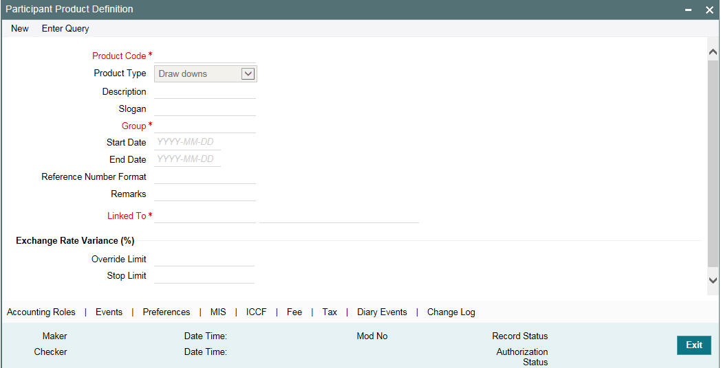

You must also specify the participant product that is used to process participant contracts that are created from borrower facility contracts that use the borrower facility product.
Therefore, it becomes necessary for you to create participant products and borrower tranche and drawdown products before creating borrower facility products.

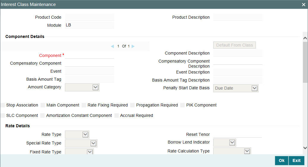

Interest
Maintaining Interest details for a product

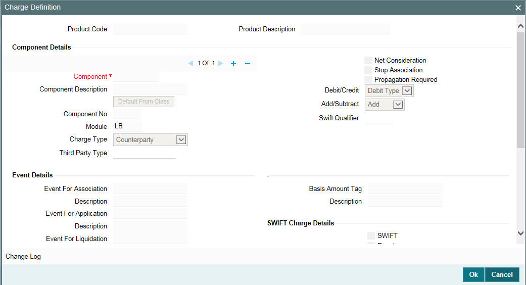

Charges
Maintaining Charge details for a product

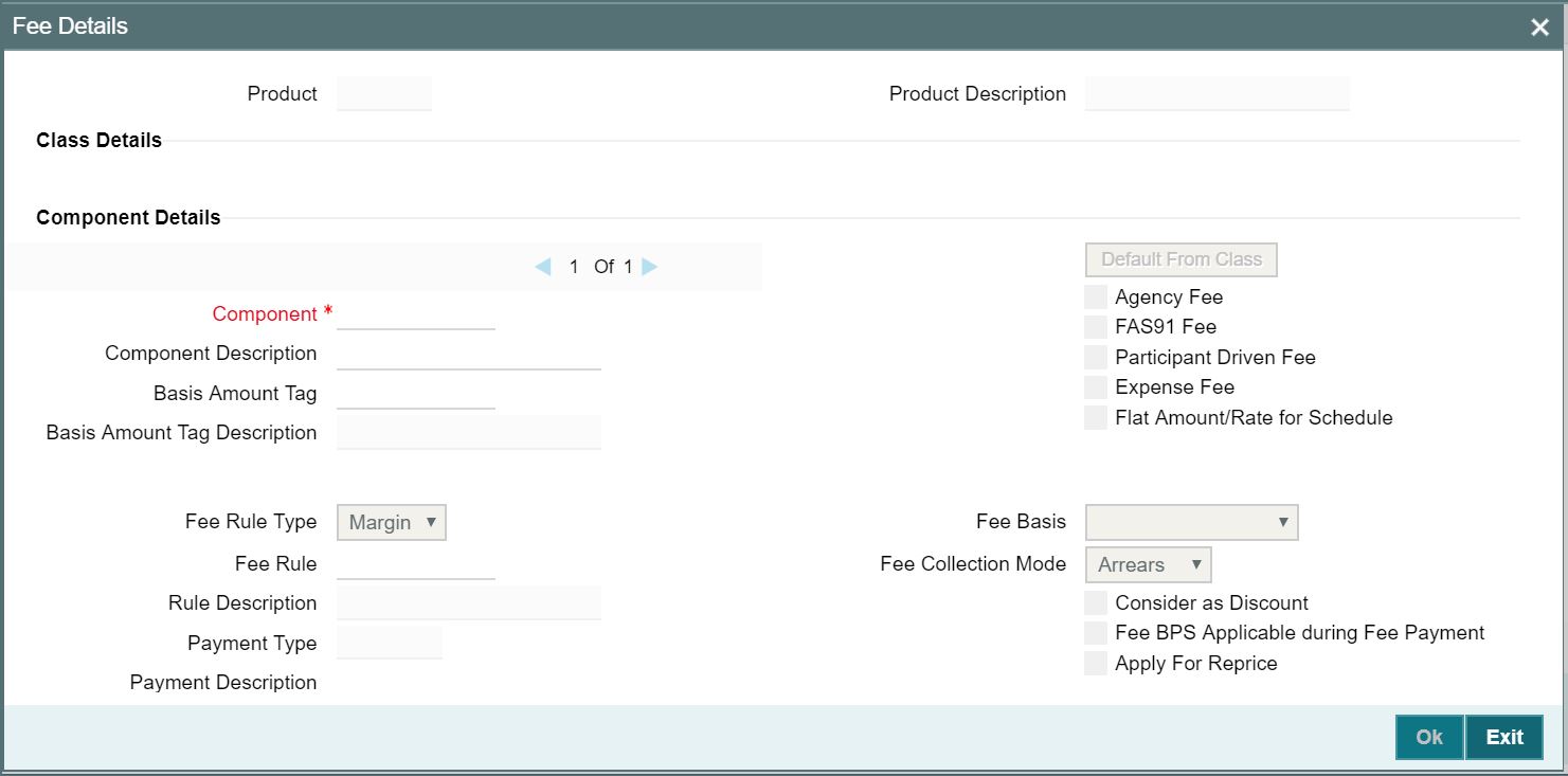

Fee
Specifying fee details for a product

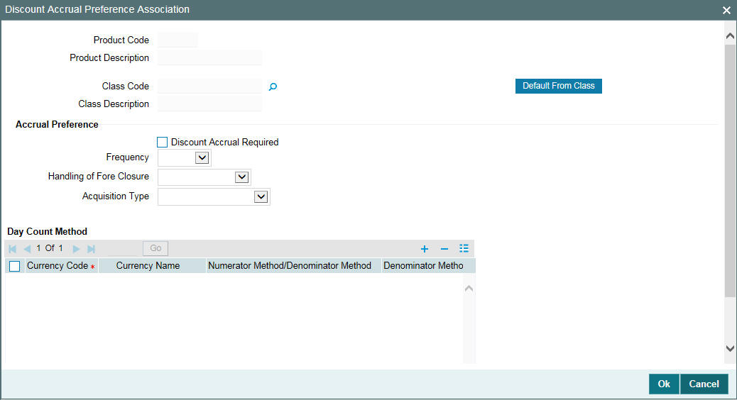

Discount accrual
Specifying discount accrual preferences

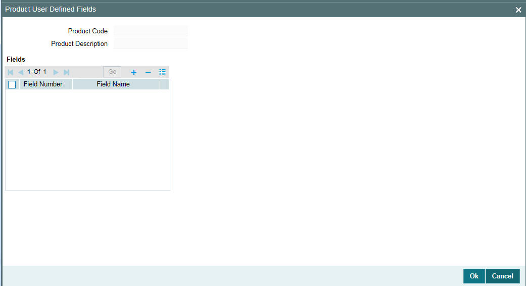

Making User Defined Fields (UDFs) applicable to a product

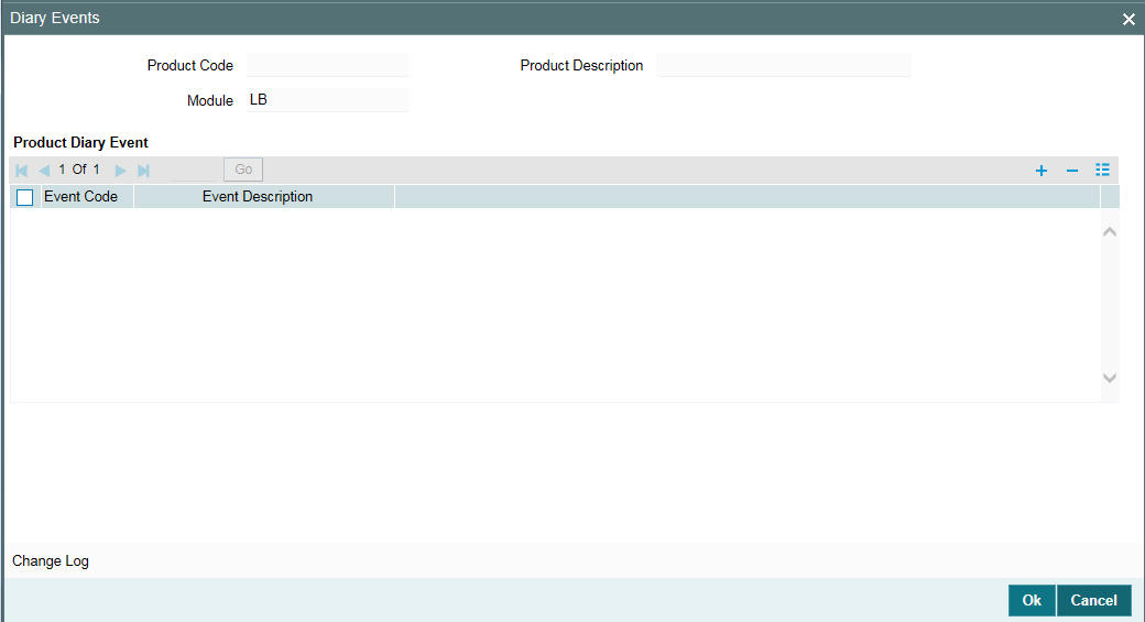

Diary Events
Associating diary events with the product

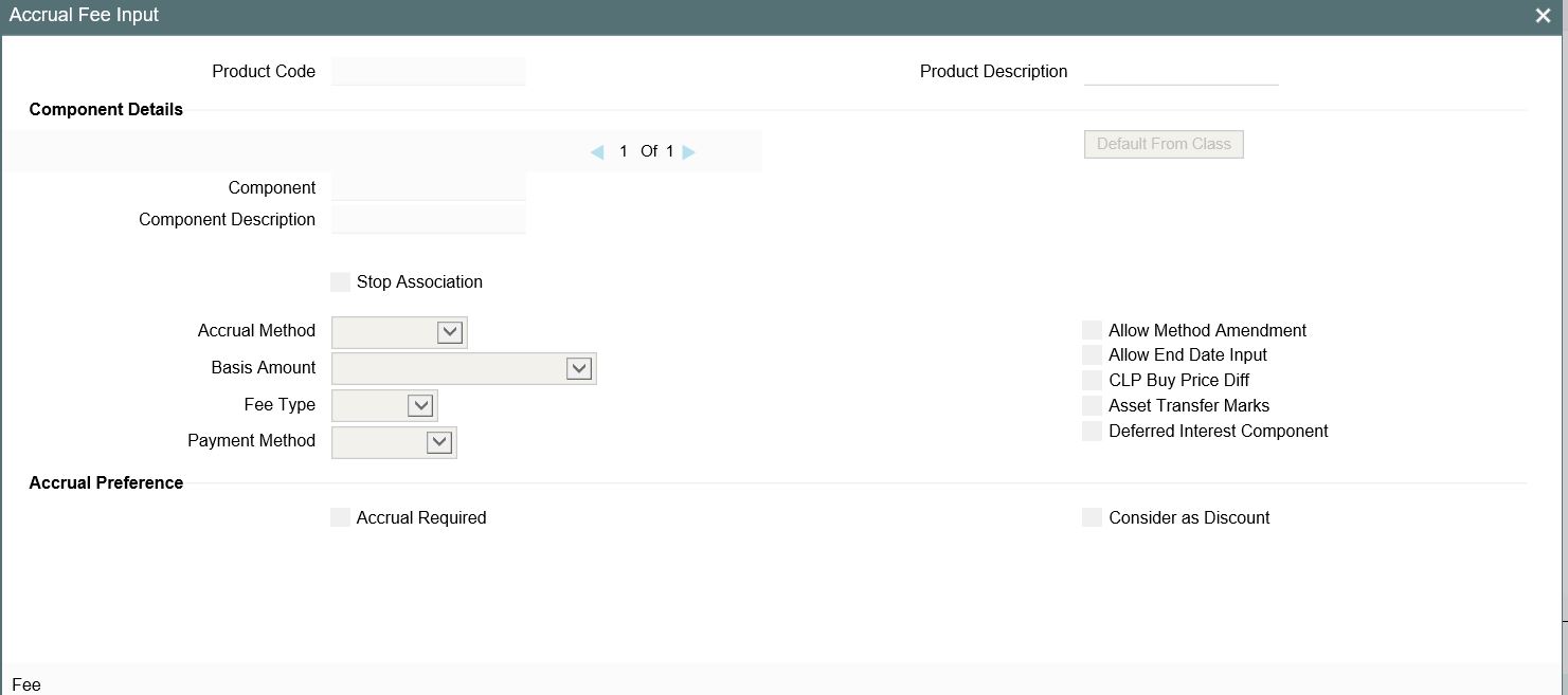

Accrual Fee Details
Maintains accrual fee details for a product.

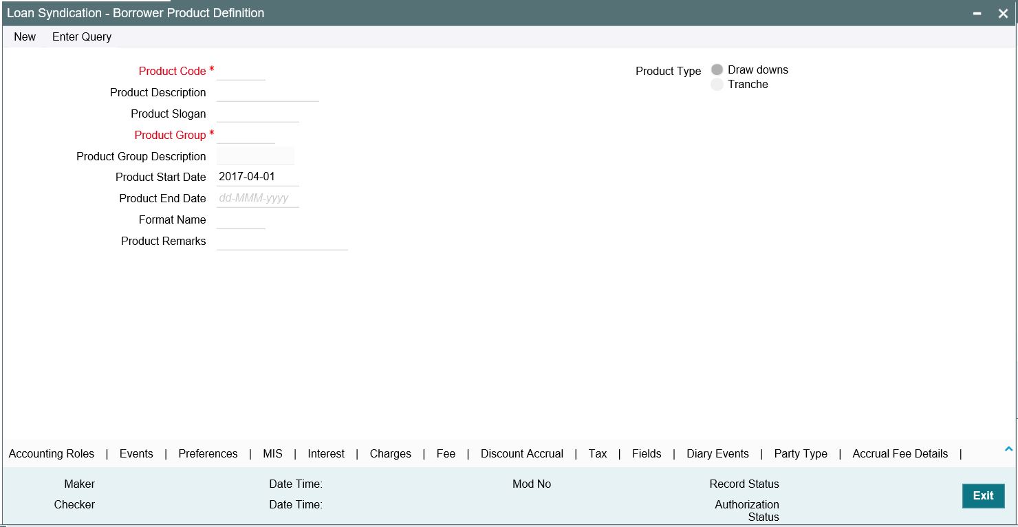

Defining the Borrower Product Type
You can define the generic attributes specific to a borrower tranche/drawdown product in the ‘Loans Syndication – Borrower Product Definition’ screen.
Type
The product type is the first attribute that you specify for a borrower tranche or drawdown product. It indicates the category under which the product can be placed, and the type of contract that will be processed against the product.
Each borrower product that you define could be placed under any of the following categories:

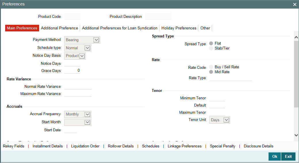

You set up preferences for a borrower tranche/drawdown product in the Loans Syndication – Borrower Product Preferences screen. Invoke this screen by clicking ‘Preferences’ in the ‘Loans Syndication – Borrower Product Definition’ screen.
You set up the general preferences for a borrower tranche or drawdown product in the ‘Loan Syndication – Borrower Product Preferences’ screen in the same manner as you would for a normal commitment product or loans, depending upon the product type you have specified in the ‘Loans Syndication – Borrower Product Definition’ screen.
Refer the Bilateral Loans User Manual for a detailed description.
This section explains about those preferences that you need to set specifically for borrower tranche or drawdown products under a borrower facility contract. Such preferences include the revaluation details, which you can specify in the main LB Product – Preferences screen, and also those pertaining specifically to loan syndication, which you can specify in the ‘Additional Preferences for LB’ screen.

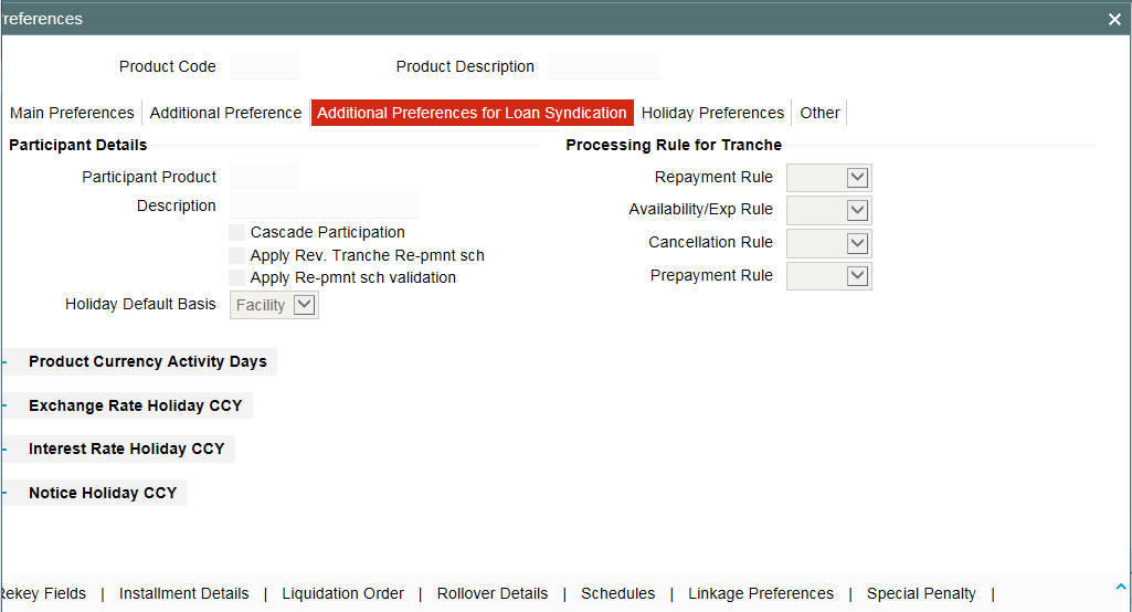

You can specify the following additional details regarding syndication, for borrower tranche or drawdown products, in the ‘Additional Preferences for Loan Syndication’ screen.You can invoke this screen by clicking the ‘ Additional Preferences for Loan Syndication’ button in the ‘LB Product – Preferences’ screen:
Capture the following information in this screen:
Participant Product
For a borrower tranche product, the corresponding participant product to be used for participant borrowing line contracts that are created under the borrower tranche contracts that use the product is displayed in this screen. The linkage is established when you define the participant product.
For a borrower drawdown product, the corresponding participant drawdown to be used for participant drawdown contracts that are created under the borrower drawdown contracts that use the product is displayed in this screen. The linkage is established when you define the participant product.
Cascading Participation
For a borrower tranche product, you can indicate whether any changes to participants in respect of a borrower tranche contract that uses the product, must be propagated to all related active drawdown contracts.
For a borrower drawdown product, you can specify that the participants should be propagated to the contract using the product, by selecting the check box ‘Cascade Participation’. The preference you specify for the product can be changed at the contract level.
Apply Rev. Tranche Re-prmnt sch
Select this check box to indicate that prepayment on the tranche repayment schedule is applicable for revolving tranches. If this check box is selected, then system enables the ‘Tranche Schedules’ button in the ‘Tranche Online’ screen for revolving tranches. If you select this check box for a tranche product having active tranches, then you should define the tranche repayment schedules manually for underlying active tranche contracts.
Note
Apply Re-prmnt validation
Select this check box to indicate that system should validate sum of processed and unprocessed repayment schedule amounts against the transfer availability of the tranche. In addition to this, the following validations are also applicable for the tranche product:
By default, this check box is deselected. You can modify this check box only after product maintenance is authorized.
Holiday Default Basis
For a borrower product, you can indicate whether the holiday treatment (for schedule dates and maturity date) applicable to tranche or drawdown contracts using the product must be defaulted from the parent borrower facility product; or from the borrower tranche or drawdown product.
In the Holiday Default Basis field, select ‘Facility’ to indicate that the holiday treatment specified in the borrower facility product is applicable, or select ‘Product’ to indicate that the holiday treatment from the borrower tranche or drawdown product is applicable.
Specifying the Processing Rule for Tranche
You have to specify the processing rule for the following:
Repayment Rule
Select the repayment rule for the tranche product. You have the following options:
You can change this preference for the contract.
Availability / Exp Rule
Select the expiry rule for the tranche product. You have the following options:
Cancellation Rule
Prepayment Rule
Specifying the Product Currency Activity Days
Ccy
Select the currency for which you are defining preferences.
Exchange Rate Fixing Days and Time
For borrower tranche products, you can specify the number of days before the drawdown date (defined in the drawdown schedule), the exchange rate must be fixed, for contracts wherein the drawdown currency is different from tranche currency.
Indicating Interest Rate Fixing Days
For borrower tranche products, you can specify the number of days before the drawdown date (defined in the drawdown schedule), the interest rate must be fixed. You can specify the applicable number of days for each required currency.
DD Notification Days and Time
For borrower tranche products, you can specify the number of days before the drawdown date that the customer needs to inform the bank of a new drawdown or reset of interest rate.
Exchange Rate Holiday Currency
The holiday preferences of the currency you select here is applied to calculate the exchange rate fixing days or date.
Interest Rate Holiday Currency
The holiday preferences of the currency you select here is applied to calculate the interest rate fixing days or date.
Notice Holiday Currency
The holiday preferences of the currency you select here is applied to calculate the notice rate fixing days or date.
4.3.1.5 Specifying Holiday Preferences for All Schedules
Schedule dates for a contract could fall on holidays defined for your branch or on holidays defined for the currency of the contract. In the Product Preferences, you can specify whether the system should check for schedule dates falling on holidays, and how such schedule dates must be handled. These specifications would default to any borrower facility contract using the product, and also to underlying borrower tranche or drawdown contracts that are opened under the facility contract.
Note
You can change the holiday parameters for schedules through amendment at tranche/drawdown contract online screens, if required. You can specify that:
If you specify that checks must be made, you can also specify the corresponding treatment for schedule dates falling on holidays.
Holiday Treatment Type
The Holiday Treatment Type is the parameter that defines how the system checks for schedule dates falling on holidays. You can specify one of the following options:
Include Branch Holiday
Select this check box to indicate that you want the system to check whether a schedule date falls on a local holiday defined for the branch. You cannot specify a check for currency holidays, if you choose this option.
The system checks the holiday table for your branch. If it encounters a contract entered in your branch, with a schedule date falling on a branch holiday, the holiday is handled according to the holiday-handling preferences you specify.
Use Facility Currency
If you choose this option, the system checks whether the schedule date falls on a holiday defined for the currency of the facility (borrower) contract, if this currency is different from the holiday currency you have indicated.
Use Local Currency
If you choose this option, the system checks whether the schedule date falls on a holiday defined for the local currency, if this currency is different from the holiday currency, facility currency and contract currency you have indicated.
Holiday Ccy
If the system must check whether the schedule date falls on a holiday defined for the currency of the contract, you must specify the code of the holiday currency.
Further, you have the following options to specify the specific currency for which the check must be done:
The system checks the holiday table for the currencies you have specified. If it encounters a contract using any of the specified currencies, with a schedule date falling on a holiday for any of the currencies, the holiday is handled according to the holiday-handling preferences you specify.
Holiday-handling Preferences for Schedule Dates
If you have specified that the system check for schedule dates falling on holidays, you must also specify the treatment for schedule dates encountered by the system that do fall on holidays. The following preferences can be set:
Moving the Schedule Date Backward or Forward
You can indicate whether the schedule date falling on a holiday must be moved forward to the next working day, or backward to the previous one.
Moving Across Months
If you have indicated either forward or backward movement, and the moved schedule date crosses over into a different month, you can indicate whether such movement is allowable; it will be allowable only if you indicate so in the ‘Move Across Months’ field.
Cascading Schedules
If one schedule has been moved backward or forward in view of a holiday, cascading schedules would mean that the other schedules are accordingly shifted. If you do not want to cascade schedules, then only the schedule falling on a holiday is shifted, as specified, and the others remain as they were.
Holiday Processing on Commitment Reduction Schedules
Select the ‘Move Comm Redn Sch’ check box to indicate the holiday processing rule should be applied on commitment schedules. This is applicable only to tranche products.
Holiday Processing on Repayment Schedules
Select the ‘Move Payment Sch’ check box to indicate the holiday processing rule should be applied on repayment schedules. This is applicable only to drawdown products.
Holiday Processing on Interest Rate Revision Schedules
Select the ‘Move Revision Sch’ option to indicate the holiday processing rule should be applied interest rate revision schedules. This is applicable only to drawdown products.
Specifying Holiday Preferences for Maturity and Value Dates
The maturity date for a contract could fall on holidays defined for your branch. In the Product Preferences, you can specify whether the system should check for maturity dates falling on holidays, and how such dates must be handled. These specifications would default to any borrower facility contract using the product, and also to underlying borrower tranche or drawdown contracts that are opened under the facility contract. You can specify that:
The Holiday Treatment Type is the parameter that defines how the system checks for maturity dates falling on holidays. You can specify one of the following options:
Select this check box to indicate that you want the system to check whether a maturity date falls on a local holiday defined for the branch. You will not be able to specify a check for currency holidays, if you choose this option.
The system checks the holiday table for your branch. If it encounters a contract entered in your branch, with a maturity date falling on a branch holiday, the holiday is handled according to the holiday-handling preferences you specify.
Use Facility/Tranche Currency
If you select this check box, the system checks whether the maturity date falls on a holiday defined for the currency of the facility (borrower)/tranche contract, if this currency is different from the holiday currency you have indicated.
Use Local Currency
If you select this check box, the system checks whether the maturity date falls on a holiday defined for the local currency, if this currency is different from the holiday currency, facility currency and contract currency you have indicated.
Holiday Ccy
If the system must check whether the maturity date falls on a holiday defined for the currency of the contract, you must specify the code of the holiday currency. Further, you have the following options to specify the specific currency for which the check must be done:
The system checks the holiday table for the currencies you have specified. If it encounters a contract using any of the specified currencies, with a maturity date falling on a holiday for any of the currencies, the holiday is handled according to the holiday-handling preferences you specify.
Apply Financial Centre Holiday Treatment
This check box allows you to enable financial centre holiday treatment and add the financial centres for the holiday treatment.
For more information about maintaining financial centre for holiday treatment refer to Products User Manual.
Holiday-handling Preferences for Maturity Dates
If you have specified that the system check for maturity dates falling on holidays, you must also specify the treatment for maturity dates encountered by the system that do fall on holidays.
Moving the Maturity Date Backward or Forward
You can indicate whether the maturity date falling on a holiday must be moved forward to the next working day, or backward to the previous one.
Moving across months
If you have indicated either forward or backward movement, and the moved maturity date crosses over into a different month, you can indicate whether such movement is allowable; it is allowable only if you indicate so in the ‘Move Across Months’ field.

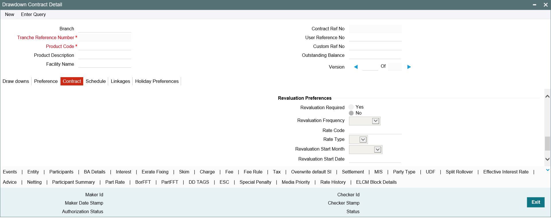

4.3.1.6 Specifying Revaluation Preferences for Drawdown Products
Oracle FLEXCUBE facilitates periodic revaluation of drawdowns based on the preferences you maintain here and this is applicable only if the drawdown currency is different from the tranche currency. The new exchange rate, post revaluation, is used to convert the transaction amount from the drawdown currency into its equivalent in the tranche currency.
You can specify revaluation preferences in the ‘Contract’ tab. The product code and description is displayed in this screen. You can specify the following revaluation preferences:
Reval Reqd
By default, revaluation is applicable for a drawdown product and the option ‘Yes’ is selected. In this case, you have to specify the following additional preferences as mandatory information:
Exchange Rate Code
You must select the code for the exchange rate that must be used to convert the drawdown amount from the drawdown currency to its equivalent in the tranche currency. The option list displays the rate codes maintained in the ‘Currency Rates Maintenance’ screen.
By default, the rate code you select here will be applicable to all drawdowns. At the time of capturing drawdown details, if the drawdown currency is different from the tranche currency and the default ‘Exchange Rate Code’ is not maintained for the currency pair involved, system displays an error message.
Exchange Rate Type
You must also specify the type of exchange rate that must be used to convert the drawdown amount from the drawdown currency to the tranche currency. The options available are:
On the revaluation schedule dates, arrived at abased on the Frequency, Start Month, and Start Day, Oracle FLEXCUBE picks up the exchange rate defined for the selected ‘Exchange Rate Code’ and ‘Exchange Rate Type’ combination, corresponding to the currency pair involved in the conversion, to convert the amount in the drawdown currency into its equivalent in the tranche currency.
Frequency
This refers to the frequency or periodicity of revaluation. The options available are:
Start Month and Start Day
For the frequency you select, you must also specify the month and the date for commencing the revaluation process.
Note
If Reval Required is ‘Yes’ for the drawdown product, the same defaults to all drawdowns processed with the product. You can, however, change the preferences at individual draw­down levels. But, if ‘Reval Required’ is ‘No’ for the product, you cannot change it to ‘Yes’ at the drawdown level and revaluation is not applicable for cross currency drawdowns.
For details on specifying revaluation preferences for a drawdown, refer the heading titled ‘Capturing details in the ‘CONTRACT’ tab’ in the ‘Loan Syndication Contracts’ chapter of this User Manual.

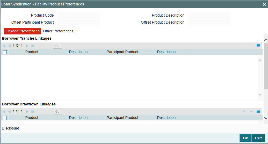

4.3.1.7 Specifying the Linkage Preferences
You can use this tab for ELCM customer and collateral lines linking.

4.3.4 Defining Interest Components for Borrower Tranche/Drawdown Prod­ucts
You must indicate the applicability of interest components, for borrower contracts using the product. You can use the ‘Interest Class Maintenance’ screen for this. Click ‘Interest’ in the Tranche/Drawdown Product Definition screen to invoke the ‘Interest Definition’ screen.
In this screen, you associate interest components in the same manner as you would for a normal commitment or loans product. Only information specific to the LS Module is explained here.
Rate Fixing Required
You can fix the interest rate for a component if you check this option. The system arrives at the Interest rate fixing date for the drawdown currency based on the Interest rate fixing days maintained at the tranche level and the holiday validation currencies specified for the drawdown currency.
Note
Rate fixing is applicable for an interest component with the following attributes:
This is done through the ‘Rate Fixing Details’ sub-screen invoked from the ‘ICCF Details’ screen of the ‘Drawdown Contract Online’ screen.
PIK Component
This value defaults from the associated interest class. You can modify this, if required.
If you select this option, you need to specify the Rate Type as ‘Fixed’ and Fixed Rate Type as ‘User Input’.
Note
For more details on this screen, refer the heading titled ‘Fixing interest rate for the drawdown’ in the ‘Loan Syndication Contracts’ chapter of this User Manual.
Compensatory Component
Specify the name and description of the compensatory component.
Note
SLC Component
Select this field to default schedules for SLC component from the main interest component. The base rate is SLC fee rate and you can modify this rate as part of value dated amendment, if required.
The margin and spread sub components from the main interest components are defaulted to SLC component as well.
Note
Amortization Constant Component
Select this check box to indicate that the component is amortization constant component.
You can select this flag only if the schedule type is ‘Amortization’ and user input installment flag is checked. For main interest component, this flag is checked and disabled for products with schedule type ‘Amortization’ and user input installment flag checked.
For Amortization Constant, along with the Main Interest component and the Principal, the below components are considered:
INS_COMP1 -- Insurance component (Escrow Impounding component)
TAX_COMP1 - Tax component(Escrow Impounding component)
SERVFEE – Servicer Fee – applicable only for Agency (Interest component for Servicer Fee)
ESCROW 3 – An escrow impounding component (Escrow Impounding component)
4.3.4.1 Specifying Billing Notice Preferences
You can specify the following billing preferences for the interest component in this screen:
Billing Notice Required
Select this check box to indicate that you would like to send a billing notice for the interest component.
No of Days
Specify the number of days prior to the billing date that the billing notice needs to be sent.
4.3.4.2 Defining Margin Components
You can also associate margin components with an interest component here. Select the margin component from the option list which contains margin components you have defined through the ‘Margin Definition’ screen. Once you select a margin component, the Description, Margin Basis, and Basis Amount Tag are displayed.
You are allowed to enter a default margin rate if the ‘Margin Basis’ is ‘Drawdown’.
For details about associating interest components for a product, refer the Interest manual. The preferences specific to borrower tranche or drawdown products are explained in this section.
4.3.4.3 Indicating Propagation of Interest Components to Participant Contracts
Interest component classes for specific application to borrower tranche or drawdown contracts can be propagated to participant contracts resulting from the borrower contracts. You can build this preference into interest classes that you define specifically for borrower tranche or drawdown products. During definition of the class, this preference can be indicated, by selecting the Propagation Reqd check box in the ‘Interest Class Maintenance’ screen.
Note
This check box is active only for interest components of the LS module. For all other mod­ules the box is deactivated.
Click the PIK Component check box to indicate that you want to calculate the interest based on the PIK margin.
In the Product ‘Interest Class Maintenance’ screen, when you are associating the interest components for the borrower tranche or drawdown product, you can choose an interest class for which the propagation to participants option has been indicated in the class definition, if required. If so, the Propagation Reqd check box is selected.
You can change this specification and deselect the Propagation Reqd check box, if you want to indicate that interest class propagation to participants is not applicable. Alternatively, if you have chosen an interest class for which propagation to participants has not been indicated, you can select the Propagation Reqd box to indicate propagation of interest class to participants, if required.

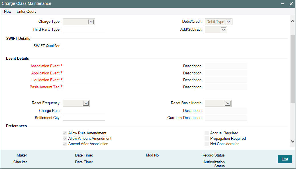

4.3.5 Charge Components for Borrower Tranche/ Drawdown Products
You must indicate the applicability of charge components, for borrower contracts using the product. You can use the ‘Charge Definition‘screen. Click ‘Charges’ in the Tranche / Drawdown Product Definition screen to invoke the ‘Charge Definition’ screen.
In this screen, you associate charge components in the same manner as you would for a normal commitment or loans product.
For details about associating charge components for a product, refer the Charges and Fees manual. The preferences specific to borrower tranche or drawdown products are explained in this section.
4.3.5.1 Indicating Propagation of Charge Components to Participant Contracts
When you collect the charges from the borrower, you can choose to pass the charges to the participants of the tranche or drawdown contract. To indicate this you have to click the ‘Propagation Required’ check box in the ‘Charge Class Maintenance’ screen (LFDCHGCE).
Note
This check box is active only for charge components of the LS module. For all other mod­ules the box is deactivated.
Refer the Charges and Fees manual for further details on this screen.
In the product Charge Definition screen, when you are associating the interest components for the borrower tranche or drawdown product, you can choose a charge class for which the propagation to participants option has been indicated in the class definition, if required. If so, the Propagation Reqd check box is required.
You can change this specification and deselect the Propagation Reqd check box, if you want to indicate that charge class propagation to participants is not applicable. Alternatively, if you have chosen a charge class for which propagation to participants has not been indicated, you can select the Propagation Reqd check box to indicate propagation of charge class to participants, if required.
4.3.6 Specifying Fee Components for a Borrower Product
You must indicate the applicability of fee components for borrower contracts. You can use the Fee Definition screen for this. Click the ‘Fee’ in the ‘Tranche/Drawdown - Product Definition’ screen to invoke the ‘Fee Details’ screen.
The fee is applicable to borrowers only.
You have the option of associating a Fee Class to the components, in which case, the attributes of the class is defaulted to the component. To do the same, click the ‘Default From Class’ button.
The fee details maintained for the fee class in 'Fee Class Maintenance' (LFDFEECL) screen gets defaulted.
System defaults the parameters of the selected fee component. However, you can change the parameters according to your requirements.
In this screen, you associate fee components applicable for the product you are defining. Specify the following in this screen:
Component
Enter the fee component you are maintaining details for.
Description
Enter a description for the fee component.
Basis Amount Tag
When defining fees, you can select the applicable amount tag on which the fee is to be calculated from the option list given.
The following amount tags are available for a Tranche product:
Note
Since issuance fee is not distributed across all the participants, the same is not displayed in the ‘Participant Ratio Details’ screen. The participant who is identified as the issuer of the LC is entitled to 100% of this fee.
The following example illustrates the difference between utilized and unutilized basis amount tags with reference to ‘Revolving’ and ‘Non-Revolving’ tranches:
Example
Non-Revolving Tranche
In the case of a non-revolving tranche, the unutilized amount does not take into consideration the repayments made by the customer under any of the draw-downs under the tranche.
A customer has three draw-downs of USD 100,000 each, under a tranche of USD 500,000 of which:
In this case:
Revolving Tranche
In the case of a revolving tranche, the utilization or non-utilization amount takes into consideration the repayments made by the customer under any of the draw-downs under the tranche.
Considering the same example as above, in this case:
Outstanding amount is : USD 172,500 (DD2-72500; DD3-100,000)
Utilization amount is : USD 172,500
Non-Utilization amount is : USD 327,500 (500,000 – 172,500)
Agency Fee
If, for the fee component that you have selected, you have selected the box ‘Agency Fee’, the income on the component is meant for the leading agent alone. It does not get propagated to the participants.
Note
If you check the box Agency Fee, the box ‘Participant Propagation Required’ is disabled.
FAS91 Fee
Select this check box to perform FAS91 computations. The system validates if:
Participant Driven Fee
If you select this check box, the system allows you to define an individual fee amount for each participant.
Note
Expense Fee
Select this check box to enable the expense fees. The fees can be accrued or amortized.
The expenses may be flat amounts (such as Legal Fee) or rate based on a specific basis amount (such as fee paid to credit guarantor)
These are expenses incurred against a contract which the bank does not directly recover from the borrower. These expenses can be one-time expenses or periodic expenses or paid in advance or in arrears. They may be incurred at the Facility/Tranche/ Drawdown levels.
In expense the fee calculation happens only within the schedule period of the contract whereas in normal arrears the fee calculation happens from the start of the contract till the schedule end date and for advance from the start of the schedule till the end of the maturity date.
For more information refer, to ‘Expense Fee’ section in this User Manual.
Fee Rule Type
Select the Fee Rule Type applicable from the option list. You have the options ICCF and Margin. The rules are applicable depending on the rule type you select.
Fee Rule
Select the rule applicable from the option list given. The option list includes Fee Rules that you have defined in the Fee Rule Maintenance screen.
Fee Basis
The Fee Basis indicates the method in which a given fee schedule amount has to be calculated. The values in the drop-down list are:
For more information on fee basis, refer to Charges and Fees User Manual.
Fee Collection Mode
While defining fees, you can specify whether the fee is to be collected in advance or in arrears.
Payment Type
The system displays the payment type.
Fee BPS Rate Applicable
Select this check box to indicate that BPS rate is applicable to the payment type.
Note
‘Payment Type’ and ‘Fee BPS Rate Applicable’ options are enabled only if ‘Basis Amount Tag’ is ‘USERINPUT’.

4.3.7 Defining Discount Accrual Preference
After building discount accrual fee classes you can associate the class with loans or bills products. Click the ‘Discount Accrual’ in the Product Definition screen. The ‘Discount Accrual Preference Association’ screen is displayed.
To associate discount accrual fee class with a product, click the ‘Default From Class’ in the Discount Accrual Preference Association screen. Select the appropriate discount accrual fee class from the list of classes that you would have maintained through the Discount Accrual Preference Class Maintenance.
For further information on the Discount Accrual Preference Class Maintenance screen, refer to the chapter ‘Defining Discount Accrual Fee Classes’ in the Bilateral Loans User Manual.
The attributes defined for the discount accrual fee class defaults to the product. You have the option to modify the attributes defined for the class, to suit the requirement of the product you are creating.
Alternatively, you can choose to define the discount accrual details for the product.
Note

4.3.9 Associating Diary Events
In the Diary Event Association screen, you can also specify the different diary events that would need to be processed for borrower tranche or drawdown contracts using the borrower tranche or drawdown product. Click ‘Diary Events’ in the Tranche / Drawdown Product Definition screen to invoke the ‘Diary Events’ screen.
In this screen, select the code of the diary event that you want to associate with the product, in the Event Code field.
4.3.10 Maintaining UDFs
You can maintain the UDFs pertaining to the loan using the ‘Product User Defined Fields’ screen. To invoke this screen, click the ‘Fields’ on the Application toolbar of the ‘Loan Syndication -Borrower Product Definition’ screen.
In this screen, you can maintain the UDF ‘PAYOFF-FEE’ attached to tranche/drawdown products which is used to determine the flat fee amount.
4.3.11 Specifying Accrual Fee Details
You can maintain accrual fee details for a product. These values get defaulted to ‘Amortization Fee Details’ (LFDACFIN) screen.
4.4 Creating Borrower Facility Products
After you have created products to process borrower side contracts in respect of a syndication agreement, such as borrower tranches and drawdowns, as well as products for participant side contracts, you must define products that would be used to process the main syndication agreement (facility) contract with the borrower. Such products are called borrower facility products.
To create a borrower facility product, you can specify the basic details such as the Product Code, Group, Description, and so on in the Loan Syndication – Facility Product Definition screen. You can then use the other product definition screens to set up preferences for the product.
You can invoke the ‘Loan Syndication - Facility Product Definition’ screen by typing ‘FCDPRMNT’ in the field at the top right corner of the Application tool bar and clicking the adjoining arrow button.
You can specify the basic details for the product, such as the Product Code, Description, Group and life-span, in the same manner as you specified for the tranche/drawdown product.
4.4.1 Defining Generic Attributes of a Loan Syndication Product
After specifying all the basic details of a product, you can indicate certain specific attributes for the product. Each of these attributes can be defined in the corresponding screen that you can invoke from the Loan Syndication Product Definition main screen, by clicking the appropriate icons. Attributes with common characteristics are grouped together in common screens, simplifying the process of defining them.
For a borrower facility product, in addition to generic attributes, you can specifically define other attributes. These attributes are discussed in detail in the following sections.
For further information on the generic attributes that you can define for a product, please refer the following Oracle FLEXCUBE User Manuals:
4.5 Creating Participant Products
You can create participant products only after you have defined the borrower products (for processing borrower facility, tranche and drawdown contracts).
Subsequently, when you define a borrower facility product for processing borrower facility contracts, you have to associate the borrower tranche product and the borrower drawdown product participant tranche product and the participant drawdown product to be used for processing the corresponding participant contracts that would be created under the borrower facility contracts.
You must define the products to be used for participant facility, tranche and drawdown contracts that will be created for participants under a borrower facility contract. This can be done through the Product – Creation screen.

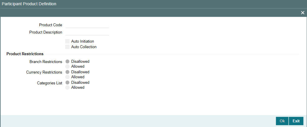

You can invoke the ‘Participant Product Definition’ screen by typing ‘LPDPRMNT’ in the field at the top right corner of the Application tool bar and clicking the adjoining arrow button.
Click ‘New’ to create participants products. In the ‘Product – Creation’, you have to specify the following details:
Participant Product Type
Select the product type of the participant product you are creating, from the option list. The options available are:
Linked Borrower Product
Select the borrower product with which you to want to link the participant product being created.
New Product Code
Give the participant product a unique code by which it can be easily identified. The code can be combination of alphabets and numbers and should consist of at least one alphabet.
Click ‘Ok’ to proceed with product creation. The ‘Loans Syndication – Participant Product Definition’ screen is displayed.
4.5.1 Defining Generic Attributes of a Participant Product
After specifying all the basic details of a participant product, you can indicate certain specific attributes for the product. Each of these attributes can be defined in the corresponding screen that you can invoke from the Loan Syndication – Participant Product Definition main screen, by clicking the appropriate icons. Attributes with common characteristics are grouped together in common screens, simplifying the process of defining them.
For a participant product, in addition to generic attributes, you can specifically define other attributes. These attributes are discussed in detail in this section.
For further information on the generic attributes that you can define for a product, refer the following Oracle FLEXCUBE User Manuals:

4.5.3 Setting Preferences for Participant Products
Preferences are those options you can use to specify attributes for a product. These attributes are picked up and applied automatically to any contracts involving the product.
For instance, for participant contracts using a participant facility product, you can define whether collection from the participants towards a drawdown must be initiated automatically; or whether the amount repaid by the borrower must be disbursed automatically to participants.
Click ‘Preferences’ to specify certain preferences unique to the product. The ‘Loans Syndication - Participant Product Preferences’ screen is invoked, where you can specify your preferences.
You can capture the following information in this screen:
Auto Initiation
You can indicate whether collection from the participants towards a borrower drawdown must be initiated automatically. Your specification is inherited by all participant contracts using the participant product.
Auto Collection
You can indicate whether the amount repaid by the borrower must be disbursed automatically to the respective participants. Your specification is inherited by all participant contracts using this product.
Note
Product Restrictions
When you create a product, you can provide product restrictions. That is, you can specify the branches of your bank that can offer this product, the currencies that are allowed or disallowed and the customers who can avail the product.
You can set preferences as ’Allowed/Disallowed’ in this screen and the same is defaulted to 'Bilateral Loan and Commitment Restrictions' screen.

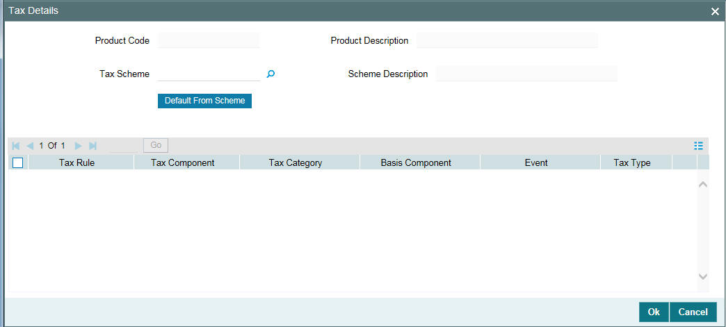

Specifying Tax Details
You can click ‘Tax’ option to tax components with a product. The ‘Loan Syndication - Facility Product Definition (FCDPRMNT) is used for a facility product, whereas Loan Syndication - Borrower Product Definition (LBDPRMNT) is used for both tranche and drawdown product.
Specify the following details in this screen:
Tax Scheme
A tax scheme can consist of a set of tax rules that can be applied to a product.
A tax scheme is made applicable to a product when it is linked to the product. Select the applicable scheme from the list. The tax schemes maintained through the ‘Tax Scheme Maintenance’ screen are available in the option list provided.
When you select a scheme, the following defaults:
The tax scheme linked is applicable on a contract processed under the product by default. However, you have the option of waiving the application of tax, for a specific contract.
Tax Rule
A tax rule represents the method in which a specific tax has to be applied. Thus, for a tax component to be levied on a contract, you should specify:
In addition, you can also specify the minimum and maximum amount of tax that can be applied for a specific rule.
Tax Category
You can specify tax category for each tax rule that is linked to a tax scheme. The categories defined through the ‘Tax Category Maintenance’ are available in the option list provided. Select the appropriate one from this list.
Basis Component
Tax can be applied on the basis of any component that is taxable according to the laws in your country. This component is called the Basis Component. The method of tax application defined for the Tax Rule is applied on this component.
Event
You should specify the event upon which the tax is to be applied. For instance, if you specify that the tax be to be applied at the time the fess is collected from the customer, then the entries for tax are passed when the fee component is liquidated.
Tax Type
The type of tax, decides the bearer of the tax. It could be the bank or the customer. A customer bears withholding type of tax and the tax component is debited to the customer’s account. The bank bears an expense type of tax and the tax component is booked to a tax expense account.
Note

4.6 Specifying Preferences for Syndication Products
Preferences are those options you can use to specify attributes for a product. These attributes are picked up and applied automatically to any contracts involving the product. For instance, for contracts under a borrower facility syndication product, you can define when intimation must be sent to participants to fulfill their commitments towards a scheduled drawdown.
Click ‘Preferences’ to specify certain preferences unique to the product. The Borrower Facility Product - Preferences (FCDPRMNT) screen is invoked, where you can specify your preferences.
4.6.1 Mapping Products for Borrower and Participant Contracts
You can associate several tranche products to a facility product. To each of the tranche products, you can associate several drawdown products. Each time you initiate a borrower tranche or drawdown contract under the Facility contract, you have the option of selecting one of the tranche or drawdown products you have associated with the facility product under which you have booked a contract. The system then defaults the attributes of the product to the contract.
Note
This feature allows you to associate any LC product (which can be treated like a draw­down product) with other drawdown products under a tranche. The participant product that is linked to the borrower facility product while defining the participant product is displayed as the ‘Offset Participant Product’.
Example
Let us assume that you are maintaining a borrower facility product called SYN2. You have associated the following products with this product:
Tranche Products
Drawdown products
You are initiating a borrower tranche contract under a main syndication contract involving the syndication product SYN2. Automatically, the system defaults the product codes and attributes of:
Similarly, the product codes and attributes of BD02 and PT02 are defaulted for the corresponding drawdown contracts under each tranche.

4.6.4.2 Holiday-handling Preferences for Schedule Dates
Cascading Schedules
4.6.5 Specifying How Maturity Dates Falling on Holidays must be Handled

4.6.5.3 Product Restrictions
4.6.6 Associating Appropriate Party Types for Borrower Facility Products
You can also specify the different types of entities or parties that would be applicable for the borrower facility product in the Party Association screen. Click ‘Party Type’ in the Facility Product Definition screen to invoke the Party Association screen.
For each party type that you associate in this screen, you can specify:
4.6.7 Associating Diary Events for Borrower Facility Products
In the Diary Event Association screen, you can also specify the different diary events that would need to be processed for borrower facility contracts using the borrower facility product.
Click ’Diary Event’ in the Facility Product Definition screen to invoke the Diary Event Association screen.
