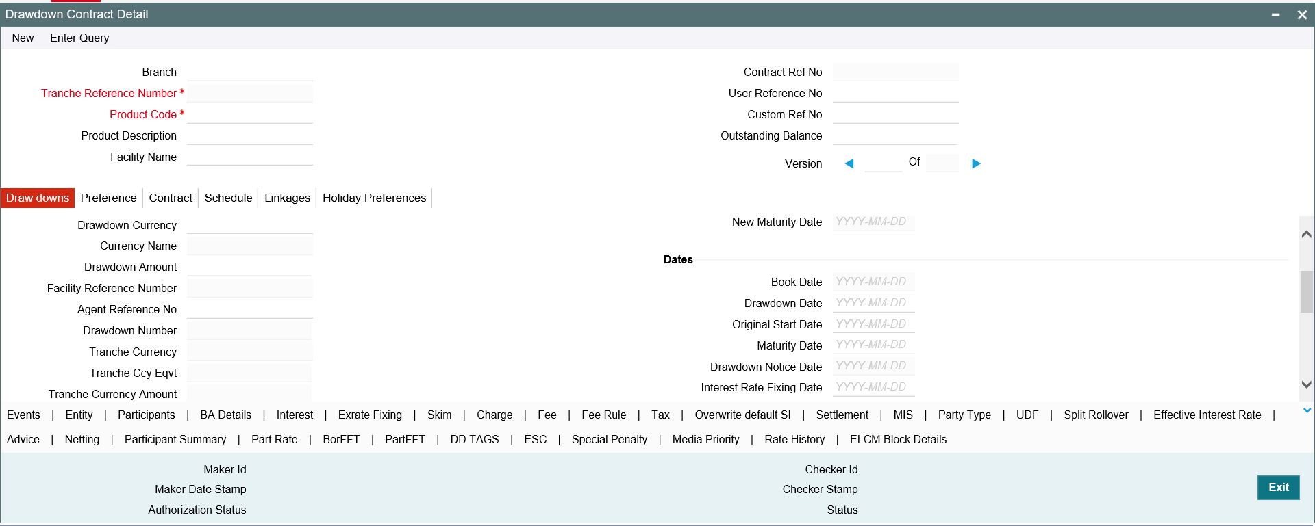

7.3 Defining Drawdown for a Contract
You can capture Drawdown contract details in the in the ‘DRAWDOWN’ tab of the ‘Drawdown Contract Online’ screen.
You can invoke the ‘Drawdown Contract Online’ screen by typing ‘LBDDDONL’ in the field at the top right corner of the Application tool bar and clicking the adjoining arrow button.
Special Amount
Specify the special amount for swing line draw down, in case you want to do a special swing line disbursement.
Note
The value of the special amount can be positive or negative or it can be zero.

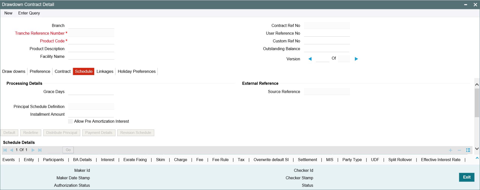

7.4 Defining Schedules for a Contract
The repayment schedules that you define for a drawdown loan product applies to all drawdown contracts involving the product. When you are entering a drawdown in the ‘Drawdown Contract Online’ screen, the schedules defined for the product involving the drawdown are displayed in the ‘Schedules’ tab of the screen.
You can change the attributes of the schedule for an individual drawdown that it inherits from the drawdown product.
The schedule payment type that is defined for a drawdown product (Amortized, Capitalized, or Normal) is inherited by all drawdowns involving it. This attribute cannot be changed when you enter a drawdown.
The manner in which you specify the attributes for repayment schedules for a drawdown is the same as for a normal loan contract.
Distribute Principal
You can distribute the outstanding principal evenly across all the schedules. This can be used for a new contract and contract amendment.
Redefinition
As part contract amendment, 'Schedules Details' section gets enabled for modification.
For a detailed description, refer to the chapter ‘Processing Repayments’ in the Loans User Manual.
Only those aspects of specifying attributes for repayment schedules that are specific to borrower tranche or drawdown contracts are explained in this chapter.

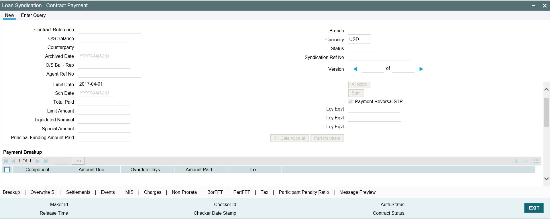

You process payments through the ‘Contract Payment’ screen.
You can invoke the ‘Loan Syndication - Contract Payment’ screen by typing ‘LBDPYMNT’ in the field at the top right corner of the Application tool bar and clicking the adjoining arrow button.
The manner in which you perform manual liquidation for a drawdown in the ‘Contract Payment’ screen is the same as for a normal loan contract.
Special Amount
Specify the special amount in case you want to do a special payment or to facilitate the special amount disbursal. The value of the special amount can be positive or negative or it can be zero. You are allowed to make special payment even for future value dated payments.
Note
Principal Funding Amount paid
Specify the principal (funded) amount to be liquidated.
Based on this amount and the total funded amount for the contract, the system arrives at the actual amount to be liquidated. This actual amount is used for the subsequent payment processing.

After specifying the Limit Date and Value Date, click ‘Pop till Dt Accrual’ and the following details get displayed. The system displays the interest amount accrued till the least of value date and limit date in the ‘Amount Due’ column. Only main interest component is displayed in the ‘Payment Breakup’ screen.
Note
Principal and non main interest components cannot be paid along with main interest com­ponent when this button is pressed. You can specify the borrower ‘Amount Paid’ which can be lesser than or equal to the ‘Amount Due’.

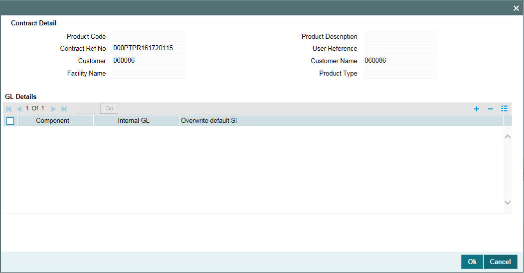

7.5.3 Capturing Overwrite Settlement Instructions
You can maintain settlement instructions for various components such as fees, charges, tax, principal, interest, and so on, using the ‘Overwrite Settlement Instruction Details’ screen. Using this screen, you can post liquidation entries into an Internal GL account instead of the customer account at the time of rollover. Click ‘Overwrite SI’ in the ‘Loan Syndication - Contract Payment’ screen to invoke the following:
Component
This screen displays the all the components displayed in the Settlement Message Details screen that is, fees, charges, principal, interest, and so on.
Internal GL
Specify the Internal GL accounts into which you want to post the liquidation entries for the components.
Overwrite Default Settlement Instruction
Select the ‘Overwrite default settlement instruction’ box to confirm that the liquidation entries should be posted into the Internal GL account. System posts the entries to the Internal GLs only if you check this box. Otherwise, the system posts the entries as per the settlement instructions specified for the component of the contract.
Note
You can maintain the Internal GL account anytime during the life cycle of the contract.
7.5.4 Processing Non-Prorata Payments
The system also allows you to process non-prorata payments on the maturity date of the drawdown if the drawdown is not a ‘Prime’ loan. In the ‘Contract Payment’ screen, click ‘NonProrata’ button to invoke the ‘Participant Ratio Details’ screen.
In this screen, you can maintain the following details:
For existing participants, system displays the displays the settlement details for all currencies maintained at the tranche level. Note that you cannot modify these details.
Note
If ‘Propagate Ratio to Drawdown’ box is checked, then on save of the tranche amendment, system triggers the VAMI event at the tranche contract level. In addition, system increases the tranche amount and updates the new asset ratio at the tranche contract. System trig­gers the PRAM event at the underlying drawdown contracts for propagating the new asset ratio.
To select the participants for processing the payment, click ‘Participant Selection’ button in the above screen. In the ‘Participant Selection’ screen that is displayed, the names of all the participants of the drawdown are listed. Select the participants you want to include for payment processing. Click ‘Ok’ button to save the details and return to the ‘Participant Ratio Details’ screen. The system displays the selected participants’ names and the relative payment distribution ratio (in the ‘Component Ratio’ field of the screen) arrived at based on the asset sharing ratio of each participant. You cannot amend the ratio that is displayed here.
Click ‘Ok’ button to return to the ‘Contract Payment’ screen. In this screen, you have to specify the ‘Amount Paid’ which is distributed amongst the selected participants as per the relative distribution ratio.
When you save a non-pro rata payment for a drawdown under a pro-rata type of tranche (the ‘Cascade Participation’ box is selected in the ‘LS Tranche Contract Online’ screen), the system converts the tranche into a non-pro rata type (the ‘Cascade Participation’ option is unchecked). The system also recalculates the asset ratio for the drawdown.
For information on non-prorata rollover, refer the section titled ‘Processing Non-Prorata Rollovers’ in the ‘Rolling over a drawdown’ chapter of this User Manual.
Note
Oracle FLEXCUBE does not allow participants to contribute an amount more than the as­set amount maintained at the tranche level.
Refer the chapter ‘Loans Syndication Contracts’ in this manual for more information on computing Participant Ratio based on non pro-rata basis.
For a detailed description on processing manual repayments, refer to the chapter ‘Processing Repayments’ in the Loans User Manual.
